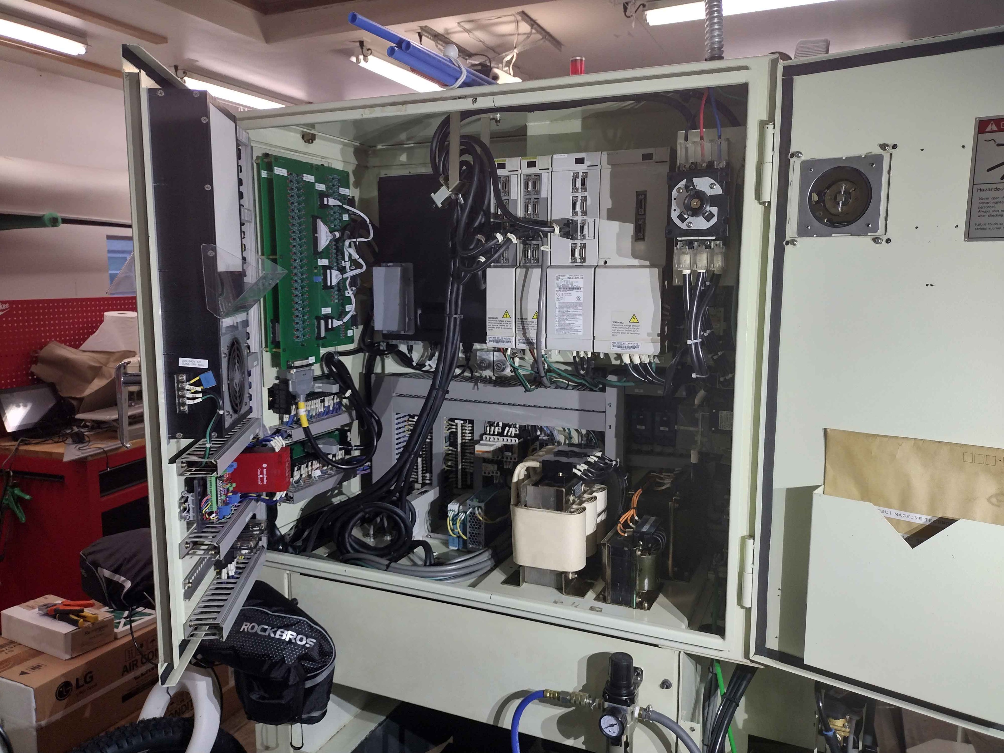

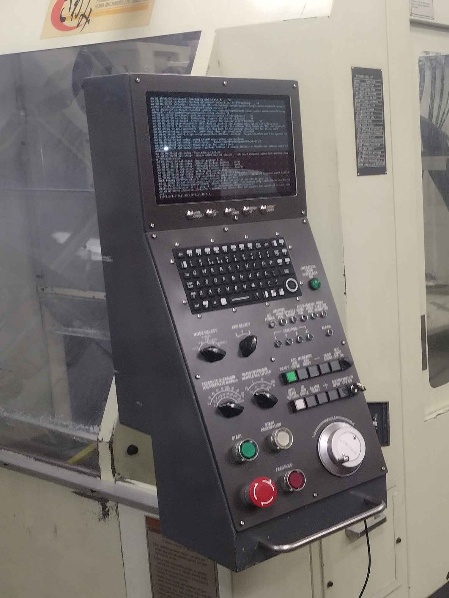

I am converting a Howa VMC with jig changer from a Mitsu Meldas 500 control to LinuxCNC, using the existing IO hardware and a Yurtaev Interface Adapter for LinuxCNC to control 7 Mitsibishi MDS servos. Am currently finishing up wiring and hardware testing before I get into programming. I have fabricated custom optoisolated I/O boards to interface between the PC and Machine (5 vdc to 24 vdc conversion). I am using one MESA 6124 PCIe board for inputs. No issues there.
I have a second 6124 PCIe board set up for output. Outputs are setup as sourcing on the PC side, to drive outputs that are all 24 vdc sourcing on the machine (because that's the Meldas 500 control was wired.). I find on power-up of the PC that the all of my indicator LEDS on the machine side (24 VDC) light up, as do the indicator LEDS of machine relays and indicator relays on the machine control panel. Indicator relays on the PC side of the optoisolator board do not illuminate. Baffled me until I realized the MESA 6124 pulls up by default on power-up. The minuscule amount of current at each pin is not enough to activate the indicator LEDs on the PC side, but just enough to allow optos trigger output on the Machine side .
I am looking for advice on the best way to keep the output pins low until the MESA card is configured. A timer interval (via Arduino or timer relay) after the PC boots before 24 vdc is allowed to the machine side of the output IO board? Monitor MESA I/) pin voltage until all outputs drop from high to low after power up and initial board configuration before allowing power to machines side of I/O board? Other ideas?

I went through the existing safety relay and power-up hardware and put together a schematic. 24 VDC supply to safety and power-up relays coils is provided when the VMC main contactor is engaged. What I will call 'Safe' 24VDC to the old IO was (is) enabled via this circuit when the operator key switch at the control console is turned on. This also powered up the old Meldas 500 control, with it's own IO cards.

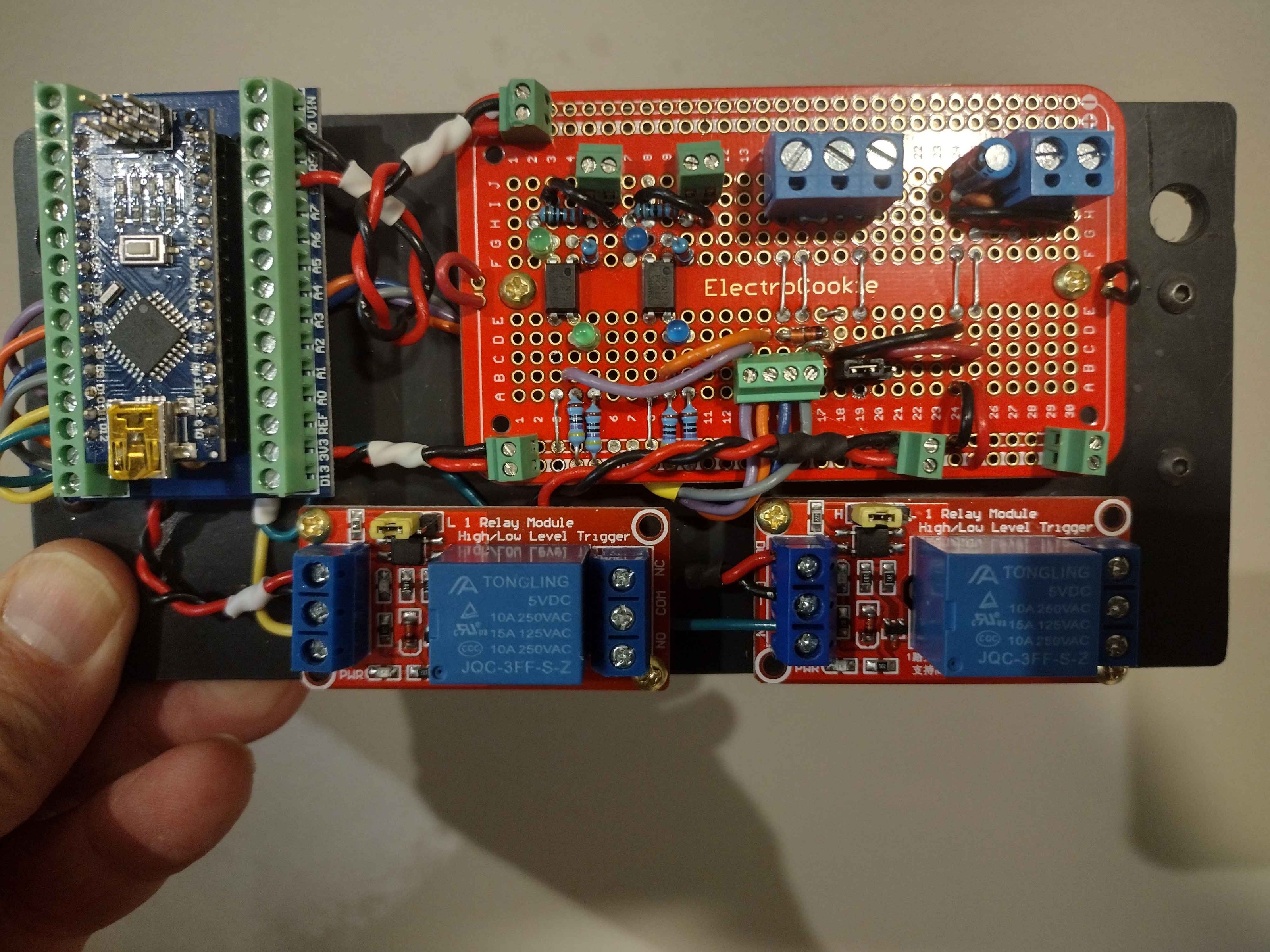

I've attached a pic of the new control cabinet, with the HP box running Linux CNC and my own optoisolated IO boards (green PCB's, upper left). Two PCIe MESA 6124 boards for IO and the Yurtaev PCI Bootup and shutdown of the HP PC doesn't play well with the simple key switch power on-off for the Meldas CPU. I also had to add a separate switched 12VDC supply for handwheel encoder and the new mini touchscreen. The red proto board with the Arduino Nano controls PC power up and power down by monitoring the power and HD LED states and activating the PC power pushbutton as required. The 5VDC relay units on that board control the PC pushbutton and enable 'Safe' 12VDC to the monitor and handwheel.
Seems like the best bet will be to add another relay to that board to switch 24VDC to the machine side of my optoisolated output board when LinuxCNC is up and running. I don't think I have any concerns with active inputs being engaged as soon a the MESA board receives power. It's the outputs that worry me.

tommylight - for sure, not trivial. Since I already have an Arduino controlling power on/off to the PC, I think the way forward is to keep power off the 24 VDC to machine side of my optoisolation boards, send a command to LinuxCNC to pull an unused output pin at the MESA 6124 board low, and wait for the that state change to power up the machine side of the outputs. The Arduino would continually monitor the state of that 1 MESA pin and do whatever needed to be done if something 'bad' happened while LinuxCNC was in charge. Sound reasonable?

That should work, if you are using only 6i24.
