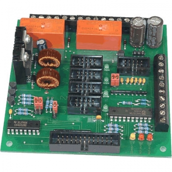

Search for help with an older Interface was created by RRici

Looks like a BOB, with some voltage regulators and relays, so first thing to find is where does power go.

on this page there is such a device:

Quick Google translate:
Connection: 4 reference switches 2 kill switches are supported 2 relays, each with two 8A changeover contacts the 4 axis can run synchronron with another X axis (is set via jumper) Supply voltage 24 - 48 V (only one power supply is required) Outputs 12 and 5 V Cable up to the parallel port of the PC included in the offer
