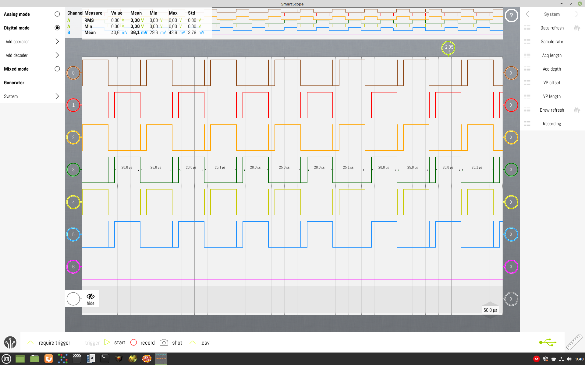

Since I don't lack time, I started testing an eight-pole fanuc motor with a bare h bridge that I just mounted. i'm trying with a 7i43h with 3pwmgens and bldc and the signals come out from A B C /A /B /C and the servo corrects the position if i connect output pid x to bldc.0.value. certainly the servo must be initialized first, I just did it to see if the bridge responded well. the servo has a 2500 ppr encoder connected and counts regularly, also the index clicks when i turn the shaft by hand and the 4 switch signals also count regularly. I need some help getting it right. I've read a lot and I've come to this point but honestly I can't go any further.

These are the six exit signals of the 3pwmgen I think is correct... the only thing I don't understand why bldc.0.init when it goes high doesn't trigger the engine reset procedure. if someone maybe who wrote bldc
help me only for bldc.init I would be happy.
