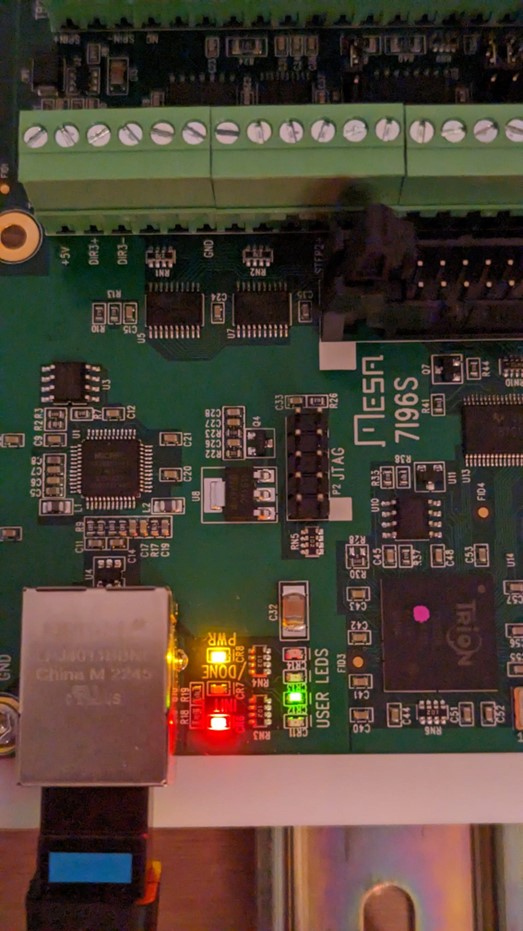

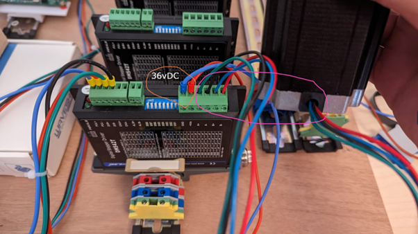

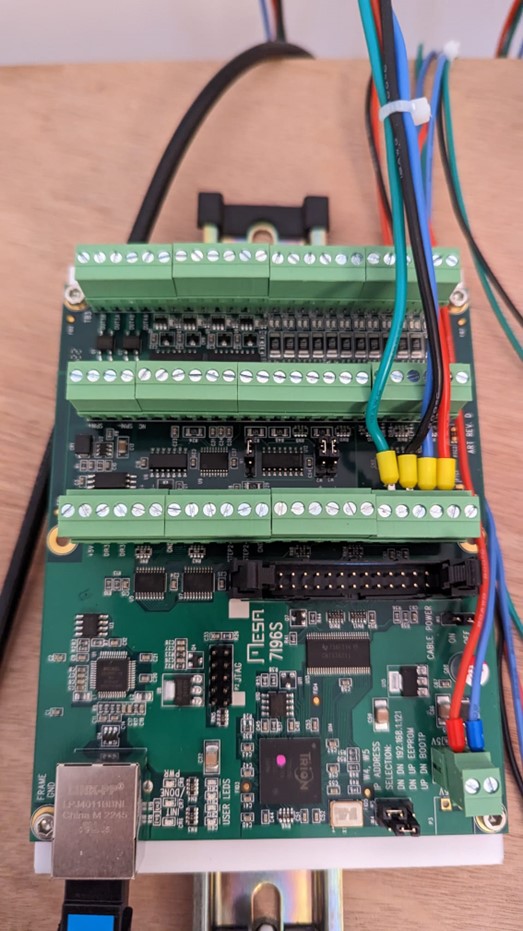

Hi,It’s my first time installing LinuxCNC after receiving lately my new 7i96s mesa board, I tried to use Mesa Configuration Tool by JT (mesact) when I am loading up the configuration CR6 is immediately turn on red light and nothing happen, I will explain all my steps I did so far:
In picture ‘1.png’ – how I made the connections.
‘2.jpg’ – General look on my board, maybe jumpers not set correctly? STEP/DIR 0 connected incorrectly?
‘3.jpg’ – What happens after I fire up my configuration, immediately when it’s open Gmoccapy GUI.What can cause those problems? Maybe I need to connect 3 stepper drivers XYZ and not only X? Maybe an emergency button is needed to be wired?
Note – I tried also with AXIS and an error occurred – hm2/hm2_7i96s.0: error finishing read
I really could have some advice here, kinda lost here

Replied by PCW on topic 7i96s first setup issue - CR6 red light
The red light indicates a watchdog bite.
The "hm2/hm2_7i96s.0: error finishing read"is the cause
This means too many sequential Ethernet data packets have been
dropped because of excessive delays.
This can be for several reasons

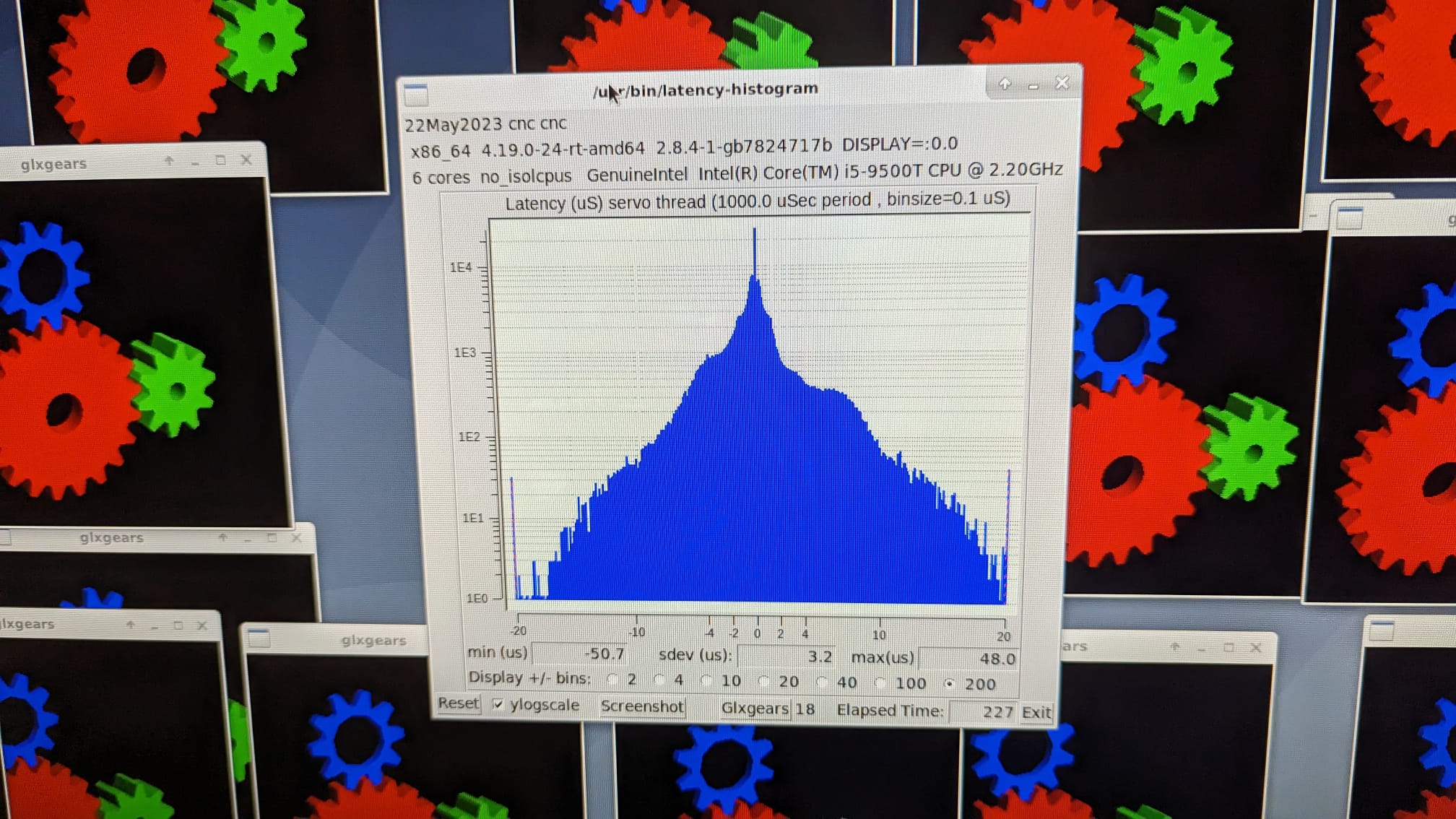

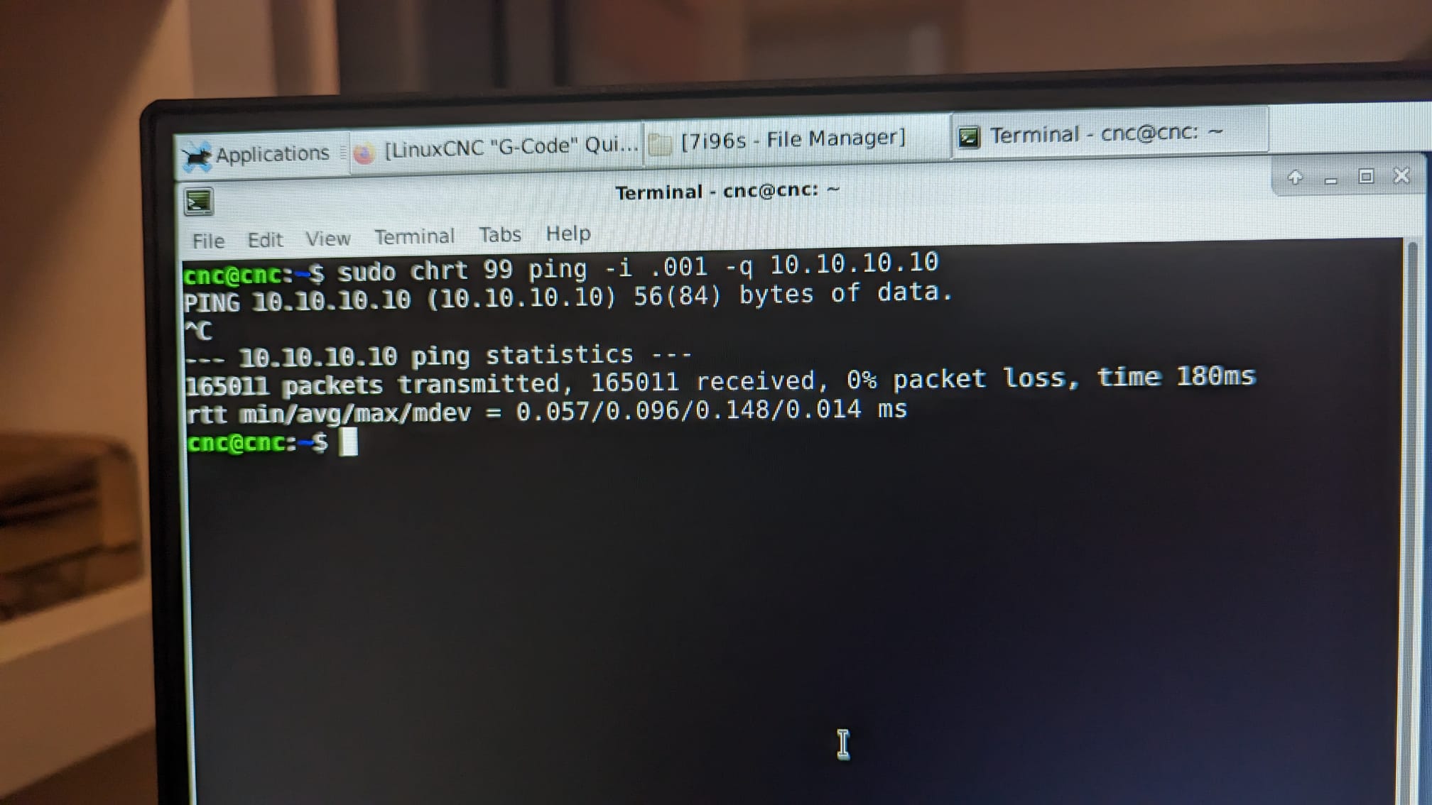

Check the network latency with:
sudo chrt 99 ping -i .001 -q 10.10.10.10
(stop with control C after a minute or so to print stats)
