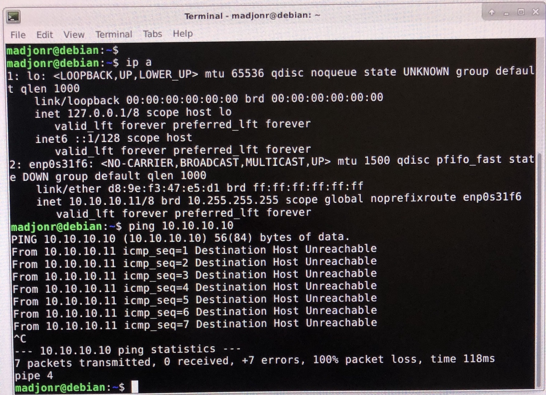

I can't connect to my mesa 7i95 card and I've tried everything I could find. Can you all help to see what is wrong?
1. my PC is dell OptiPlex 5050 sff,bios update to the latest version.
2. OS is the latest version (debian) downloaded from linuxcnc,I just upgraded linuxcnc to version 2.10.
3. Power supply is 5V 1A.
4. Figure 1 and Figure 2 you can see the power supply before and after the power is turned on.

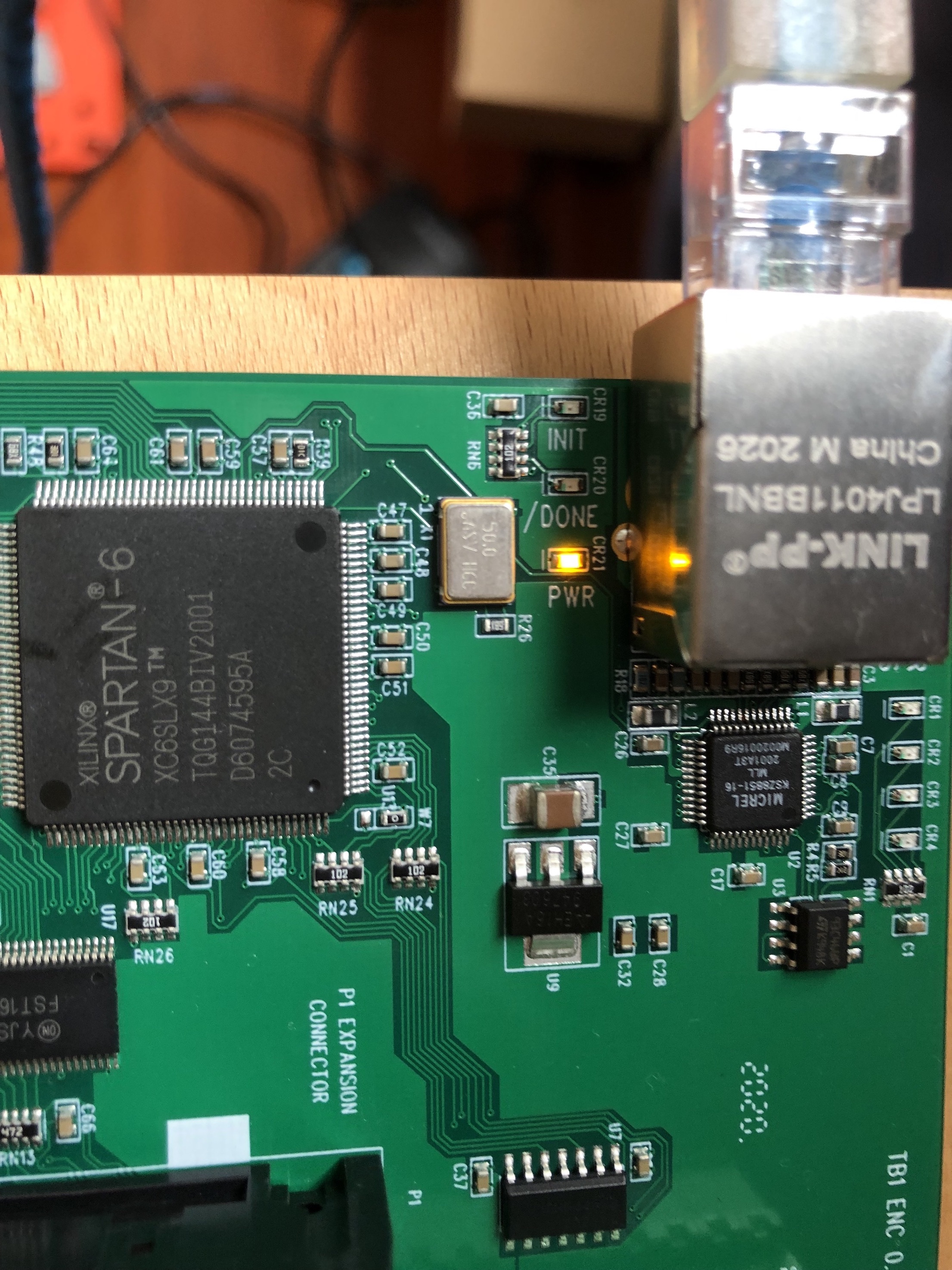

5. Figure 3 shows the status of the led indicator.

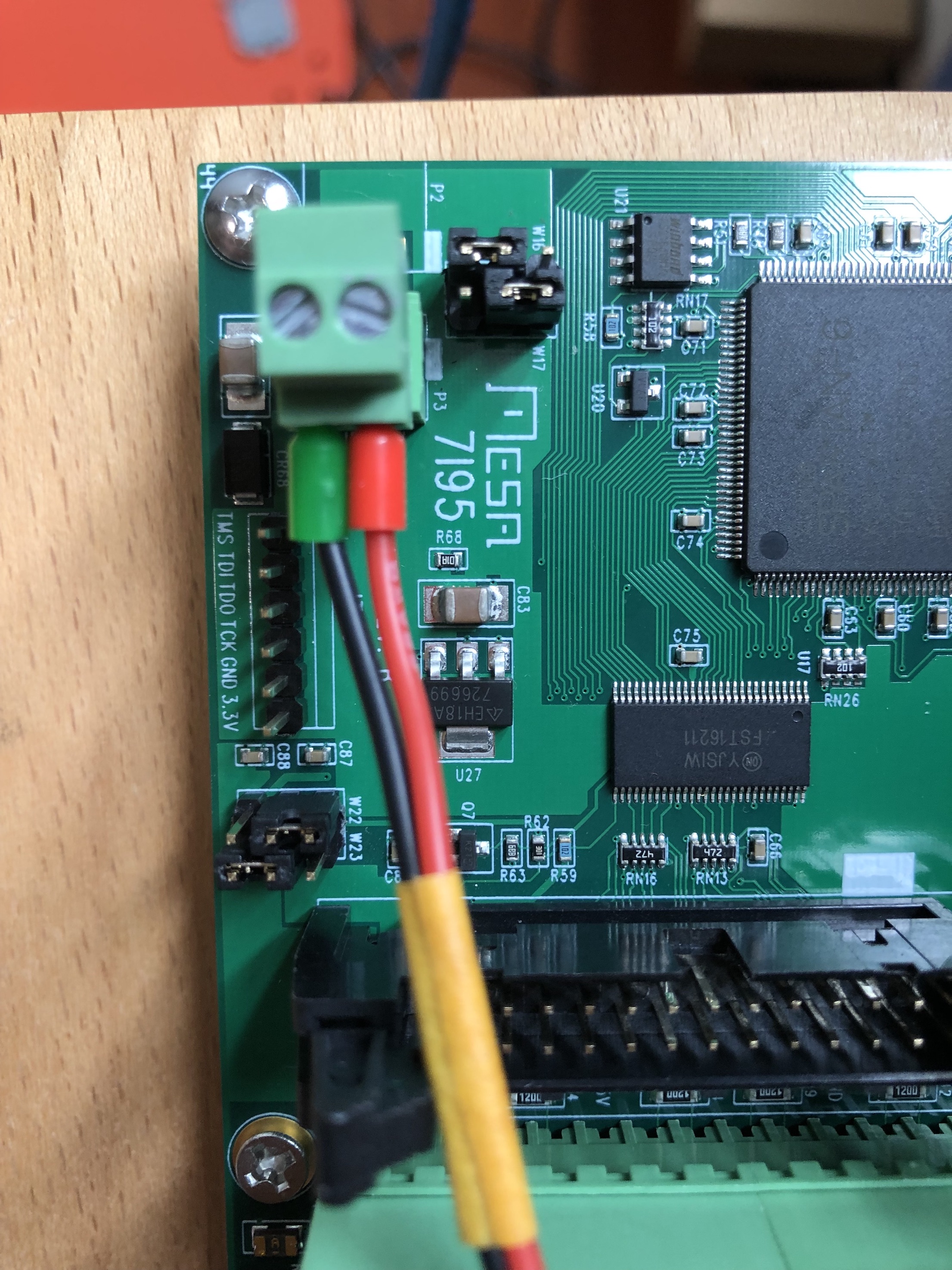

6. Figure 4 shows Jumpers W16 down and W17 up

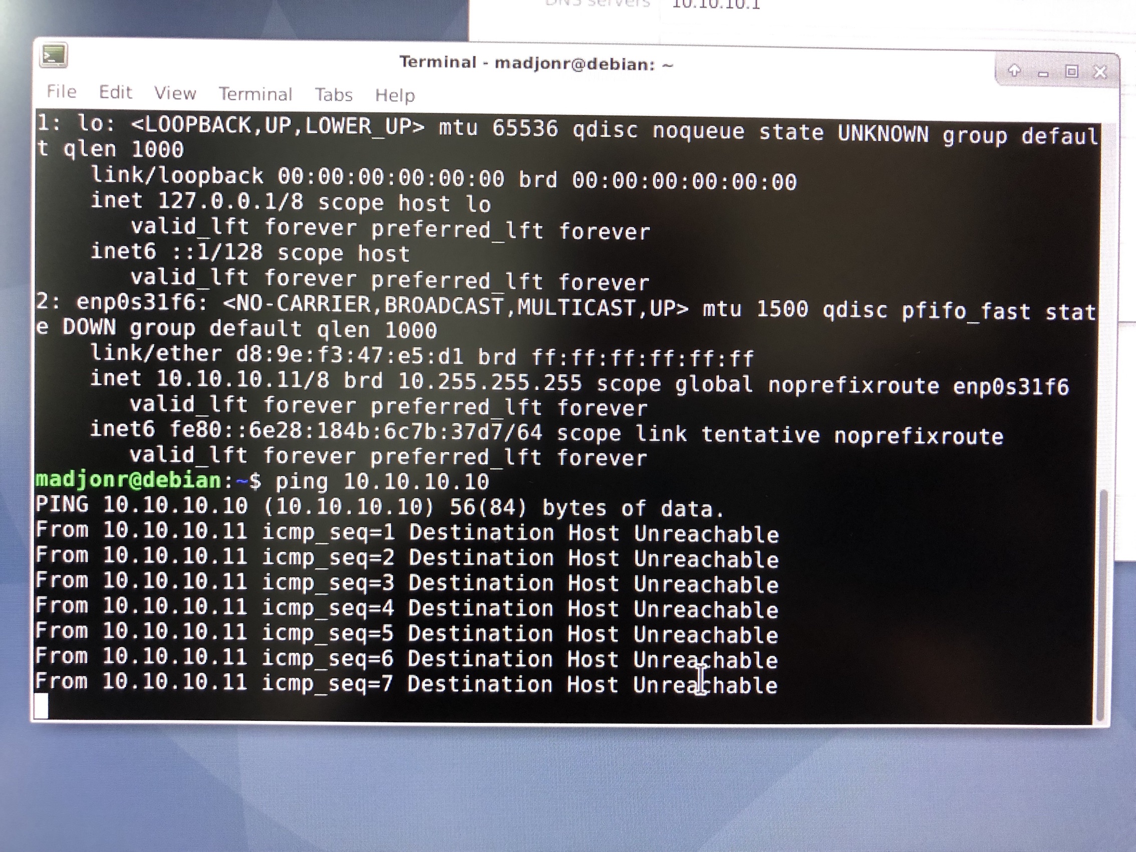

7. Figure 5 shows the led status of the Ethernet interface of the mesa card after power on, and Figure 6 shows the Ethernet led status of the PC, they are both off, I think they are not powered on.

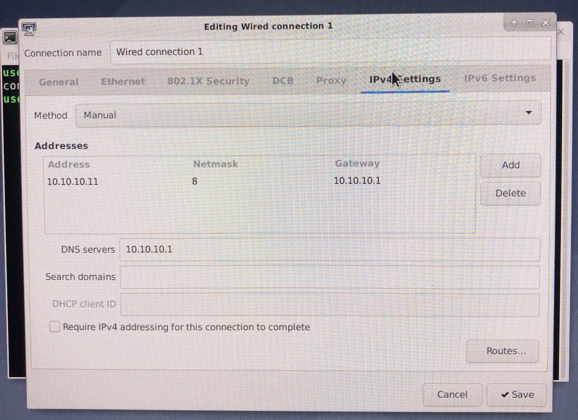

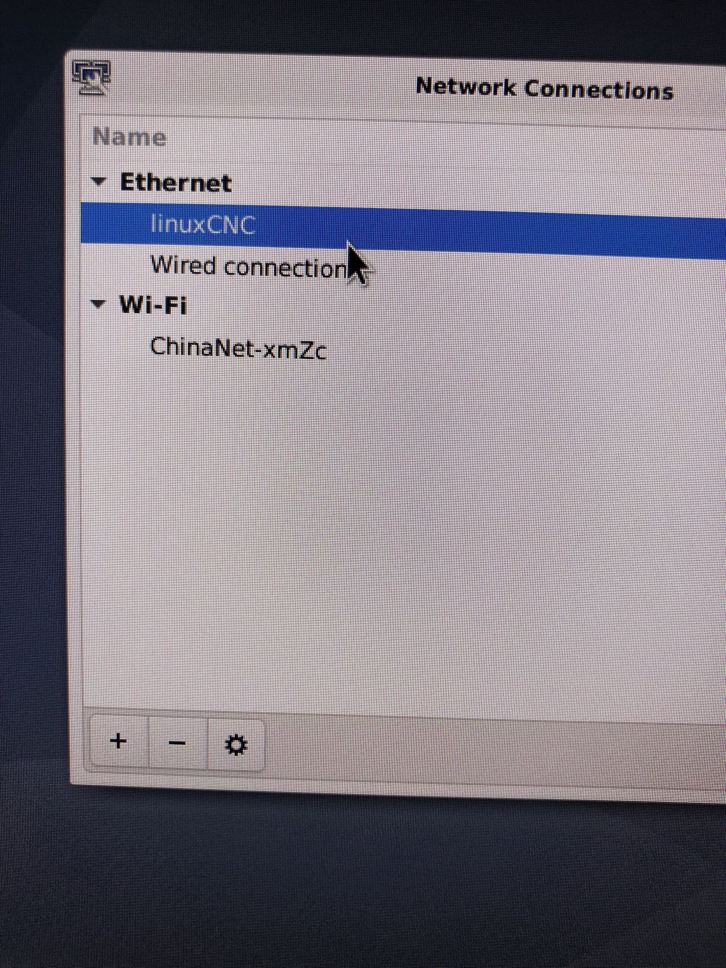

8. Figure 7 and Figure 8 show the network configuration of my connected mesa card.
9. Figure 9 shows me ping the mesa card, I can't connect to my mesa card
I am a newbie, can you tell me what the problem is?
Thank you very much!

When the LAN cable is connected to the computer, there should be lights on the LAN socket. Check the cable and LAN of the computer

I'm just looking at the second picture. - cable plugged in and no light. But I'm a beginner too.

I suspect that the mesa card's Ethernet interface is not powered up, so I took this photo. I don't know if it's a problem with the mesa card, it's a new card and I just tested it.

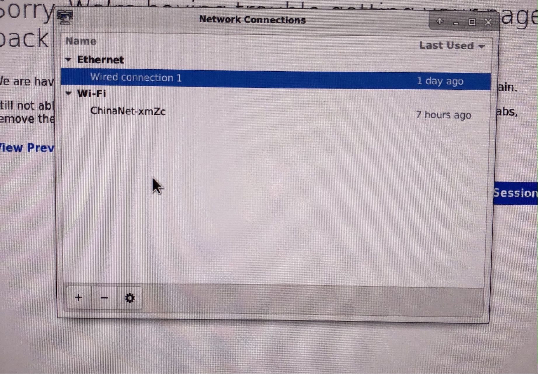

- Posts: 21995
- Thank you received: 7488
23 Jun 2023 12:09 #274128
Replied by tommylight on topic need help! mesa 7i95 connection problem
Edit the "wired connection", and delete the "linuxcnc" connection.
Creating a new connection will most probably not work.
The following user(s) said Thank You: madjonr
- Posts: 18111
- Thank you received: 5330
23 Jun 2023 12:31 #274131
Replied by PCW on topic need help! mesa 7i95 connection problem
Do the green "User LEDs" blink at power on?
- madjonr
- Posts: 19
23 Jun 2023 12:35 #274132
by madjonr
Replied by madjonr on topic need help! mesa 7i95 connection problem
I've tried this method, and it still doesn't work.

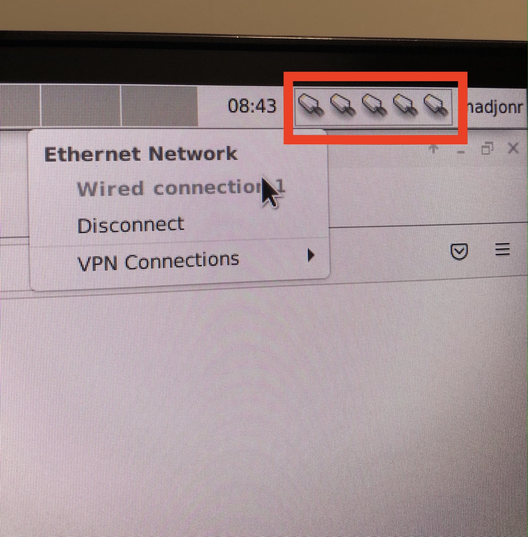

- madjonr
- Posts: 19
23 Jun 2023 13:25 #274135
by madjonr
Why are there multiple duplicates of the connection icon at the top right? Is it a bug?
I have tried this method and still can't connectEdit the "wired connection", and delete the "linuxcnc" connection.
- Posts: 21995
23 Jun 2023 13:39 #274137
NM tray issue
forum.linuxcnc.org/38-general-linuxcnc-q...nc-iso-little-issues
No carrier means there is no connection at all.
Use another cable.
This is just a stab in the dark, but do you have anything that uses POE there, and did you connect the Mesa board to such a connection?
Use another cable.
