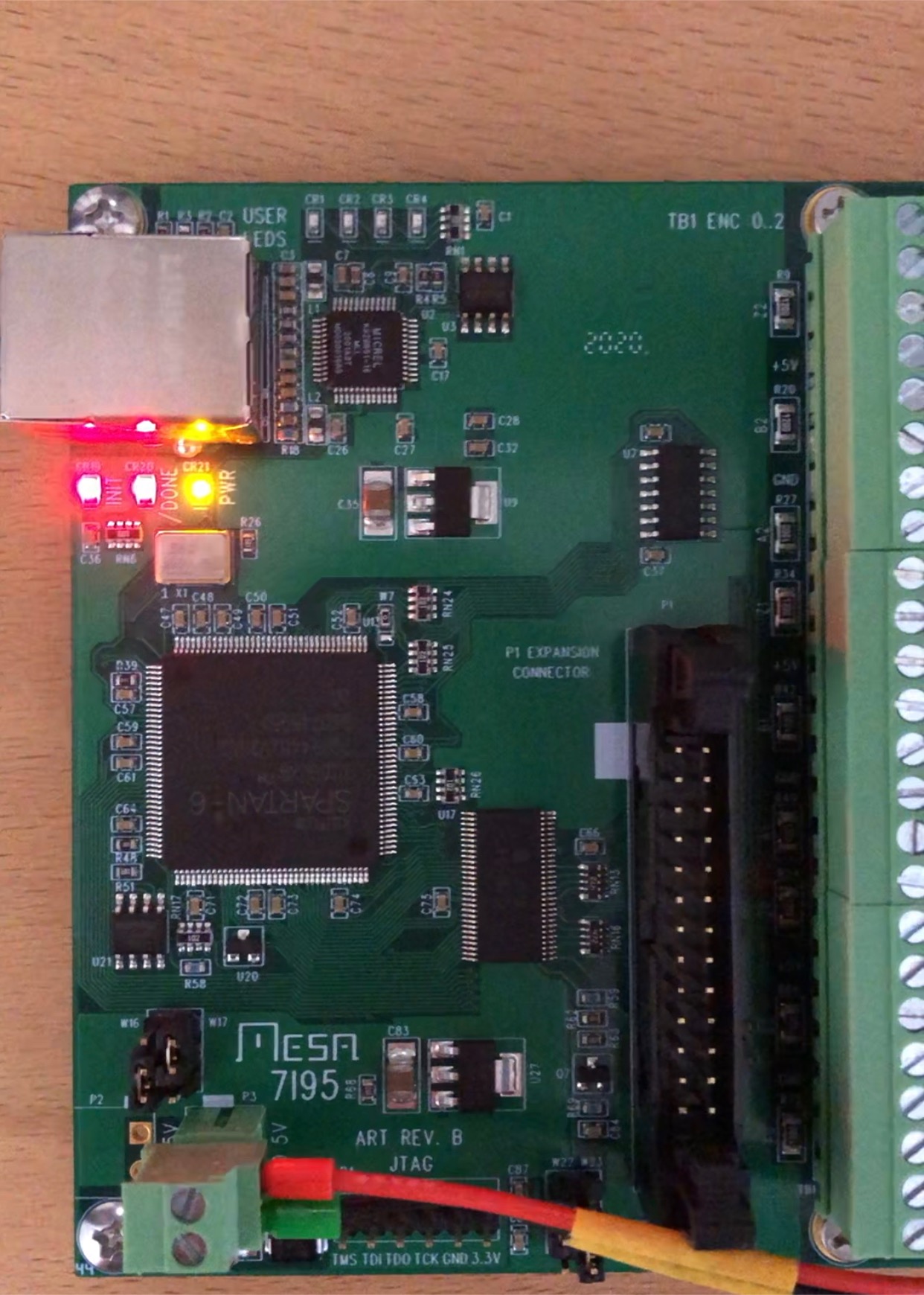

The green "User LEDs" no blink, They never light up.
The picture is the moment the led lights up.
Replied by madjonr on topic need help! mesa 7i95 connection problem
Do the green "User LEDs" blink at power on?

Sounds like at some point someone has loaded
the wrong firmware in the 7I95...

This card is new and I'm running it for the first time on power. I don't know what went wrong.

The fact the the green LEDs never blink at startup,
and the fact that the RED LEDs are off after startup
indicates that the card has incorrect firmware installed.
No Red LEDs after startup means the firmware is for a XC6SLX9 FPGA
(Valid CRC and ID match) but no green LEDs means the currently loaded
firmware is not for a 7I95 card.
Edit: There is one other possible failure mode that could cause this issue:
A failed 50 MHz oscillator module would result in similar symptoms.

Can this problem be solved? Can I fix it by brushing the correct firmware? I don't want to send it back for repair, the repair cycle is too long because I am far away from China.The fact the the green LEDs never blink at startup,
