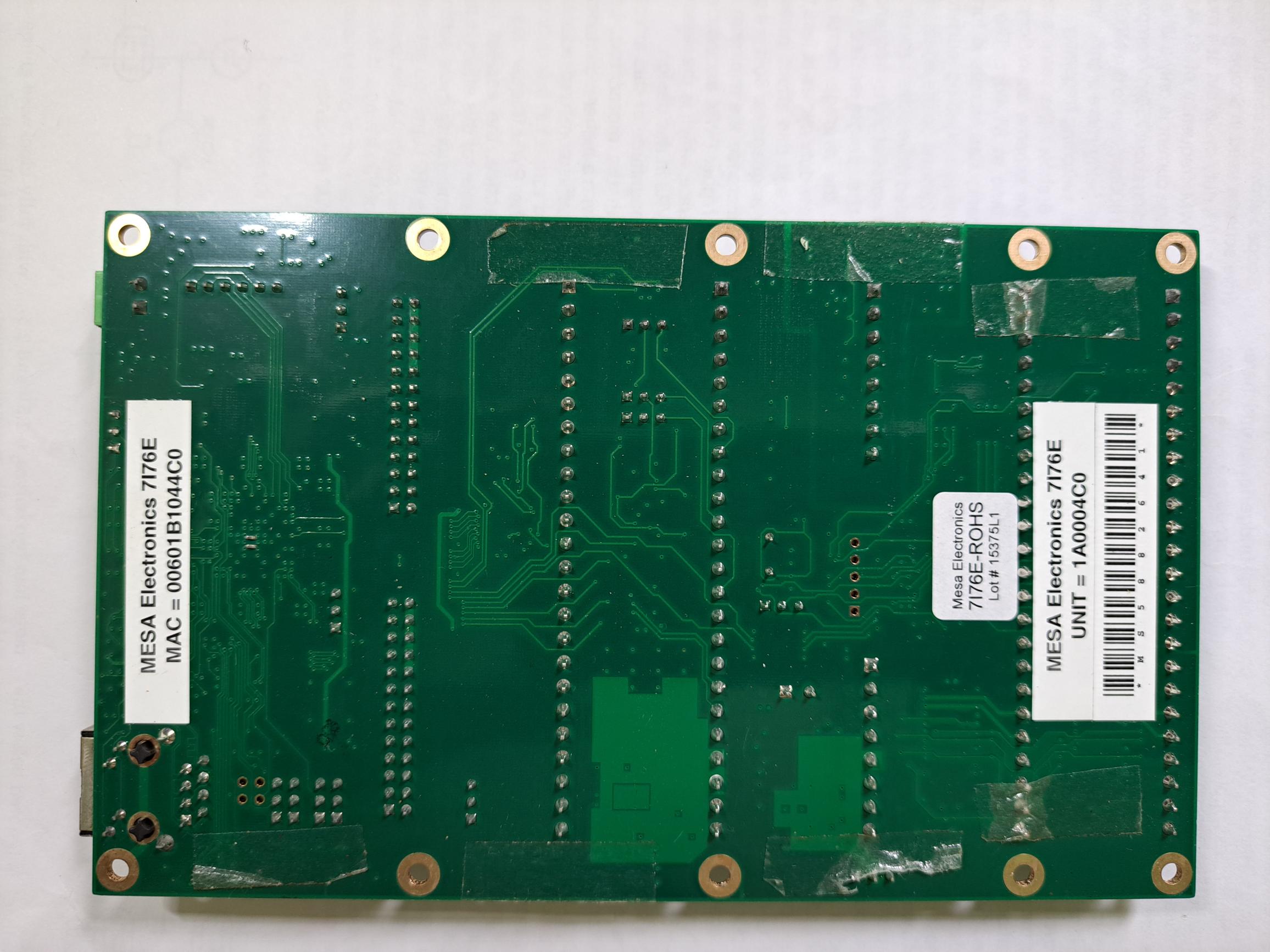

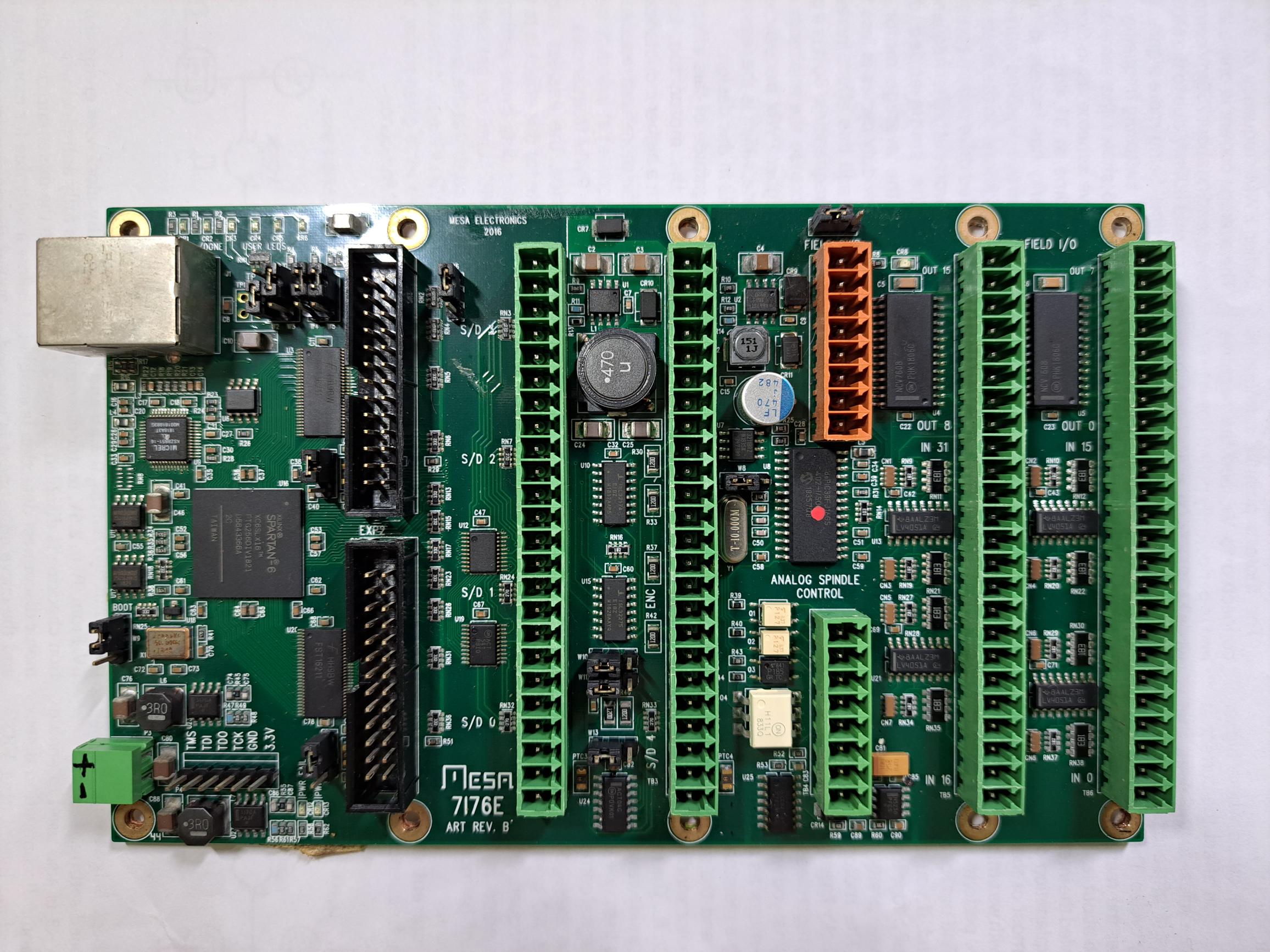

28 Jul 2023 03:07 #276425
by raychar
Replied by raychar on topic Mesa card 7i76e no longer has +5v
Thanks for the quick reply, attached are two photos of the board. Could you show me which one is the said TVS diode? what description or spec. of it is? Can i get one in market?
- Posts: 18100
- Thank you received: 5326
28 Jul 2023 03:45 #276428
Replied by PCW on topic Mesa card 7i76e no longer has +5v
That's a REVB board with no 5V TVS, Not a lot of parts run from the 5V,
mainly the step/dir drivers you might try a lab supply or other 5V supply
limited to about 2A and see what gets hot if left on for a bit.
