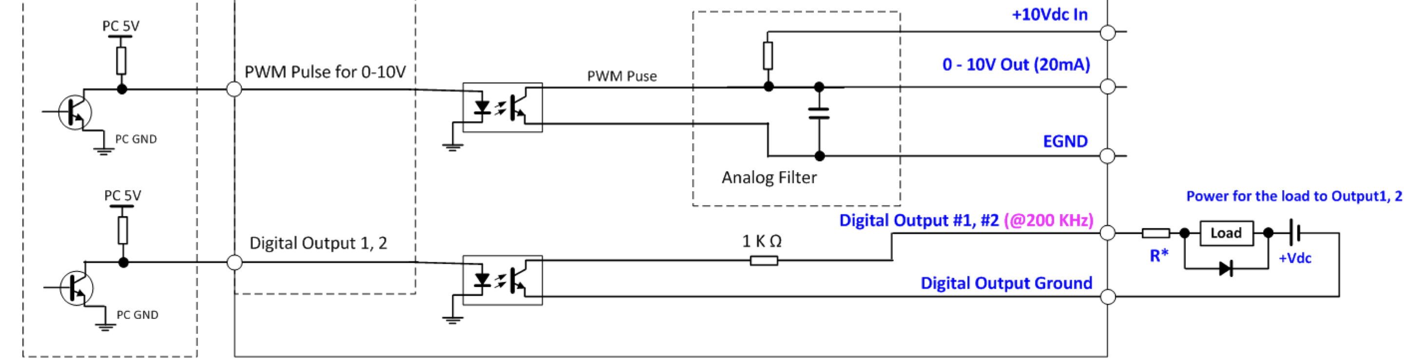

I'm running into a problem with the output that controls Spindle Enable, however. See attached MX4660 output diagram (dashed box on the left represents the "PC Parallel Port", or the Mesa 7i92TF in my case).
So, for both the PWM and the outputs (one of which I use for Spindle Enable), the optoisolators in the MX4660 need to be driven by whatever is connected to the DB25 port, and the circuit diagram suggests this can be done with pullups on the control card, which are gated to ground - this is essentially what the MX4660 does, however when the 7i92 is powered on (or, when LinuxCNC isn't running, or, when the ethernet cable is disconnected inadvertently causing a reset), the 7i92's pins all go to input mode, and the pullups take over and drive the signals high, which drives the LEDs in the optoisolators and turns ON whatever load they are controlling - in my case, the Spindle turns ON if I do any of the following:

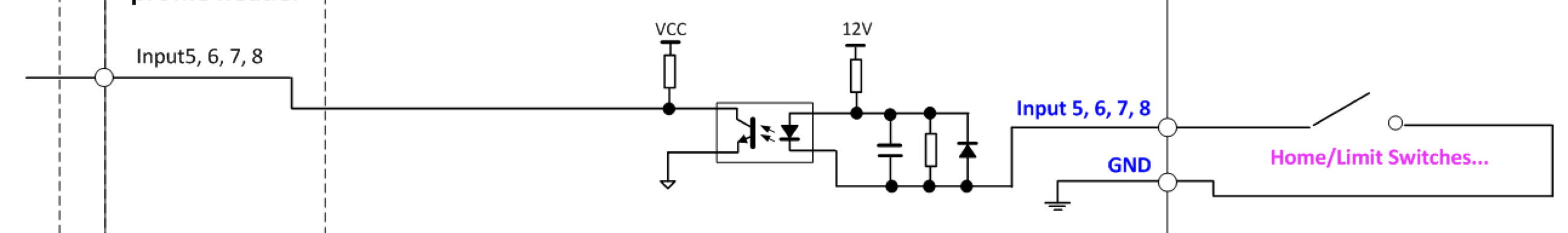

So, for the limit signals, they are pulled high in the MX4660, and when the optoisolator is activated by the sensor, the signal is driven low. When the optoisolator is not active, having the 7i92 in pull-down mode puts those pull-downs against the pull ups in the MX4660, and through experimentation, the 7i92 wins, and the inputs can never been seen as high - they always read low regardless of the sensor state.

Leaving them7I92T pull-ups enabled and adding a say 470 Ohm
external pull-down resistor to the Spindle enable pin should work.

I'm connecting the 7i92TF directly to the MX4660 with a DB25 cable, so there's nowhere to easily add this pull-down resistor.
Your suggestion otherwise makes sense- the 470 pull down would be 10x stronger than the 4.7k pull up and should prevent the opto from activating.
Hmm.. maybe I could solder it on to the back of the 7i92 board where the DB25 connector pins are exposed (I don't have the card in front of me but I'm assuming the connectors are through-hole). The only other way to do it would be to add a breakout on the cable so I can get at the pins I need to pull down.

A quick follow-up: this worked =)
I added 470 ohm resistors on the back side of the 7i92 board between DB25 pins 17 (spindle enable) and 18 (ground) and between pins 1 (coolant enable) and a nearby ground pin on the back side of the pullup/down jumper pins. This worked great to prevent these outputs from being seen as enabled by the MX4660 when the 7i92 was in reset or otherwise disconnected from ethernet.
