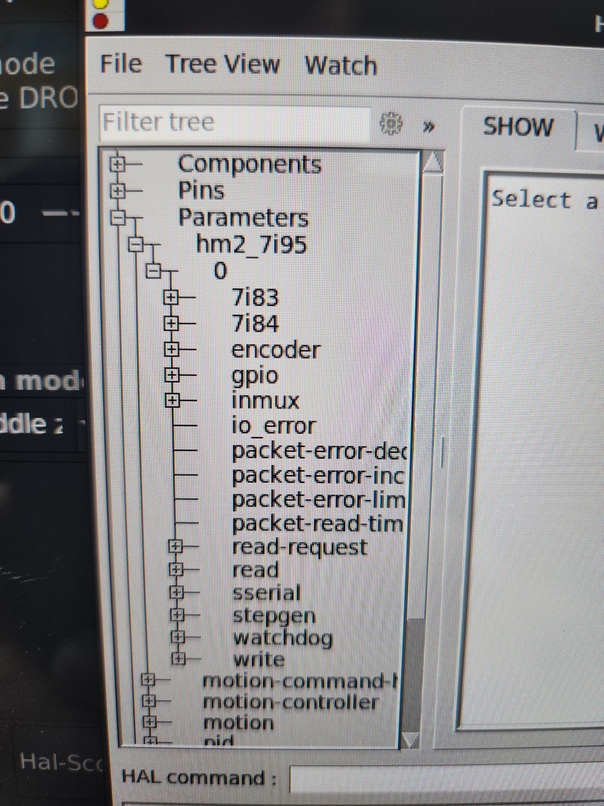

after some time zone issues i got 2.9 updated , i used mesact to make a super simple config to start with , but now im getting a watchdog error , error report attached . does this have anything to do with the wiring of my smart serial cards ?

hm2_7i95t.0.watchdog.timeout_ns' not found

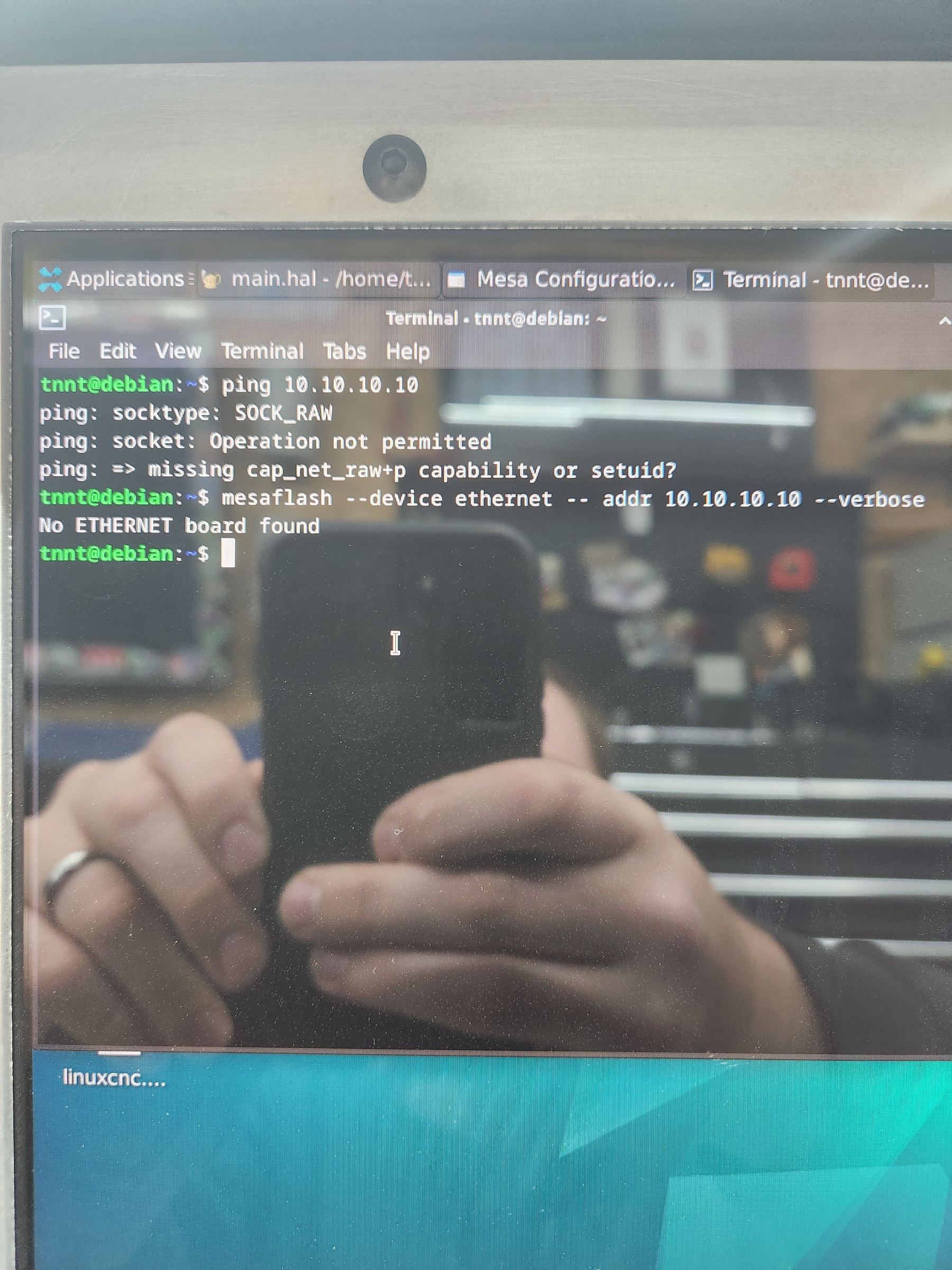

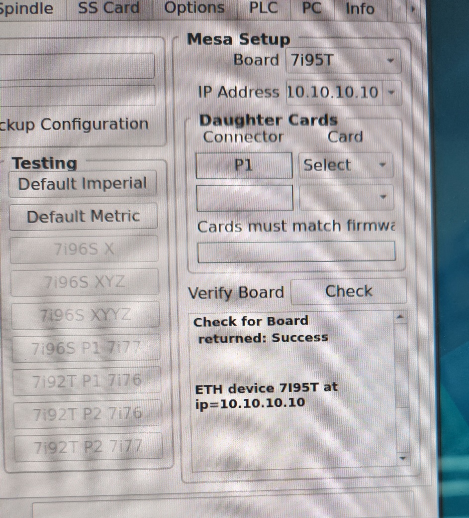

Mesact will do a successful board check at ip 10.10.10.10 I can not ping 10.10.10.10 it gives me the error pictured below If I use the pictured command in mesa flash it gives a no ethernet board found.Ethernet setup was done following the guide on here.

The ping error may happen if a LinuxCNC session did not exit properly.
(so access to10.10.10.10 is blocked)
This can be fixed with:
halrun -U
The watchdog error is most likely a mesact bug
(maybe fixable by updating to the latest version)
The hal card name will just be 7i95, not 7i95t

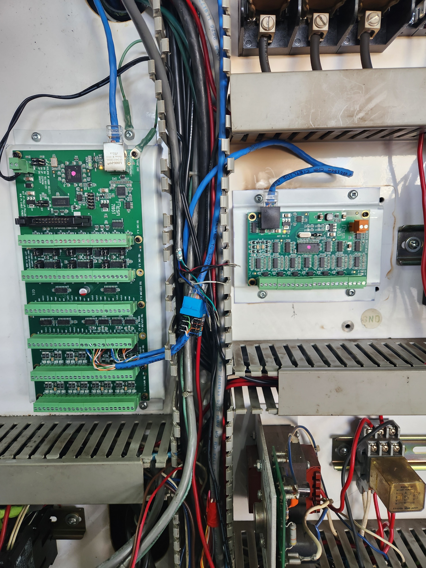

Updating mesact took care of the watchdog issue , realizing my ethernet cables were wired 568a instead of b took me a bit of time , but now it's all connected and avilable in halshow , thanks for the help.

Yes, the ping thing is odd, sounds like a bug with ping or the OS.

I really think Mesa should show the pinouts/colours for both 568a and 568b. I got caught too and I found it a bit tricky to draw up the correct pinout. Maybe different countries standardise on differen wiring schemes.Updating mesact took care of the watchdog issue , realizing my ethernet cables were wired 568a instead of b took me a bit of time , but now it's all connected and avilable in halshow , thanks for the help.

I'm thinking it's a regional thing , the cables I used I had someone make up for some poe security cameras I used to have and they were done 568a , I had a different friend make up some cables and he also went to 568a , he said thats what he does every day.
I suppose if you are not cutting the cable it wouldent matter as long as the ends matched.
I gotta say tho , once I had it all figured out its amazing how slick these cards work , i got the amps and encoders wired in this morning and was playing around in halshow enabling the amps and moving things around , have to do all my scaling and start working on the hal file so it knows to use the 7i83 outputs next.
