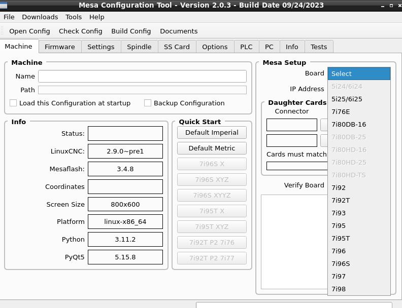

I have installed mesact 2.0.3 and have a problem with the board select drop down list. The lines for 5i24/6i24, and 7i80DB-25 thru 7i80DH-TS are all dimmed and can not be selected. Anyone know how to fix this?
Debian 12
LinucCNC 2.9.0
6.1.0-12-rt-amd64 #1 SMP PREEMPT_RT Debian 6.1.52-1 (2023-09-07) x86_64 GNU/Linux
Mesaflash version 3.4.8
Debian 12
LinucCNC 2.9.0

This is just a guess, but it seems there is no support for those cards yet, MesaCT is still under active development from a single person, JT, so if anyone reading this can help him, please do.
It is on github.
In the meantime, try PncConf, it is included with LinuxCNC, but you probably already know this.
It is on github.

Yes PncConf does work and does a fairly good job. The only issue is I like to try every available tool to do a job to see how they work and which one works best for what I do. I have looked at JT's source code but I did not see any thing that stuck out that would disable these cards. I am not a python programmer, I know far more about pascal/Lazarus.

I just looked thru more of JT's source code and found where those boards are disabled. Maybe I can find a way to help JT get things working. I have some time and quite a few of mesa's boards so I can at the very least help with testing.

I disabled them when creating Mesa Configuration Tool II until I have time to program the configuration creation for those boards. The Mesa Configuration Tool I has those boards enabled but not the newer boards. I welcome and PR's to enable those boards. Just keep the code similar to mine and use tabs, not spaces.
The biggest problem is not having the boards to test with and they are no longer in production.
JT
