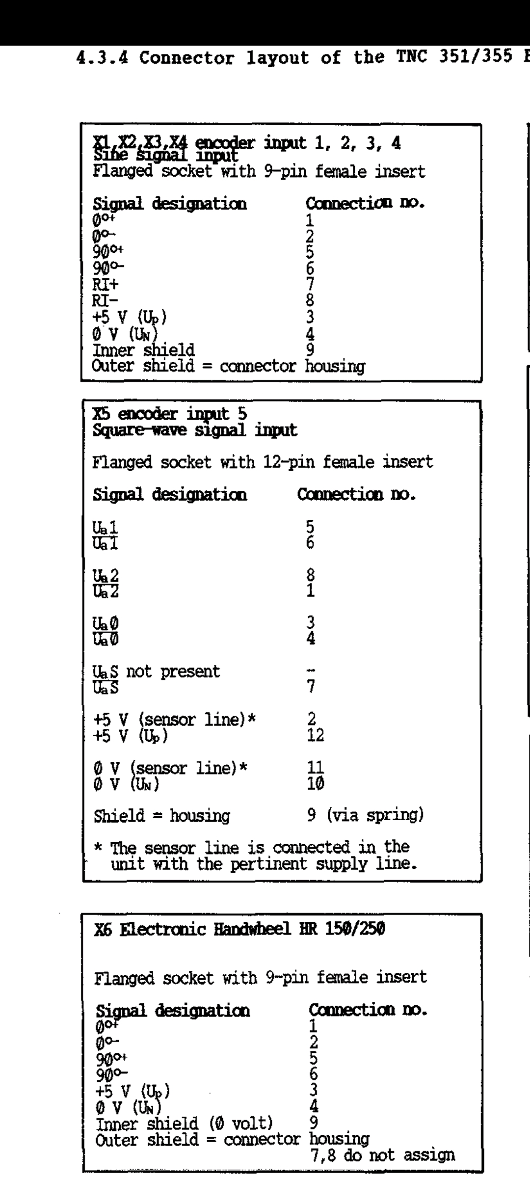

Hello.
Servo drives have -10v +10v differential analog input without feedback by encoder(servomotors have only tacho not encoder).
The controller is heidenhain tnc 355 and the
linear encoders feedback goes directly to controller.
X1/X2/X3 shown in photo are encoder signals.What are these signals ? 1Vpp ?
Linear scales are heidenhain LS 703C
How can read these encoders with linuxcnc?
Also how can config this type of pid
with speed +-10v analog speed control to drives and encoder position feedback to linuxcnc?
Reading tacho can help somewhere?

08 Jan 2024 14:11 #290216
Replied by PCW on topic mesa hardware for mill retrofit
If the machine does not have separate boxes to convert the
1V PP sine/cosine to quadrature, you would need to obtain these.
These are called interpolators or "EXE" boxes and often available
on Ebay for reasonable prices (search for "Heidenhain exe")

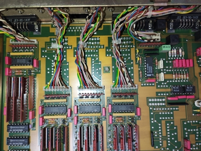

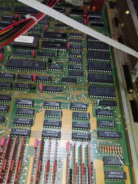

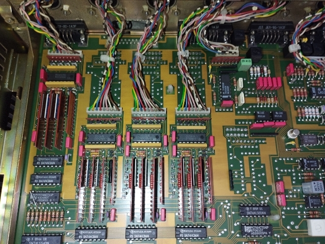

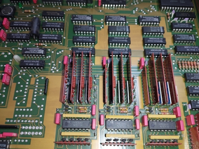

08 Jan 2024 22:42 - 08 Jan 2024 23:02 #290242
by vre
Replied by vre on topic mesa hardware for mill retrofit
I have mesa 7i80hd / 7i33ta / 7i37ta.
linear scales are 1μApp type LS 703C
product.heidenhain.de/JPBC/image/HWP.EN/...029-93_ls_703(c).pdf
I have no exe boxes but i have the original le 355 b controller.
Is possible to steal quadrature signals from inside of controller?
I have seen a thread here that someone with similar controller tnc 155 stolen quadrature
signals from inside controller as described here
www.machineability.com/Bridgeport_series_II.html
I have attached mine controller photos..
where is possible to find these signals?
