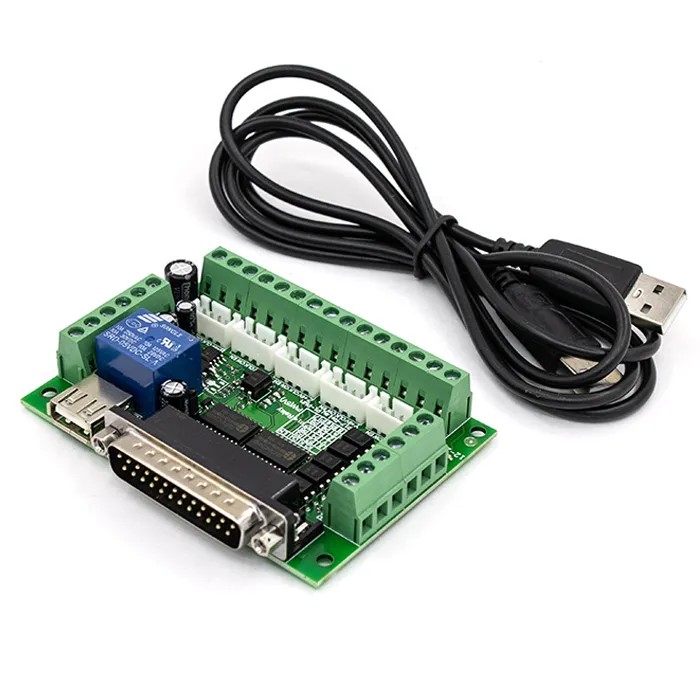

10 May 2024 14:15 - 10 May 2024 14:21 #300325 by wzor
Put a board like this on and you won't have any problems! Price $5 + LPT cable!
It connects to the Colorlite board!
Last edit: 10 May 2024 14:21 by wzor.
10 May 2024 16:30 - 10 May 2024 16:48 #300335 by besriworld
This board is not good for high speed step/dir .
For reliability you need differential signals.
It is also important to have a nice layout for the input signals.
Last edit: 10 May 2024 16:48 by besriworld.
