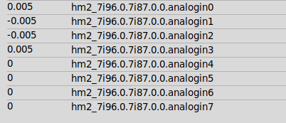

Hello,
I am playing around with a Mesa 7i96 + 7i87 (analog input). Mode0 seems to be fine but when I try to change SSerial Mode to 1 or 2 I am getting this error message during LCNC startup.

Strange, all modes work for me on at least 2.9 and 2.10
(2.8 is hard to test because of Python 2/3 issues)
Maybe some more generic issue
(the OOM error is suggestive of this)

Mhh...ok. I did more testing in Mode 0 and noticed that Port 4 - Port 7 don't show any values when I connect them to the reference voltage.
Ports 0 - 3 are constantly changing ever so slightly around 0V +/- 0.05 but Ports 4 - 7 are at 0V.
Could this be a hardware issue?
Last edit: 29 Oct 2023 16:02 by 0x2102.

- 0x2102
- Posts: 223
- Thank you received: 88
30 Oct 2023 15:12 #284134
by 0x2102
Replied by 0x2102 on topic Mesa 7i96 + 7i87: Error in Mode1 or Mode2
Ok, I did update the 7i87 firmware to R16 and that fixed everything. Mode0: all channels are on and Mode1/Mode2 will now load without the error.
Thanks.
Thanks.
