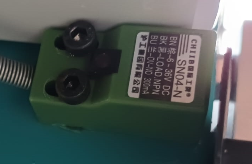

2/2: Inductive end stop limits and emergency stop button not detected
After configurating speed and acceleration of all engines i tried to set up the end stops and emergency stops.
Disafortunately they seem not to be detected once more.
The inductive end-stops have 3 wires ( Gnd, Vcc(+70v) and a signal cable of 24v)
When the end stop is not active the signal voltage is near 0v (200mV); when it is active the signal is +24V althouth there is noise on it (+/-5V at 20kHz)
As for the emergency stop interruptor, this is a mechanical switch.
Voltage is 9V when closed and near 0V when open
I tried all the GPIO combinations in the PncConf wizart including invert check box option.
But had no feed back
I used the Hal configuration screen to check if the XYZ-home and end stop gray balls turned into yellow when activating each end stop and emergency stop individually. But there was no change at all.

13 Nov 2023 15:39 #285270 by PCW
I hope you mean Gnd,Vcc, (+24V) ...
What inputs are you using on the 5ABOB?
I would verify the signal levels at the DB25 connector of the BOB
Also AFAIK you must have the 7I92T set for pullups on the I/O to work with the
5ABOB isolated inputs.

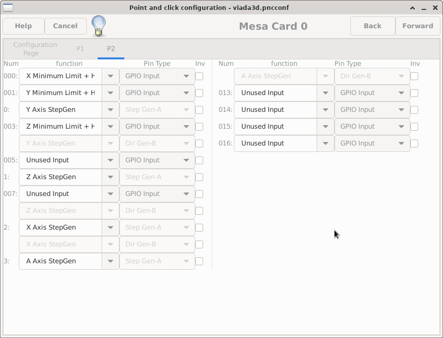

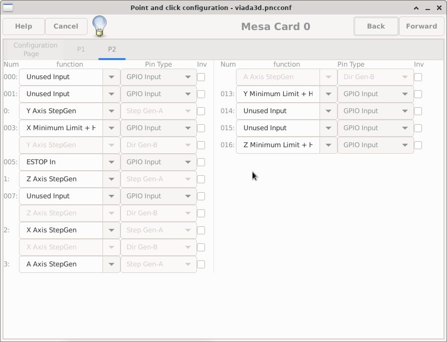

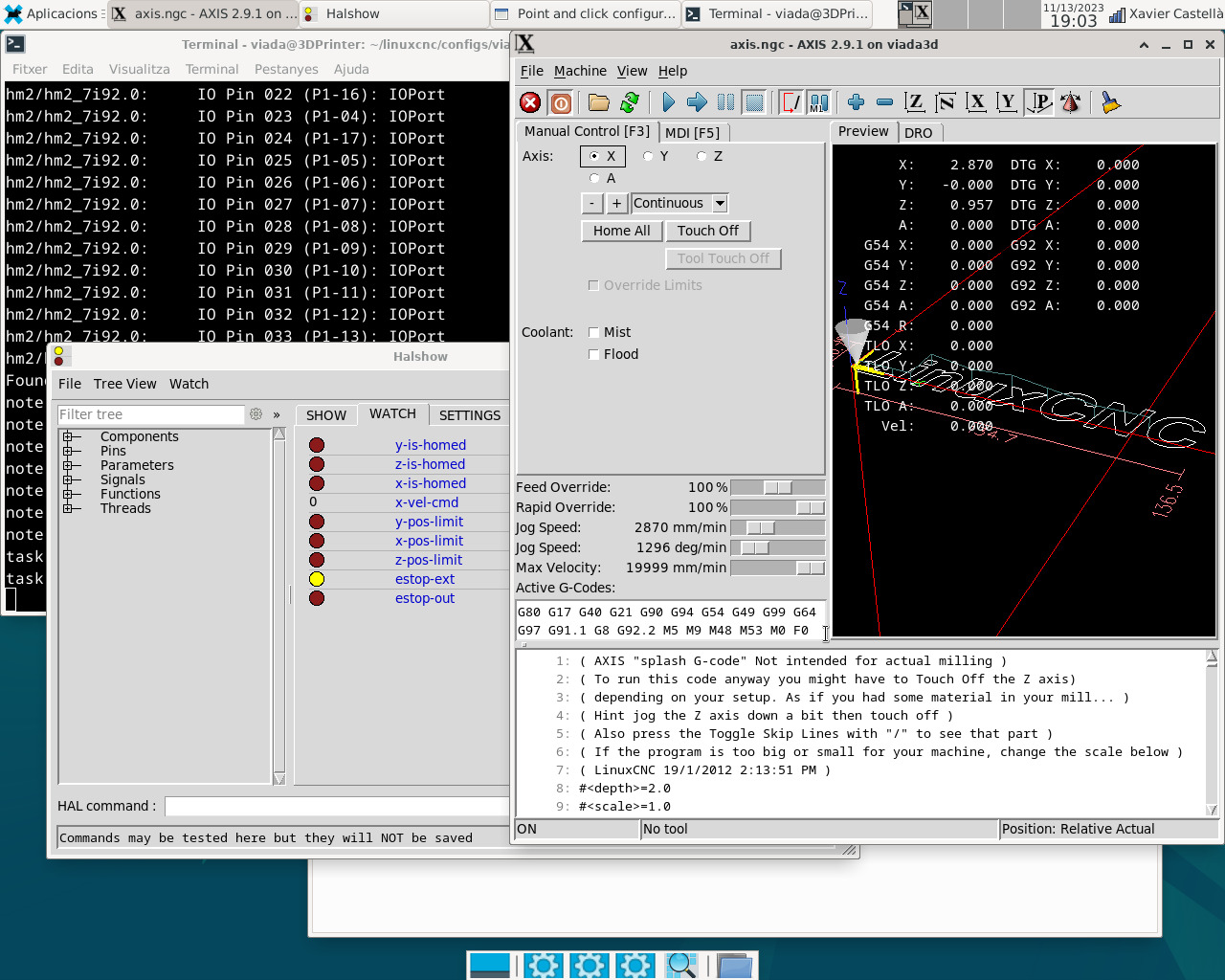

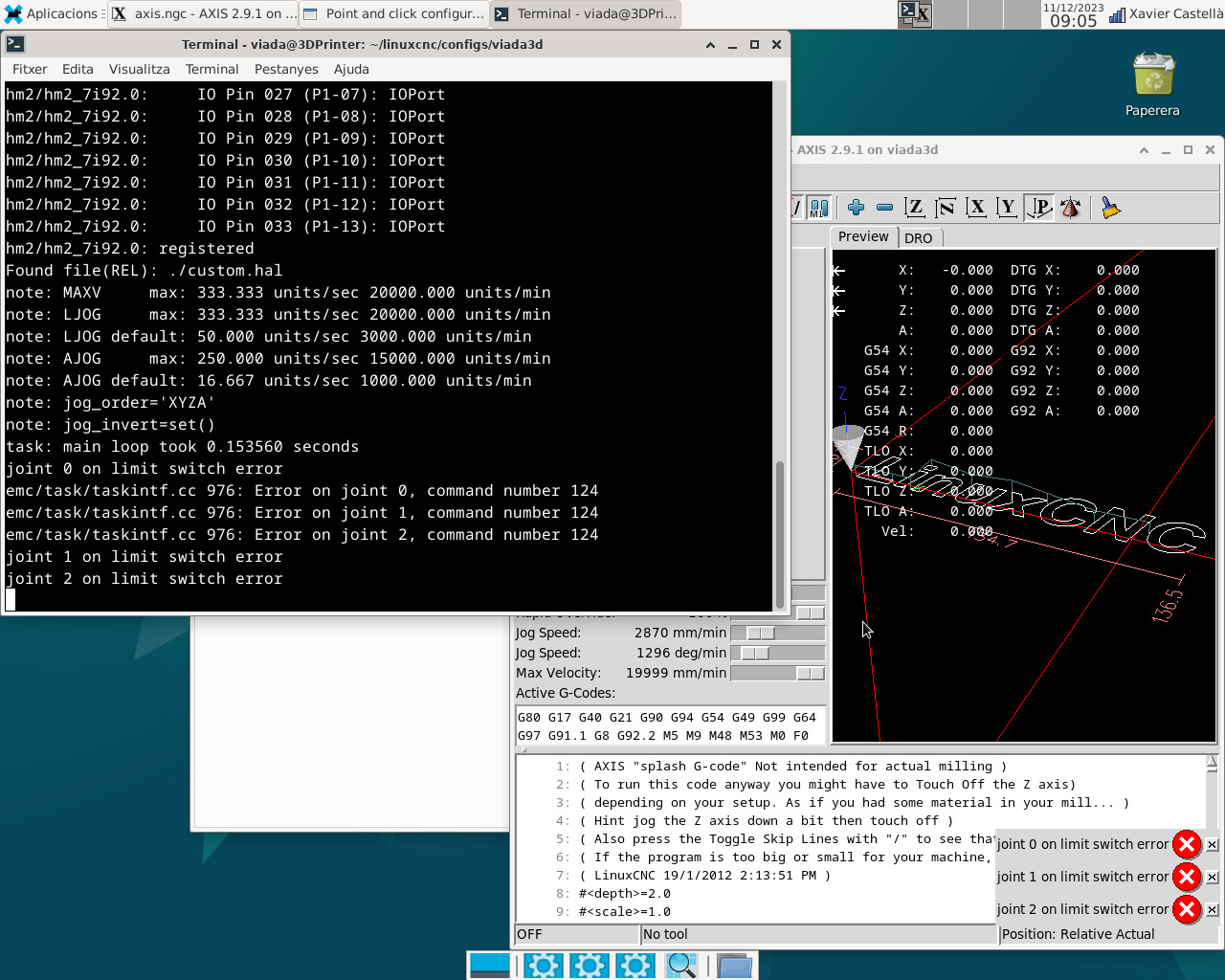

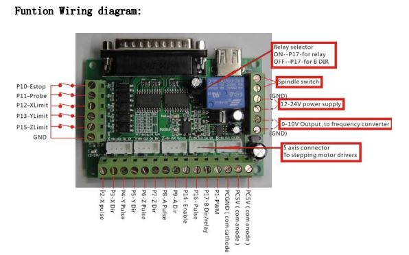

13 Nov 2023 19:13 #285305 by gothia
Dear PCW:
1/4: inputs in the 5abob
Inputs for en end and emergency stops in the 5aBob are the ones previously wired in the machine currently in production:
- X end stop - > P10 (input voltage in the 5abob:  0v when activated, 24v when not activated)
- Y end stop - > P11 (input voltage in the 5abob:  0v when activated, 24v when not activated)
- Z end stop - > P12 (input voltage in the 5abob:  0v when activated, 24v when not activated)
- Emergency Stop -> P14 ( input  voltage in the 5abob: 9 v when the button is not pressed, 0v when pressed)
2/4: Output voltage after the 5abob
Voltage is 4.85V  in the output DB25 connector of all the End Stops and Emergency Stop related pins when activated / unpressed.
This voltage was tested in the wire output DB25 connector having the pull up jumpers down (jumper w1 and w2 down Pull down to 0V)
3/3: Might interferences / noise be interrupting the comunication with hal show window???
All axis steppers moves but end stops have no sensitivity!! :_(
As for the PncConf wizard the best aproximation set up i was able to have was the one below:
Now no error messages appear but i can not assing the right end stop to each axis.
All other options regarding the end stops switches show an error related to a joint:
emc/task/taskintf.cc 976: Error on joit [0/1/2], command number 124
Joint  on limit switch error
On the other hand the main issue is i have no feed back of any end stop signals using the Hal Show window (the window showing yellow circles when a signal is received by linuxcnc and redish circles when it is not received ot it is off)
4/4: Emergency button shows status change in the hal show window, but it is really random
The only yellow circle that changes its status color is one for the emergency stop (pin 14).
But I must press and relase the red emergency button 10 times or more to let the yellow circle appear or turn to redish again.
It is really a random process: not always 10 times sometimes is less sometimes is more.
I connected  the mesa card 7i92 to the frame ground using the top left mounting hole (near the Ethernet jack) as said in the manual, but this kind of interferences remain...
My main goal at that moment is getting the  right status of the end and emergency signals in the hal show window (yellow and red circles window)...
Do you have any idea about what may interfere the signals??
Am i going the wrong way?
As always,  thanks in advance for all the assistance you can bring me.
Best regards
13 Nov 2023 19:52 #285309 by PCW
Not sure about your BOB but on the ones I have seen, you must have the pullups
enabled on the 7I92T to interface to the BOB. This is because the input optocouplers
connect their bare phototransistor outputs to the DB25 connector pins with no buffer or pullups.

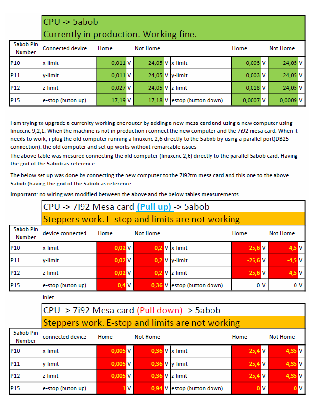

15 Nov 2023 19:01 #285533 by gothia
Dear All:
i finally measured all the limits and the endstop voltage in the 5abob pins/terminals having 3 stages:
Always keeping the same wiring and having the CNC router connected to the 5abob and then;
a) to the old computer linuxcnc 2.6 with a parallel cable (DB25)
        (everything works fine this way and the the limits and e-stop voltage looks reasonable.)
b) to the mesa card 7i92 (having the jumpers W1 and W2 up/pull up) and then to a new computer(linuxcnc 2.9.1)
        (only the steppers work fine)
c) to the mesa card 7i92 (having the jumpers W1 and W2 down/pull down ) and then to a new computer (linuxcnc 2.9.1)
There you have the voltage:
As you can see when not using the mesa 7i92 end stops and emergency stop voltage look reasonable.
but on the other hand, when adding the mesa card, the Voltages look quite crazy.
Questions:
Might this situation be fixed by reseting the card and uploading the firmware for the 5abob again?
Does it looks like a problem due to a wrong jumper set up in the mesa card ( Pull-up jumpers ) or a wrong pncconf option selection?
As always thanks in advance!!
15 Nov 2023 19:14 - 15 Nov 2023 19:17 #285535 by PCW
It looks to me like a grounding issue on the 24V supply
Probably the 24V supply got is ground connection via the parallel
port on the PC. You must make sure the 24V common connects to the
BOB common.
(The 7I92 can have no effect on the 24V side of the BOB inputs
so this has to be a power supply connection issue)
Last edit: 15 Nov 2023 19:17 by PCW.

19 Nov 2023 20:36 - 19 Nov 2023 20:40 #285951 by gothia
Thanks Pcw: The Emergency stop is finally working
As you said, the common cathode pin on the 5abob, the one next to the Pin 1 (Vcc [+5v] ) is appearently not working...
I found 2 working solutions that let the emergency stop work:
a) Using the power supply gnd Pin ( the one next to the +24v pin/connector)
b) Using the Gnd pin/connector ( next to the Pin 15 ) used in our case for EMI protection.
In adition the end limits were also set up without troubles!!

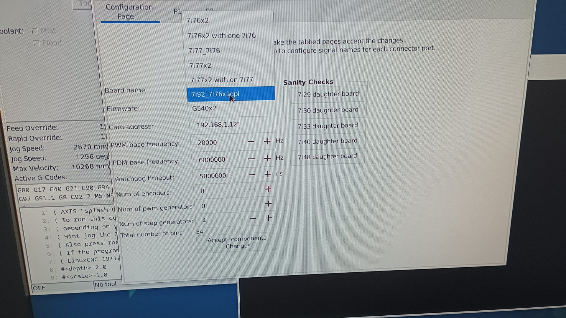

01 Dec 2023 17:35 - 01 Dec 2023 17:36 #286978 by gothia
Hi there again:
I wish i could improve an old 5aBOB for a mesa 7i76 daugther board by mesa during the comming Xmas holidays.
Shall i ask you if the 7i76 daughter board is the most reasonable option for a 7i92t controller board?
I am working on 4axis machine based upon steppers although i might replace them for servos in a few months.
Do you have any expecience having 7i92 + 7i76??
Would you recomend me any other combination?
Thanks and best regards.
