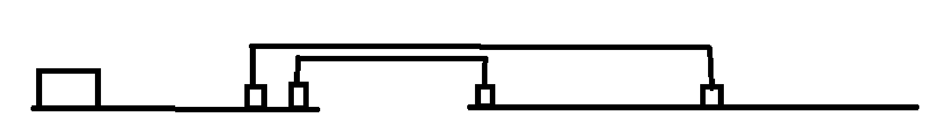

I did a bit more checking and alothough the firware you provided for the i80hdt has the same functionality as the i93, the connectors are in a different order
in the i93 iO-0 to IO-23 are on the the connector closest to the edge of the PCB (P2) whereas on the i80 IO-0 to IO-23 are on P1 the left most connector (P3 closest to the edge of the PCB)
The connector order is important on my setup as I am using 50 conductor ribon cables to connect to my custom board as below.
Any chance there is a bit file that would swap P1 and P3?

05 Nov 2023 14:26 #284629
Replied by PCW on topic Creating custom configs for Mesa 7i80HDT
- slammers

Thanks for this file. Although it will work the way it is, it would be slightly better if you could move the StepGens now on P1 to P2. That way the IO pins would be the same numbers as my original implementation and I would not have to cover up the middle P2 connector with the ribbon cable that would be plugged into P1.
I tried opening your source project in Efinity software but when I run the synthesis step, the program just crashes part way through the parsing project. What version of Efinity are you using to create this bit files? I have 2023.1

11 Nov 2023 00:00 #285065
I normally use the version I started with (2021.2) since placement seed
values change from version to version. I have used 2023.1. You also may
want to re-fetch the current sources, as there has been some roto-tilling to
get the latest updates (PktUART, periodm, oneshotm,sserialb) included on
all builds. In addition slow clock versions have been added to 7i96s,7i95t,
7i80hdt for denser configurations that are hard to meet timing.
What error do you get?
I do know that you need more than 4G of RAM or
Efinity will run out of memory on some compiles.
Also you could just send me or post your desired
pinout file and I can compile it.
