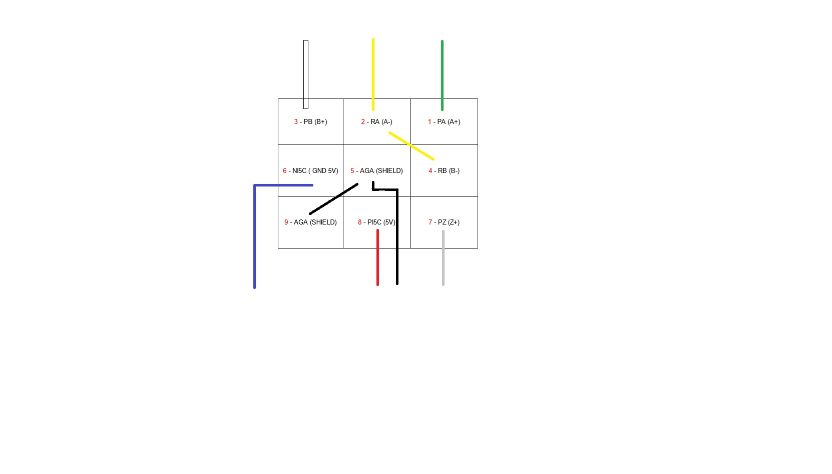

Hello,
Following a misunderstanding of the freqrol drive and its configuration, I would like to exchange it for a more recent generation variable speed drive.
But I would like to keep its servo control.
The freqrol documentation mentions a P.L.G. spindle encoder.
Does anyone know what P.L.G corresponds to?
Does the PLG connection (below) correspond to a standard incremental encoder connection? A+/A-/B+/B-/Z+/Z-/5V
/GND
If yes, what do I wire Z+/Z- for?
1-PA
2-RA
3-PB
4-RB
5-AGA
6-NI5C
7-PZ
8-PI5C
9-AGA
the plg will be connected to a 7i77 card

My guess would be:
1-PA A+
2-RA A-
3-PB B+
4-RB B-
5-AGA Shield?
6-NI5C 5V GND
7-PZ Z (single ended)
8-PI5C +5V
9-AGA Shield?

Same here, as far as guessing goes.My guess would be:
1-PA A+
2-RA A-
3-PB B+
4-RB B-
5-AGA Shield?
6-NI5C 5V GND
8-PI5C +5V
9-AGA Shield?

to check the encoder connection i dismantled it until i could see the wiring on the connector, below is the wiring for the encoder output connector
I have the impression that the 3 channels A,B,Z are single-ended, can you confirm this?
Between the connector and the encoder there is an electronic card with the following outputs
V+ - RED
G - BLACK
V- - BLUE
CG - GREY
G - YELLOW
B0 - WHITE
A0 - GREEN
if this is true, the encoder wiring on the 7i77 should look like this?
