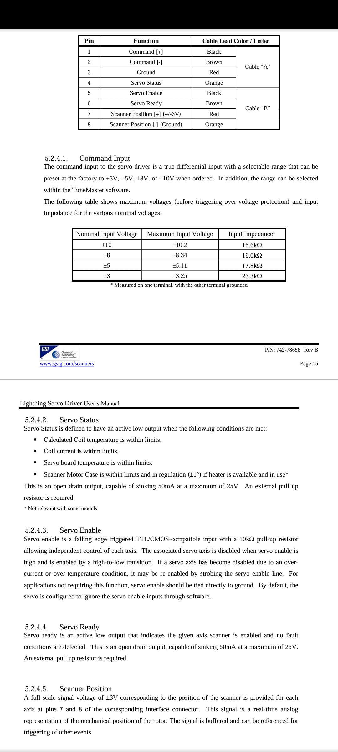

Hello.
I have a xy galvo scanner with analog interface
shown in image.
Can drive it with linuxcnc?
What mesa card needed?
Thanks.
shown in image.
Thanks.

The interface seems unusual..
It doesn't have 1 input that takes +-10v
But 1 input for positive voltage and 1 input
for negavite voltage command.
Also outputs +-3v analog feedback voltage
must read this or only run open loop?
Can mesa 7i77 with linuxcnc meet the strict
time constraints for galvo operation because
i know that timinings in galvo scanners are 1 or 2 orders magnitude smaller than servomotors of cnc machines

That's a standard differential input, it can be wired to a single ended output:
IN- --> GND IN+ -->ANA
I doubt that a servo thread update rate would be good enough for this however
unless you are scanning quite slowly, The XY2-100 interface has the advantage
that it interpolates between LinuxCNCs waypoints, but you lose this advantage
with a simple analog interface.

Can i drive the command+ / command- differential input with 2 opamps
1 inverting and 1 non-inverting with gain 0.5 without using gnd right?
Which opamp ic will be suitable ? lm324 or something better with lower rail voltages ?
Also is there a ready made linuxcnc example configuration for analog galvo control?

You can do that but it doesn't actually gain you anything.
GND --> IN-
and
AOUT --> IN+
will work as well
The real issue will be the low position update rate and the
lack of interpolation between waypoints at the servo thread rate
How fast do you expect to scan this?
GND --> IN-
and
AOUT --> IN+
will work as well
