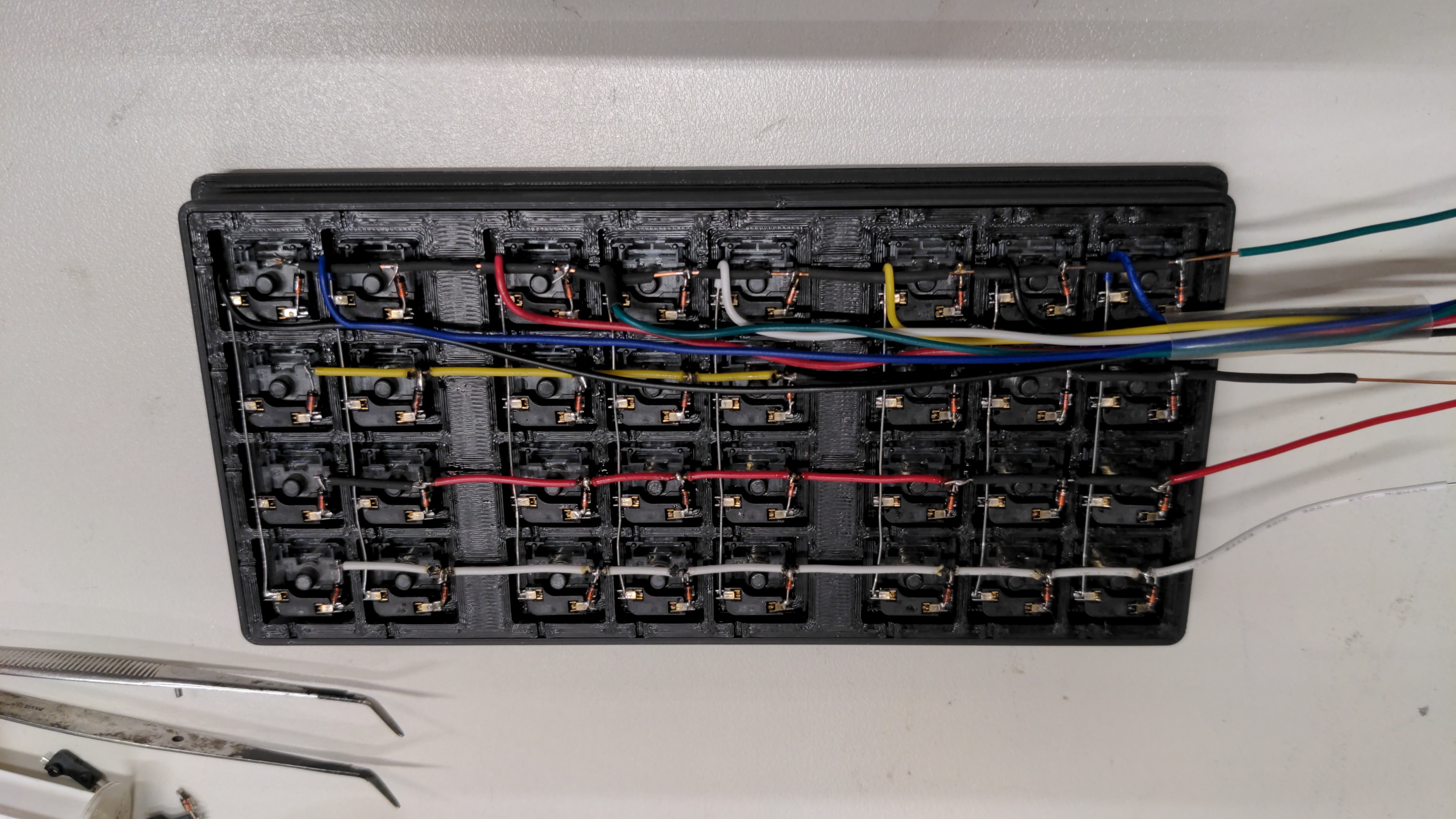

The above is why I asked in your other thread about the multi-key input for the joystick. Was wondering if you figured some way to use diodes so that multiple inputs worked reliably.
If it helps, I've attached a photo of my first 7i73 matrix keypad with diodes (hand-wire, 4x8). Note the rows are at right, columns on top. Diodes point towards the rows as PCW indicated.
The second keypad (current build) I just skipped the diodes.
