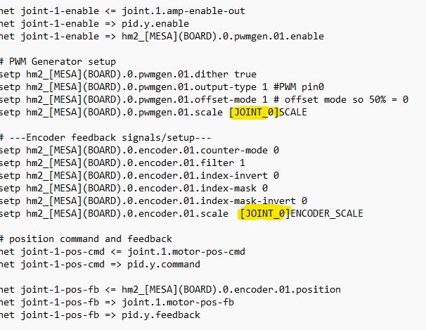

Hi JT. have found an issue with the CT.
using 7i97T. My first joint is fine but subsequent joints do not have the scale referenced correctly within hal txt file.
in the below snip I believe this should say Joint 1
