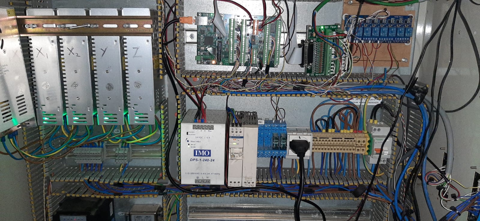

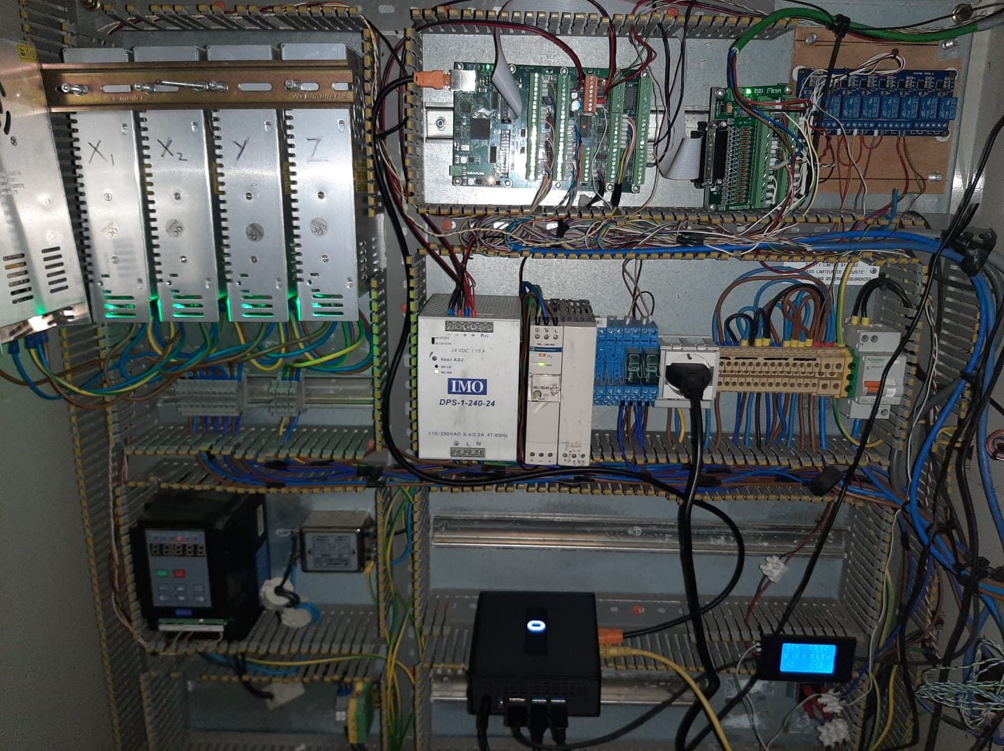

06 Jan 2024 09:51 #289940 by N3pu
Do you have a picture of your setup and wiring? Maybe we can directly see some emi issues. If it's finaly the problem I don't know. No matter what it is I would take care a bit of emi.

06 Jan 2024 10:19 - 06 Jan 2024 10:21 #289944 by EragonPower
Replied by EragonPower on topic Yet another "error finishing read" with mesa 7i76e
Here are two pictures of the control panel, it's a mess, i have to tidy it up a bit, i know
