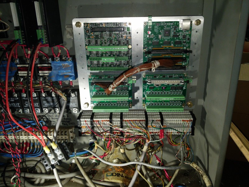

I am cleaning up a converted HNC bar chucker that previously had a 5I23 driving a 7I42TA unbuffered I/O card and the special version of the 7I49 with the high voltage resolver customization. After trying a few different board combinations, I settled on moving all the control and signaling into one cabinet with a 7I80 driving the 7I49 and two 7I37TAs. I was trying yesterday to sort out the firmware, and it appears that there is not one for the Efinix silicon that supports the resolver card.
I downloaded the firmware ZIP file off Mesa's site and unzipped one of the files in the archive containing the Efinix files (efinehm2.zip). The Efinity software takes XML project files, and I am not seeing one.
If there is a project file for this silicon, would someone mind pointing me in the right direction? I have written a great deal of RTL for Altera, Xilinx, and Lattice devices, but this is sort of new territory to me as I have been able to use the "stock" firmware in every other LinuxCNC/Mesa application.
DEBUGSET.ASM DELAYMS.ASM efinehm2.zip ETHEREEP.ASM ETHERFLS.ASM ETHERHM2.ASM ETHERHM2.EQU ETHERHM2.INC ETHERINI.ASM GLOBAL.EQU LBPPARSE.ASM STATIC16.MAC STEPSET.ASM TASMD16.TABIf there is a project file for this silicon, would someone mind pointing me in the right direction? I have written a great deal of RTL for Altera, Xilinx, and Lattice devices, but this is sort of new territory to me as I have been able to use the "stock" firmware in every other LinuxCNC/Mesa application.

efinehm2.zip is the source for the embedded processor ROM that runs the
Ethernet --> hostmot2 code
(not needed unless you want to change the Ethernet interface)
The VHDL source and Efinity project files are in 7i80hdt-hm2-zip or 7i80hdt25-hm2.zip
(7i80hdt25-hm2.zip is for larger projects so has more relaxed timings)
