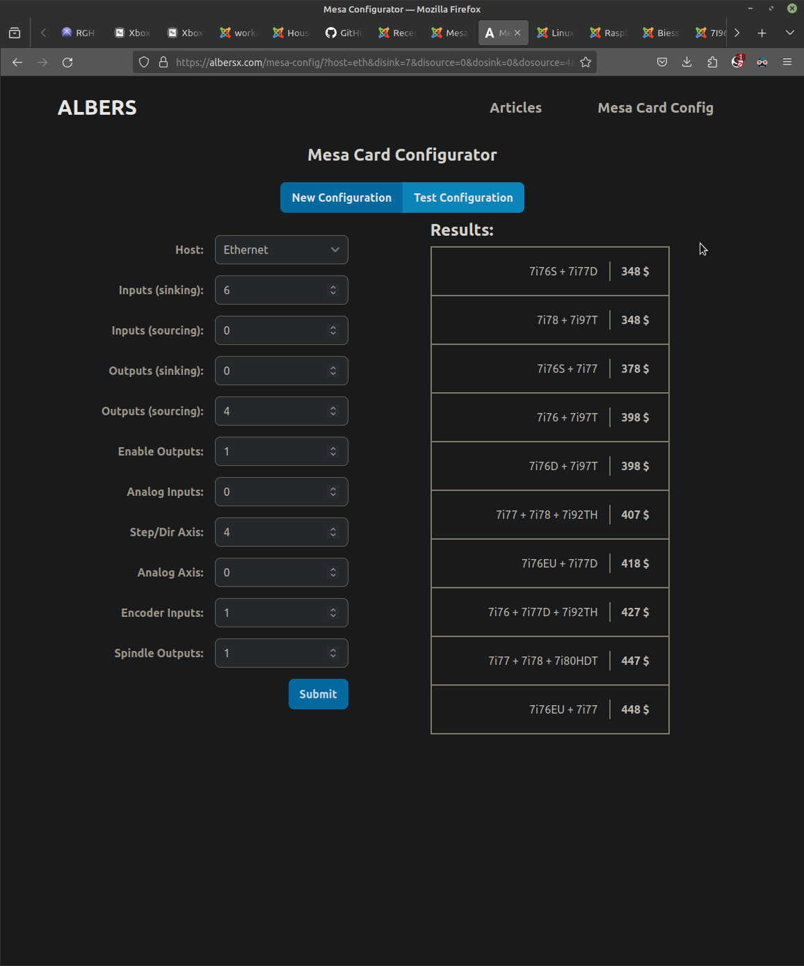

Just did a quick test and found some bugs:
-7i96S is always named 7i76S, should be 7i96S
-see attached, 6 inputs 4 outputs 1 enable 4 stepgens 1 encoder and 1 spindle comes back with 7i76S (should be 7i96S) and 7i77 and all combos using 2 cards, while everything should be only a 7i96S
Nice idea and implementation, though, thank you. And showing connection between cards is also very nice.
Great job!

Thank you, the 7i76S was a typo, fixed now.
The 7i96S doesn't have a dedicated floating enable output, that's why you need a 7i77 which has that. I'm not super deep into that topic, does it make sense to change it so any output counts as enable?

I might be wrong though.
And, yes, i would see any output as enable output.
The only stuff that might require isolated outputs are spindle VFD and Plasma, not always. So 7i96S is good for both.
Again, thank you, this should help a lot.
Replied by tommylight on topic Mesa Card Combination Tool
Pretty sure 7i96S has two (or more) high current outputs and pretty sure they are all fully isolated.The 7i96S doesn't have a dedicated floating enable output, that's why you need a 7i77 which has that. I'm not super deep into that topic, does it make sense to change it so any output counts as enable?

Okay, it seems that the "enable" option causes more confusion than help, I've decided to just remove it so it's clear.
The form was based off spumcos thread, I haven't looked very deep in every cards datasheet.
