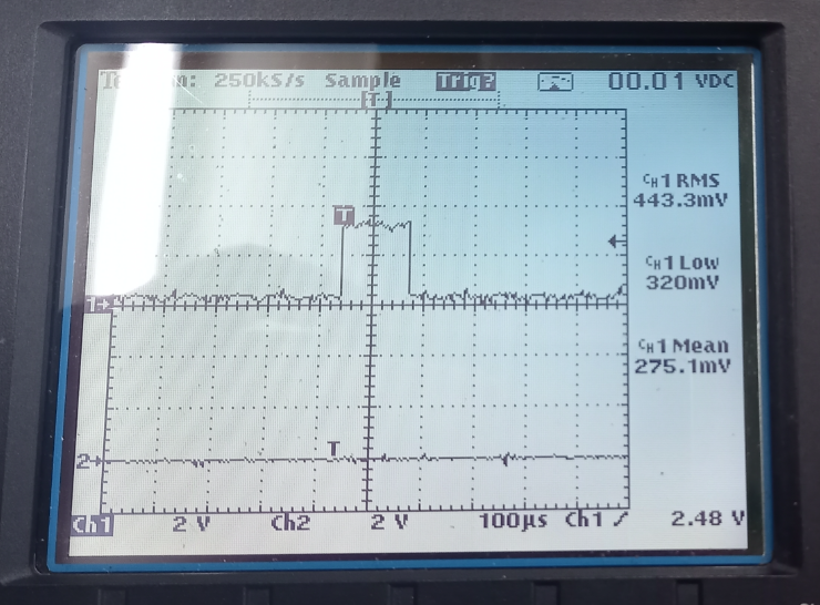

Hello,
Today I ran into a problem trying to connect my spindle encoder via a Mesa 7i77.
The Pin encoder.05.input-index is always shown as high, even when I hardwire that input to ground. See the Picture of the Halscope.
The Index Signal is OK, I confirmed it with my Oszi. I have also tried quadrature mode and single ended mode on both +I and -I inputs, always with the same result.
Could it be that the Mesa card input is somehow fried? This was my first thought but on the currently free encoder 04 it gives the same behavior, but maybe this one is also toast. I did not test any other encoder channels, as there are the four axis connected. No issues there at all.
How is the encoder input-index connected in software? I looked at the HAL pins to see if maybe something else is overwriting that signal, but this isn’t even connected to a net, as far as I could see.
Would it be possible to use a different input (not an encoder input) as the Z-signal, as it is named in the Encoder documentation?

I was using halshow most of the time, there was no reaction on the "LED“ when grounding the index or letting at float at 5V. I just thought a picture of halscope would provide more context. But nice to know that you cannot use halscope for the index signal, or at least not reliably.
I will change the cable tomorrow; I have a second one where a 7i74 is connected.
Depending on the result I will also try a different encoder.

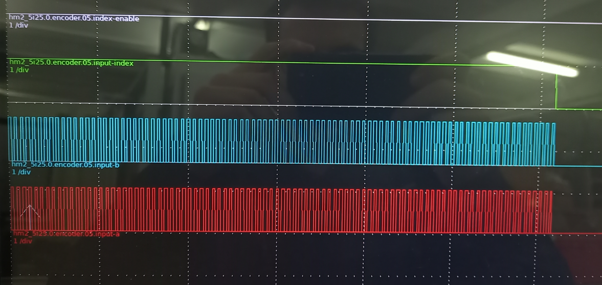

Ok so i tried the following:
-swapping the two DB25 cables
=> sadly no change in behavior (since this would have been so easy to fix)
-changing my C-Axis from encoder 03 to 04 and Spindle from 05 to 03
=> C-Axis now turning endless during homing routine
=> Spindle Index actually visible in halscope on highest sample rate when turning by hand
I also tried (but failed) to rewrite my hal to change between the two DB25 ports on the 5i25 to pin the cause to the 7i77.
Then I created a test machine with PNCCONF to get the 7i77 connected through the internal DB25 port of the 5i25 (P2), but I couldn’t get it to work. After some googeling I now think this is embedded in the firmware of the 5i25, if that is so, is there a firmware where the ports are swapped (7i77 + 7i74)?
See readhmi attachment for current configuration.
What are my options if the 7i77 is damaged. I have a 7i73 laying around waiting to be mounted into a pendant. Can it be used to connect the spindle encoder? Or is there a similar card to the 7i77 without the I/O pins to use for all the encoders and analog signals for the drives?
Last edit: 24 Feb 2024 14:34 by Wieser.

5i25_7i77x2r.bit is a reversed connector version of the normal 77x2 firmware
If the 7I77 is damaged its likely repairable

I checked my current Bitfile (5i25_7i77_7i74) and flashed a file I found (5i25_7i74_7i77) into the fallback area.
After switching the cables around, I now can see the index signal changing in halshow when I ground it.
In this bitfile the "damaged" Pin 13 of P3 is a SSerial. How will this affect the use of the 7i74?
