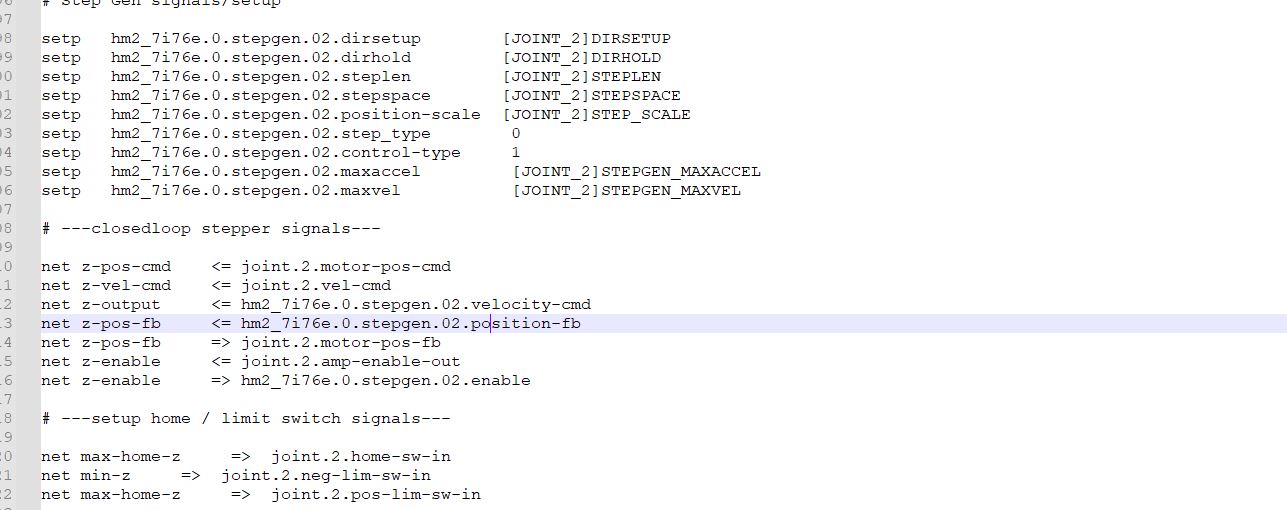

Good morning everyone ,
My 3-axis xyz milling machine is equipped with stepper motors that work properly.
However, sometimes it happens that the Z axis loses steps due to the weight of the axis.
To improve the situation I added an encoder
to the ball screw.
Now I would like to add feedback to the z axis....
I tried to study the linux cnc documentation, if I understood it I'll highlight the lines of the hal file that I should modify.
net z-pos-fb <= hm2_7i76e.0.stepgen.02.position-fb ( actual configuration)
net z-pos-fb <= hm2_7i76e.0.encoder.xx.position (future configuration)
where xx is the encoder number
logically then I will also modify the ini file to scale the encoderAm I on the right path?
Thanks everyone for the help

05 Mar 2024 14:40 #295233
Replied by andypugh on topic mesa7i76e + 7i85s stepper motor + encoder feedback
What you suggest there will detect following errors, but will not recover from lost steps.
You probably need to modify the hardware too. (Bigger stepper, lower gearing, closed-loop stepper, pneumatic countrbalance, something else)

06 Mar 2024 10:56 #295311
Replied by tommylight on topic mesa7i76e + 7i85s stepper motor + encoder feedback
What drives are you using?
The only open loop drives that are capable of actually doing something to compensate for lost steps are Lam Technologies drives, the DS series being the entry level, they have a Boost pin that can be used to send more current (programmable) to motors in case of lost steps/feed error, i did test that and it works properly.
Otherwise, with normal drives if the stepper stalls, sending more steps at the same rate or higher will not help, sending slower rates might help.
Maybe something can be done in hal to stop the stepgen and start it from 0 to try to move again after stall, but i never tried this.

11 Mar 2024 15:46 #295645
Changing the joint feedback source and tuning parameters are needed for encoder feedback.
(along with getting the encoder feedback in the correct direction and scaled properly)
Tuning can be done live using the calibrate menu.
_BUT_ as others have mentioned, simple adding encoders to a step/dir system will not solve a
missed step issue (though it can halt the system if this occurs) This is because when a missed
step occurs, the drive had insufficient torque and skipped one or more pole positions (1/50th of a turn)
Having the controller simply add more steps will not fix this (and least not without slowing the motion
significantly so the torque becomes higher)

12 Mar 2024 08:46 #295724
by Raban
Replied by Raban on topic mesa7i76e + 7i85s stepper motor + encoder feedback
Thanks PCW, it's very clear.
the goal is for the milling machine to stop if for some reason the z axis stalls.
otherwise, a rapid crossing with the z in the wrong position can cause a disaster
