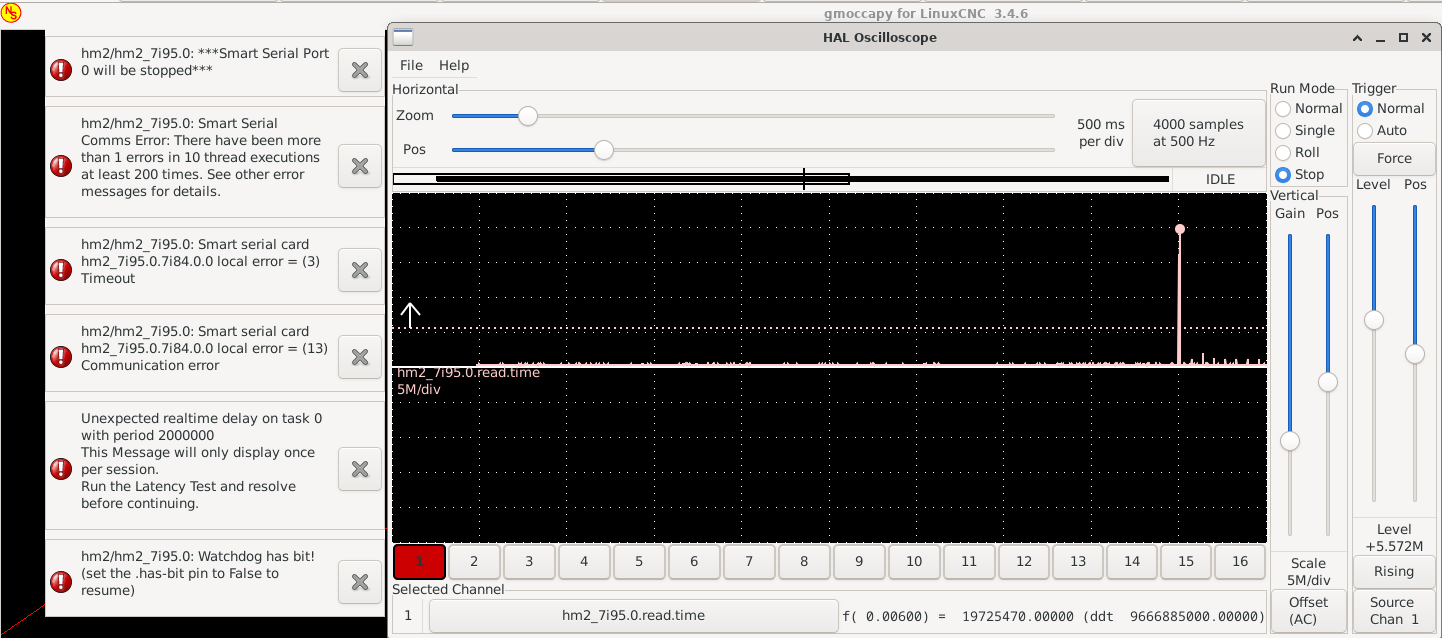

Unfortunately, I have run into issues with ethernet latency, and get unexpected realtime delays and watchdog has bit issues. From monitoring the hm2_7i95.0.read.time, it's evident there are some massive spikes. See the screenshot below and console output from starting LinuxCNC. The highest spike is around 20 000 000, while the base level is around 300 000.

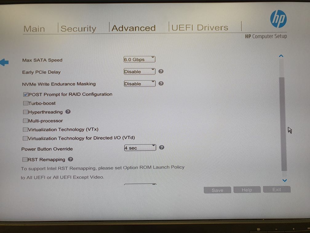

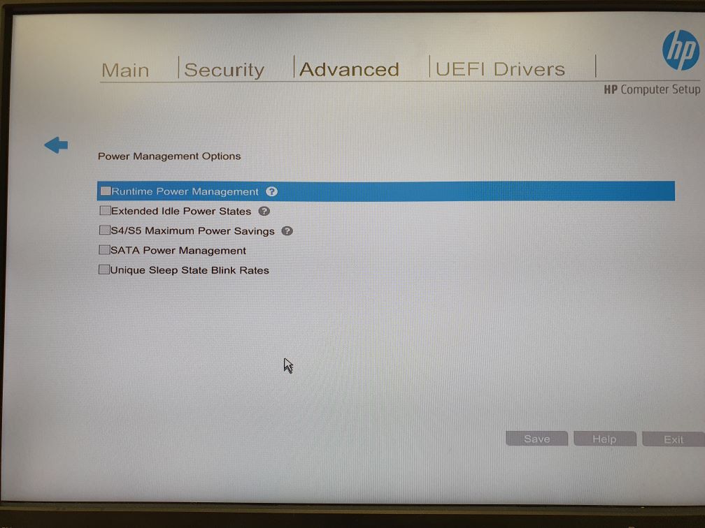

The computer is a HP Z240 SFF Workstation (J9C02ET#ABU) with i7-6700 CPU. I have done quite a bit of reading about other similar issues. The computer has an in-built I219-LM ethernet adapter, that I read somebody else had issues with. So I bought a PCI-e TP-Link TG-3468, which has the Realtek RTL 8168 chipset. But I get the same issues with both cards. And later I read there are also issues with the Realtek chipsets. And it's not easy to find anything else than Intel or Realtek.
I have disable all "performance" and power management features I can find in the BIOS, and modified the kernel options to:Still, no better.

According to some troubleshooting advice by PCM, I also did some ping test:and for a couple of minutes:With a maximum response time of almost 10 ms, no wonder there are some issues.

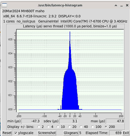

However, the "normal" system latency does not appear bad. Here is a latency-histogram from surfing the web and writing this post, playing youtube and having 5 glxgears running:
I actually used this same computer on 2.8.4 earlier and without many issues. However, I do think I got the same issues every once in a while. Maybe after an hour or so. But that was with no tuning of BIOS or kernel options and with the Intel network card without changing irq coalescing options (if that was at all relevant at that time).
I start to run out of ideas. But maybe somebody here has some advice?

hm2/hm2_7i95.0: Watchdog has bit! (set the .has-bit pin to False to resume)
Unexpected realtime delay on task 0 with period 2000000
This Message will only display once per session.
Run the Latency Test and resolve before continuing.
hm2/hm2_7i95.0: Smart serial card hm2_7i95.0.7i84.0.0 local error = (13) Communication error
hm2/hm2_7i95.0: Smart serial card hm2_7i95.0.7i84.0.0 local error = (3) Timeout
hm2/hm2_7i95.0: Smart Serial Comms Error: There have been more than 1 errors in 10 thread executions at least 200 times. See other error messages for details.
hm2/hm2_7i95.0: ***Smart Serial Port 0 will be stopped***

That is a huge latency spike (almost 6 ms!)

Yes, power management, turbo and hyperthreading disabled in BIOS. I can take a photo later for reference.
However, just after I wrote the post, it occurred to me that for the sake of completeness, I should remove the USB/ethernet dongle I use for internet access. At the same time, I also removed a wireless ethernet card I had installed previously. Lo and behold, after this I have not seen the errors, although it has only been half an hour or so. I plugged the USB/ethernet dongle back in to write this message, and its still not complaining.
I will monitor for a few hours and write a new post with the results. And I will figure out if it was the wireless ethernet card (TP-Link TL-WN781ND) or the USB/ethernet dongle that was causing the issues. And I will check if I can go back to the stock kernel as well. I will report back once I have some more information to share.

The computer was now running for ~2.5 hours without issue, and the hm2_7i95.0.read.tmax was around 900 000. I then turned off the computer and reinstalled the wireless card. And again I get the error messages almost immediately upon starting LinuxCNC. So for me it's quite clear that the wireless card was causing issues for me. And that wireless card was not connected to a network (never even configured to connect to one). Anyway, I never planned to use that card other than for installation/setup, so no problem for me.
I will see what more I can determine. And if the stock kernel will work. But it may be a couple of days before I get the chance to do that.
Thanks for the tmax explanation. So in my case with "baseline" around 300 000, it's just shy of 0.1 ms with 3.4 GHz clock frequency.

I turned off all most "extra" features in BIOS, but maybe went one step too far with that one. (The computer is not sluggish at all, though)
I will re-enable it, and may go a bit deeper with isolcpus and the IRQ affinity/routing to see how that works out:

I enabled multiprocessor in BIOS settings. Without isolcpus and without IRQ rerouting, it did not work great. But when adding isolcpus and IRQ rerouting, the tmax values seem to top out around 1 000 000 (with 10 glxgears and youtube playing). Slightly better results with the Realtek cards than with the integrated Intel chipset, so I will use the Realtek for Mesa communication.
Changing back to the stock kernel caused no issues.
So, the problem is solved. And in the end it turned out to be only the unused Wifi card that I had plugged in. Ugh. I had that card installed in the computer already with LinuxCNC 2.8.4, and did not cause at least big issues then.
