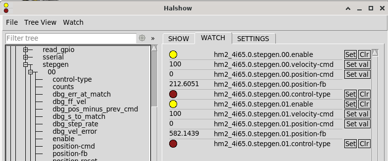

28 May 2024 16:43 #301687
by hardware_crash
Replied by hardware_crash on topic Mesa 7i71 - Stepgen on Digital Output for ATC
Hey Peter,
I tested the firmware you provided.
The 7i33 and the 7i44 + connected SSerial Devices work properly,
but I have Problems getting the Stepgens on the 7i52S to work.
Maybe im getting something wrong, but when entering a value to .postion-cmd, shouldnt the Stepper move?
The Stepper driver is connected to COMM0:
Pin3 TX0A to Step-
Pin4 /TX0A to Step+
Pin5 TX0B to Dir-
Pin6 /TX0B to Dir+
Pin3 TX0A to Step-
Pin4 /TX0A to Step+
Pin5 TX0B to Dir-
Pin6 /TX0B to Dir+
