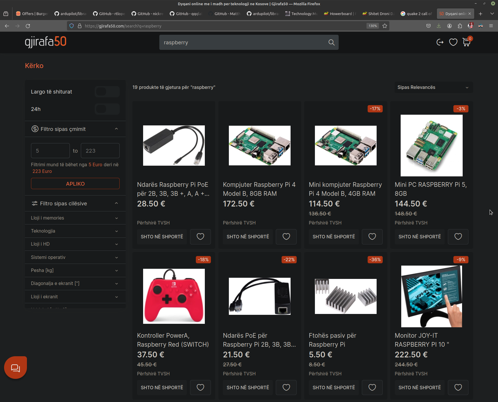

- Posts: 21958
- Thank you received: 7478
09 Apr 2024 01:54 #297840
This is the current actual pricing here, see if you can spot a glaring issue:
Replied by tommylight on topic Low Cost Raspberry Pi Contoller Board
Normally i would ask "where is the price", but given the current state of RPI exorbitant prices, i am skipping it for the foreseeable future.
github.com/cakeslob/RRW_LAB
- Posts: 1200
- Thank you received: 426
09 Apr 2024 03:06 #297841
Replied by Cant do this anymore bye all on topic Low Cost Raspberry Pi Contoller Board
Tommy I can actually believe that, but those prices look really high for both models. The RPi5 "broke" a lot of what works with the RPi4, especially if you want to play with gpios.

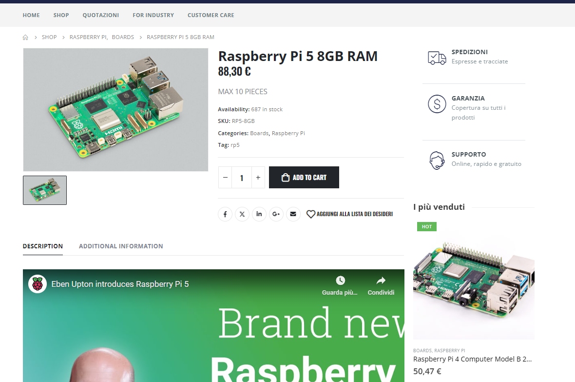

- elovalvo
- Posts: 205
- Thank you received: 127
09 Apr 2024 07:04 - 09 Apr 2024 07:22 #297844
by elovalvo
The prices of that supplier are exaggerated.
This is the site of a distributor in Italy (www.melopero.com/shop/raspberry-pi/raspberry-pi-5-8gb/)
Replied by elovalvo on topic Low Cost Raspberry Pi Contoller Board
Normally i would ask "where is the price", but given the current state of RPI exorbitant prices, i am skipping it for the foreseeable future. :
