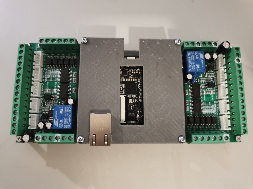

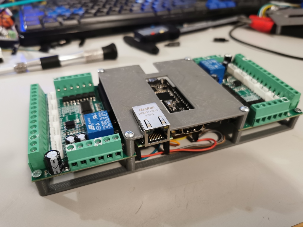

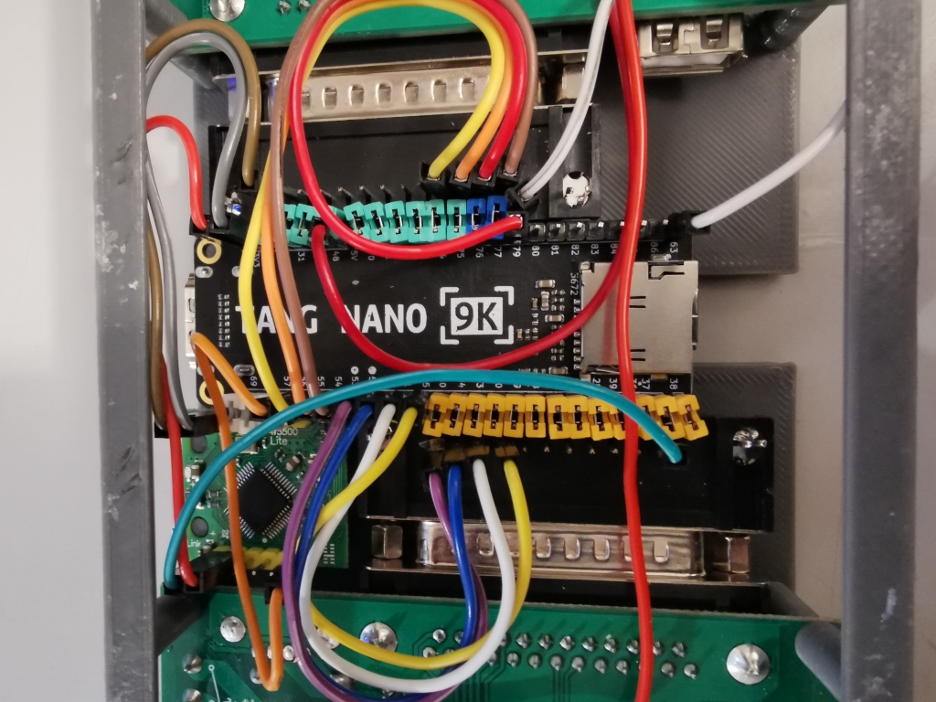

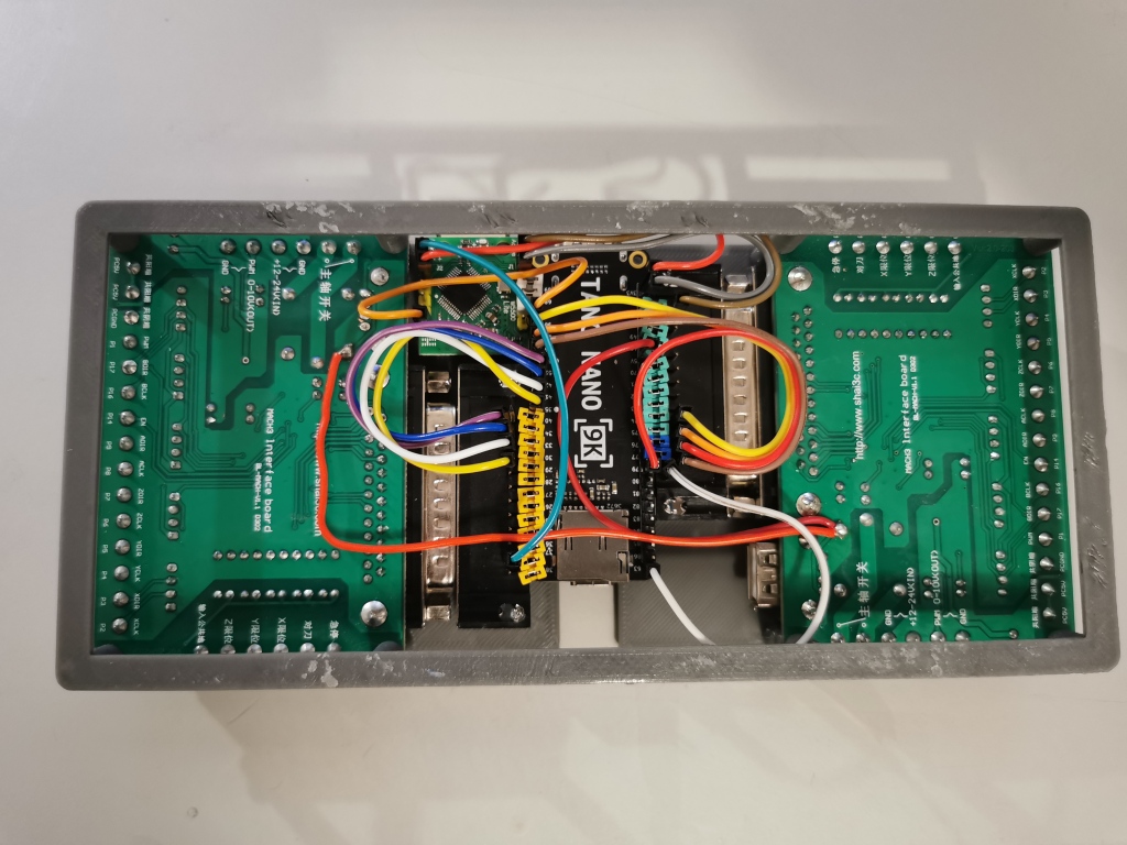

I've seen that setup you mention, or something similar in the LinuxCNC compatible board list. Soldering doesn't scare me, code does, I'm a novice/intermediate coder. What I liked about the Mesa board I have on my router, it was virtually plug and play.
If I can save a few dollars and learn something along the way, maybe I'll give this route a go. I'll have to check into it.
Replied by Project_Hopeless on topic Low Cost Raspberry Pi Contoller Board
For this project 5 step/dir channels and some way to control a 3-wire RC servo motor. I'd go with a 6 channel Mesa card if it wasn't a little pricey and out of stock.How Many Axis do you need
little fun-project, almost without soldering, but works and is inexpensive
