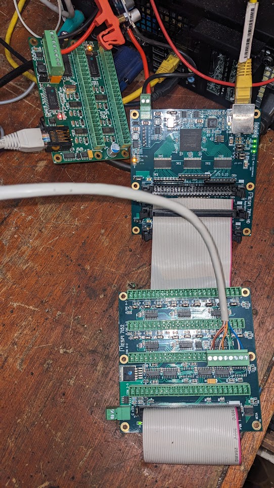

13 Apr 2024 16:43 #298178
by freemoore
Replied by freemoore on topic Magical disappearing 7i84 issue
Hello again.
No luck so far with the setup I need.
I have tested some things on another system with some positives:
Connecting my 7i84 through a 7i94 and using the command:
sudo mesaflash --addr=192.168.1.121 --device=ETHER --sserial
gives me a response from both of my 7i84 cards - they are detected here, showing SwRevision = 14, baud 2.5Mb, NVUnitNumbers etc. So my 7i84s appear to be OK.
I can start up a simple lcnc config using the 7i94, with one pin in use from the 7i84, with no errors.
I can use:
sudo mesaflash --addr=192.168.1.121 --device=ETHER --readhmid
on the 7i80HD, loaded with the firmware you gave me, and get the pinout I'm expecting with SSerial TXData0 on I/OPort 45, SSerial RXData0 on I/OPort 46, and SSerial TXEn0 on I/OPort 47.
However sudo mesaflash --addr=192.168.1.121 --device=ETHER --sserial gives me no response here - not even an enumeration of the SSerial ports shown on the readhmid list. Earlier yesterday the mesaflash...--sserial command used on the 5i23 was giving me a few lines as a response, but seems to have stopped doing that.
What I can't seem to do anymore, is use a 50-pin flat cable to connect a 7i52 to an fpga card, and connect to the smartserial card that way.

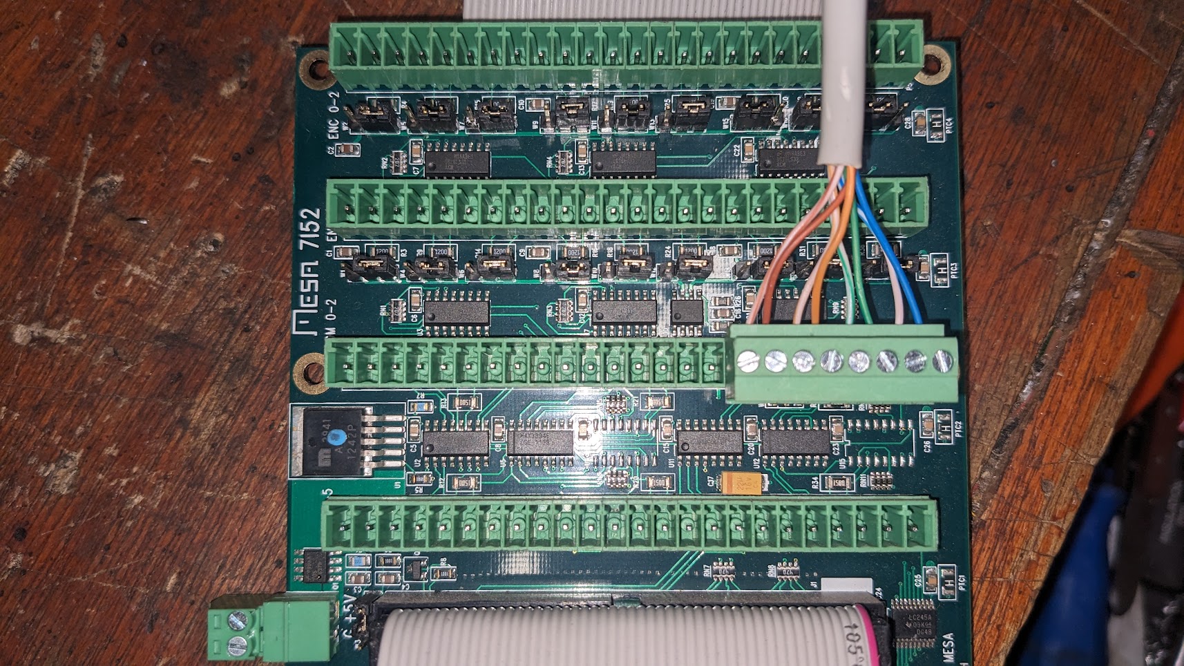

I've checked my cat5-to-terminal wiring a handful of times but still am not sure it's correct. It looks like this:
Also, can you confirm that that terminal block should be plugged into the bottom 8 pin space of P3 on the 7i52, which I think is COM 0?
The likely candidate really seems to be the cat5-to-terminal wiring, but I'm reasonably sure I haven't changed that since it worked!
Have also tried swapping out 50-pin cables, using cable and ext. 5V power for the 7i52, swapping out 7i52 for a spare, swapping out 7i84 for a spare, and as many combinations of these as I can. Properly stumped. I would be grateful if you could confirm the cat5 cable wiring and the correct 7i52 terminal position.

13 Apr 2024 16:58 #298179
Replied by PCW on topic Magical disappearing 7i84 issue
Did you try the I/O health check?
The cable looks correct, maybe make another cable as either end may be flakey
(you can verify with connector location with mesaflash --device ethernet --addr 192.168.1.121 --readhmid --dbname2 7i52)

Oh that's weird, I had replied re the health check but don't seem to have posted successfully. All three gave me the answer 00FFFFFF when I re-ran the test just now. (Oddly, that is not the answer they gave me when I tried previously - that time iirc I got 00001000, 00001004, and 00001008 respectively).
Connector location comes up as P3-5,6 for TXData0, P3-3,4 for RXData0, and P3-5,6:/Ena for TXEn0.
The cable in the photo is one I made earlier today using a fresh CAT5 cable that tested perfectly with an rj45 cable tester before I cut it in half to make the interface cable.
Any further suggestions would be extremely welcome; I have to admit I am at a loss here.

A simple loopback test would be to wire:
RX0+ to TX0+ 7I52 P3 pin 3- -> pin 5
RX0- to TX0- 7I52 P3 pin 4 --> pin 6
and then run
mesaflash [card specific stuff] wpo 0x1004=0 # Set the output latch to 0s
mesaflash [card specific stuff] wpo 0x1104=0xA00000 # Set TX and TXEN pin to output mode
mesaflash [card specific stuff] wpo 0x1204=0 # disable all secondary functions
mesaflash [card specific stuff] rpo 0x1004 # read P3 GPIO bits
mesaflash [card specific stuff] wpo 0x1004=0x200000 # set TX data high
mesaflash [card specific stuff] rpo 0x1004 # # read P3 GPIO bits
If working, you would expect bit 22 (0x400000) = RXData to follow bit 21 (0x200000) = TXData
You might also want to verify that you don't have T568A cables (which have a different color code)
Your connector wiring is correct for T568B
and then run
