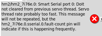

Mesa 7i76 error after xhc-whb04b-6 install

23 Apr 2024 22:13 #298942
Replied by PCW on topic Mesa 7i76 error after xhc-whb04b-6 install
That likely means that your latency has increased for some reason
Is the xhc-whb04b-6 interfaced via a USB dongle or is it a WIFI device?

24 Apr 2024 01:07 #298955
by gardenweazel
Replied by gardenweazel on topic Mesa 7i76 error after xhc-whb04b-6 install
It's just the USB dongle, nothing more.

24 Apr 2024 02:07 #298959
Strange, You might try lengthening the servo period slightly
to see if is improves things or do some of the other network
latency improving changes:
Use isolcpus in grub to isolate the last processor, use idle=poll in grub,
make sure irq coalescing is off if you have a Intel MAC, and finally pin
the Ethernet IRQ to the isolated CPU.

27 Apr 2024 23:52 #299219
by gardenweazel
I have all of that covered. This is becoming a PITA unfortunately. Been running the same kernel and params for ages.
Not sure if anything changed recently but I almost always download the latest code from GIT, compile and run.
Is this something that may have recently cropped up?

28 Apr 2024 00:01 #299220
I would disable the xhc and see if the problem goes away.
Something else unrelated to jog controller may have
changed on the PC
changed on the PC

20 May 2024 19:11 #301025
by gardenweazel
I lengthened the servo period and it worked flawlessly.
Thanks for the help!!
