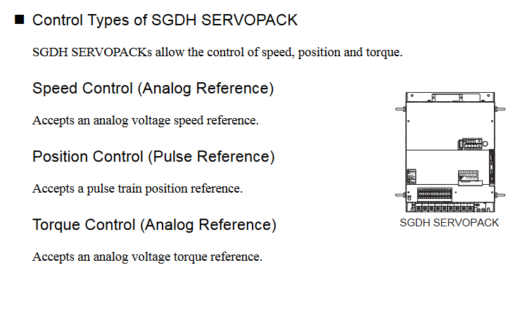

Hello everyone, this is my first real cnc re-build so please correct any misconceptions I might have, I'm excited about the possibility of converting to running with Lcnc, But I wanted to run past my machine configuration in front of some more experienced eyes before making any mesa purchases.
Currently there are three axis being used for motion and a fourth being used for rotating the toolchanger carousel, all are servos running analogue. I am considering removing the servo being used for the atc and replacing it with a stepper, so I can then use the servo as a fourth axis. The motion servos Amp seems to be capable of running step or ana, (or maybe not, see attached img from the servopack manual) but I know for sure that the fourth servo is ana only. This seems to lock me into using something like the 7I97T but I am also seeing daughter boards like the 7I36 that seem like they would allow me to use something else. so I am really wondering what Is the best way to use a mixed ana servo/stepper setup as far as mesa cards (if its even possible) or if its something I should just abandon and get another amp and servo in the future if I want to do fourth axis. I am also going to be needing a reasonably large amount of IO for the pneumatics system, six outputs at a minimum but more is better, so if I was going to use a daughter card it might be for that.

That gives you 5 axis step/dir, 5 sserial for expansion, analog out (not sure if 4 or 6), and 4+1 encoder inputs
By far the most flexible combo, and the cheapest one, too.
If you do need more IO, just add 7i84 (32in/16out) or a set of 7i70 (48 in) with 7i71 (48out sourcing) or 7i72 (48 out sinking)

That configuration sounds good but after using the config tool linked above I am slightly favoring the 7i77 + 7i96S for the additional IO/less cards/similar price. Is there any reason that's a bad idea?
another question I have after reviewing the 7i96S Documentation is about the analogue spindle interface. my spindle controller is expecting to see a voltage between 0-10v for the speed reference, the 96s Docs say "The voltage supplied between SPINDLE+ and SPINDLE- must be between 5 VDC an 20 VDC" this is referring to the voltage between spindle- and spindle+ ( ie 0 to 10 is a change of 10 and so fine) NOT the voltages that spindle- and + must fall between (ie spindle- being 6 and + being 15) right? In other words 0-10v for spindle-+ should be no problem right?

Yes, the total voltage between SPINDLE- and SPINDLE+ must be between
5VDC and 20VDC for proper operation so 10V is fine.
The spindle output is isolated so it only really cares about the difference
between the SPINDLE- and SPINDLE+ pins. That is, it's it not referenced
to any other voltage on the card.
