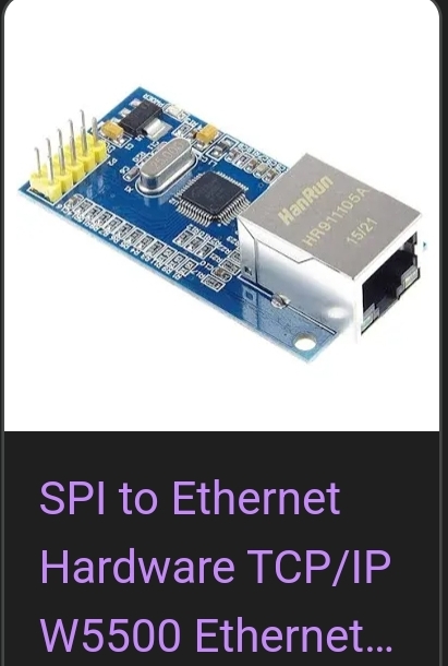

I have tried to complie ethernet branch of remora for octopus pro v429. Accordingly for stm32f429. Its compiled successfully.
Don't know how to wire it with W5500?
My w5500 module is like this.

the 429 builds, but doesnt run. i copied stuff from grblhal, but they have an open issue about it, you know the one, so we both have the same issue. im gonna try and copy it from marlin instead
github.com/cakeslob/Remora-STM32F4xx-W55...M32F429VGTX_FLASH.ld
but the pio config for the 429 i havent setup, and some of the pins are hard coded, so the one you compiled will go somewhere inconvenient. but if you are still gonna play with it, dont do it with hardware attached.
github.com/cakeslob/Remora-STM32F4xx-W55...2/platformio.ini#L88
this needs to be configured a bit better for the spi,
github.com/cakeslob/Remora-STM32F4xx-W55...b/bp2/Src/spi.c#L168
the spi pins
github.com/cakeslob/Remora-STM32F4xx-W55.../Inc/w5x00_spi.h#L18
this is where the cs pin is hardcoded
but im going to strongly recommend you just keep using the Rpi one, if you want to get your machine working. the ethernet one, you will probably need to lower your pru_freq, and there is no encoder or estop module, so you will need to use IO for that.
