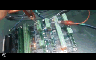

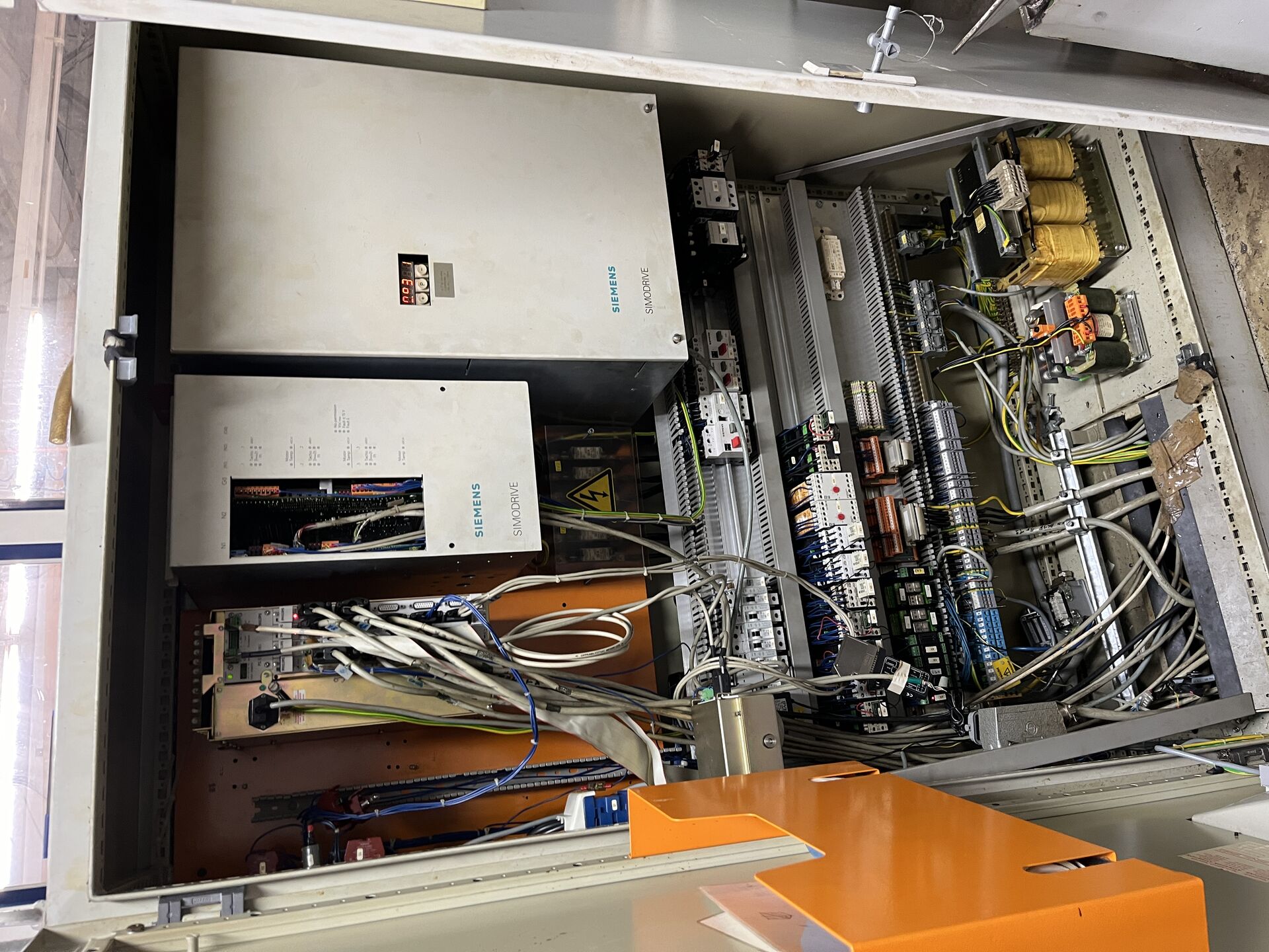

09 Sep 2024 20:15 #309782
by Masiwood123
my friend just repaired the 7i77 that I had and broke it with a short circuit (he says it's a dc-dc converter), in case it's successful, I'll try to connect it with the 7i96s...my question is, in that case, can I use the spindle output and encoder from 7i96s plus mpg and I/o, and with the 7i77 also use the I/O plus analog signals for the drivers (siemens amplifiers)?
Replied by Masiwood123 on topic 7i96s +7i83 trough 7i44 is it possible?
