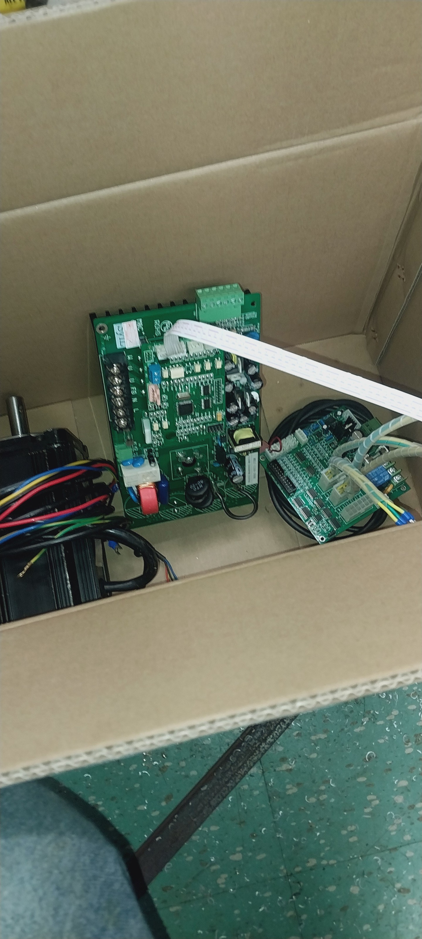

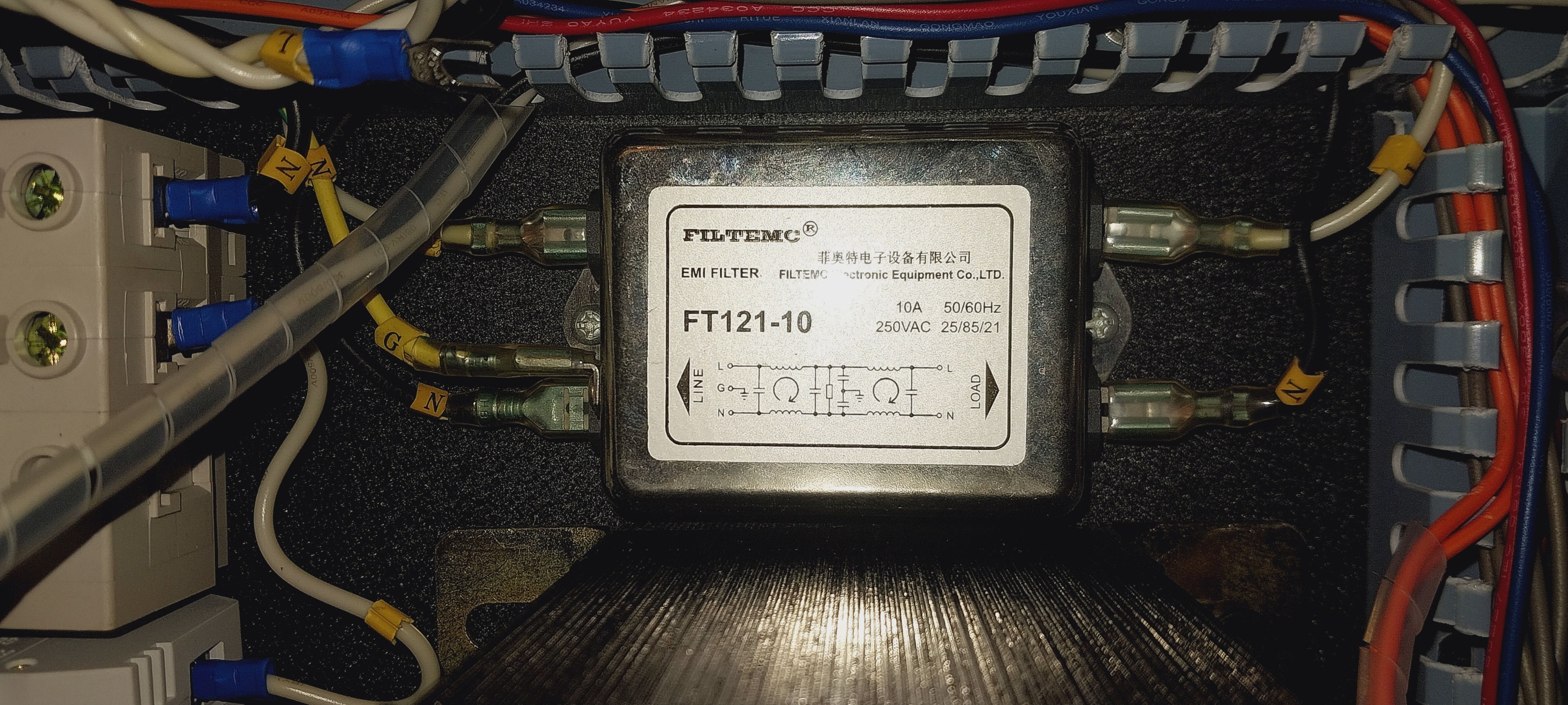

How’s it going, I had a couple quick questions was hoping someone could help understand? So I just went ahead and halfway completely gutted the cabinet on my older Syil X4 machine because I’m jealous of everyone else having nicer machines than mine and wanted to perform a couple upgrades. The goal is to replace the factory spindle drive and the main control board. Anyways I came across a component that was connected to the power supply of old spindle drive and was wondering if its necessary to keep it installed or can I completely remove it? What is this thing?

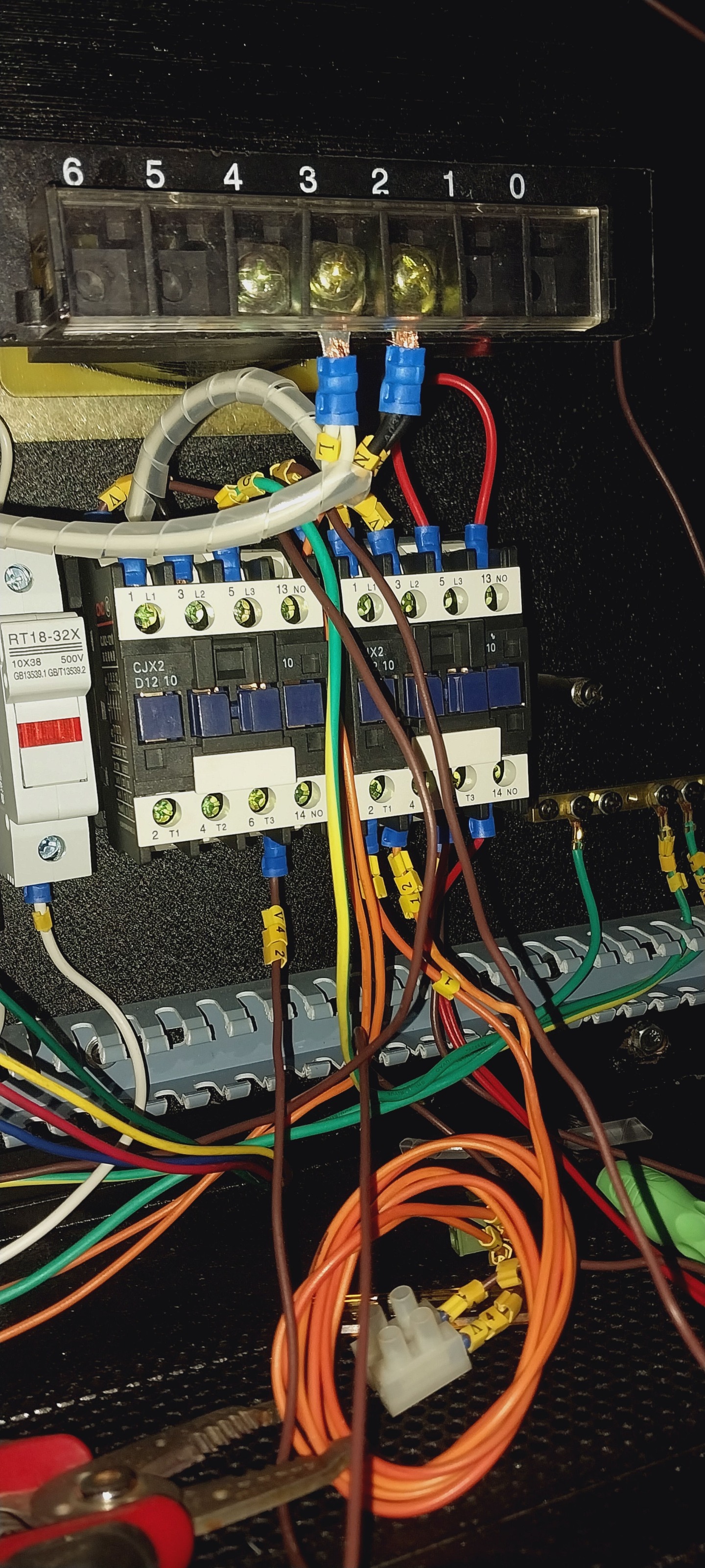

Also, I noticed there were two of these relays. One turns on when I first flip the main power switch on the machine then the second one flips on once you boot the laptop or connect the parallel port cable with the laptop on. Is it necessary to have two of these still or can I just run one only?

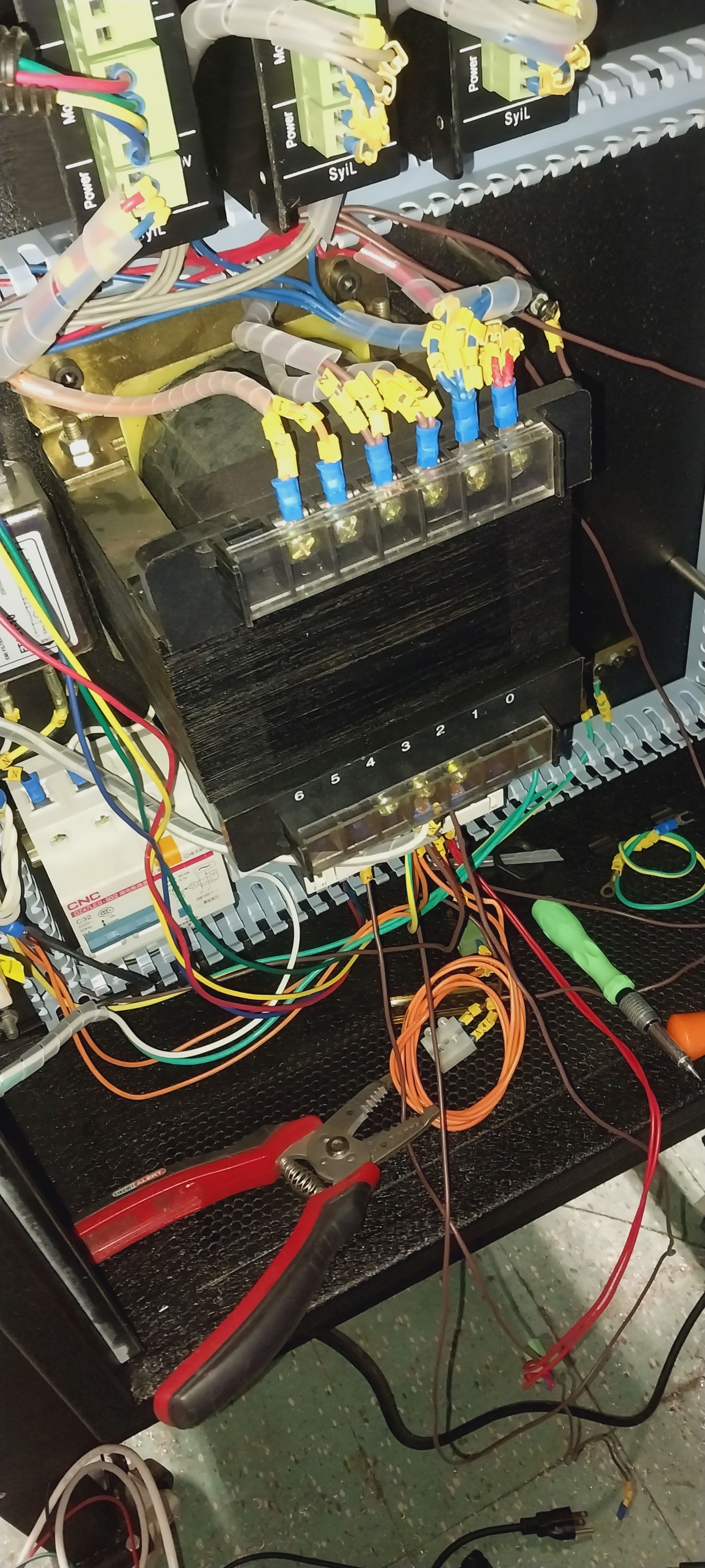

And a last question, is there a smaller transformer I can get to run all the axis drives? This one seems kind of bulky and runs the 3 axis’s X,Y,and Z. It has outputs for 40v(The drivers use) and 24V(The controller board uses). Is there a smaller one I can get for it that’s compatible with 220v single phase?
And a picture of all the stuff I’ve pulled out so far for replacing.

That is a line filter and i would leave it for sure.
Wiring everything mains powered through it is also a good idea, if the total current draw is under the rated 10A.

The "relays" are actually contractors
Pretty much the same.thing but designed for higher currents. Correct term may help you if need to search in the future
