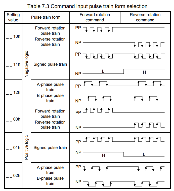

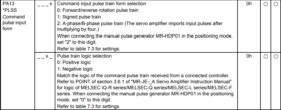

Can the 7i96s card handle CW +/- and CCW +/- instead of step/dir?
I need to control a Mitsubishi mr-je-40a servo drive I
The drive smarter then me, so, I'm not sure... Maybe the servo can the step/dir too, but not figured it out yet how.

30 Dec 2024 12:20 #317673
Replied by tommylight on topic MESA 7i96S STEP DIR I/O compatibility
OK the drive does all 3 types and so does LinuxCNC with Mesa.
Drive modes from your pictures are:
0 = up/down step pulses
1 = step/dir
2 = quadrature
LinuxCNC modes:
0 = step/dir
1 = up/down
2 = quadrature
linuxcnc.org/docs/html/man/man9/stepgen.9.html
