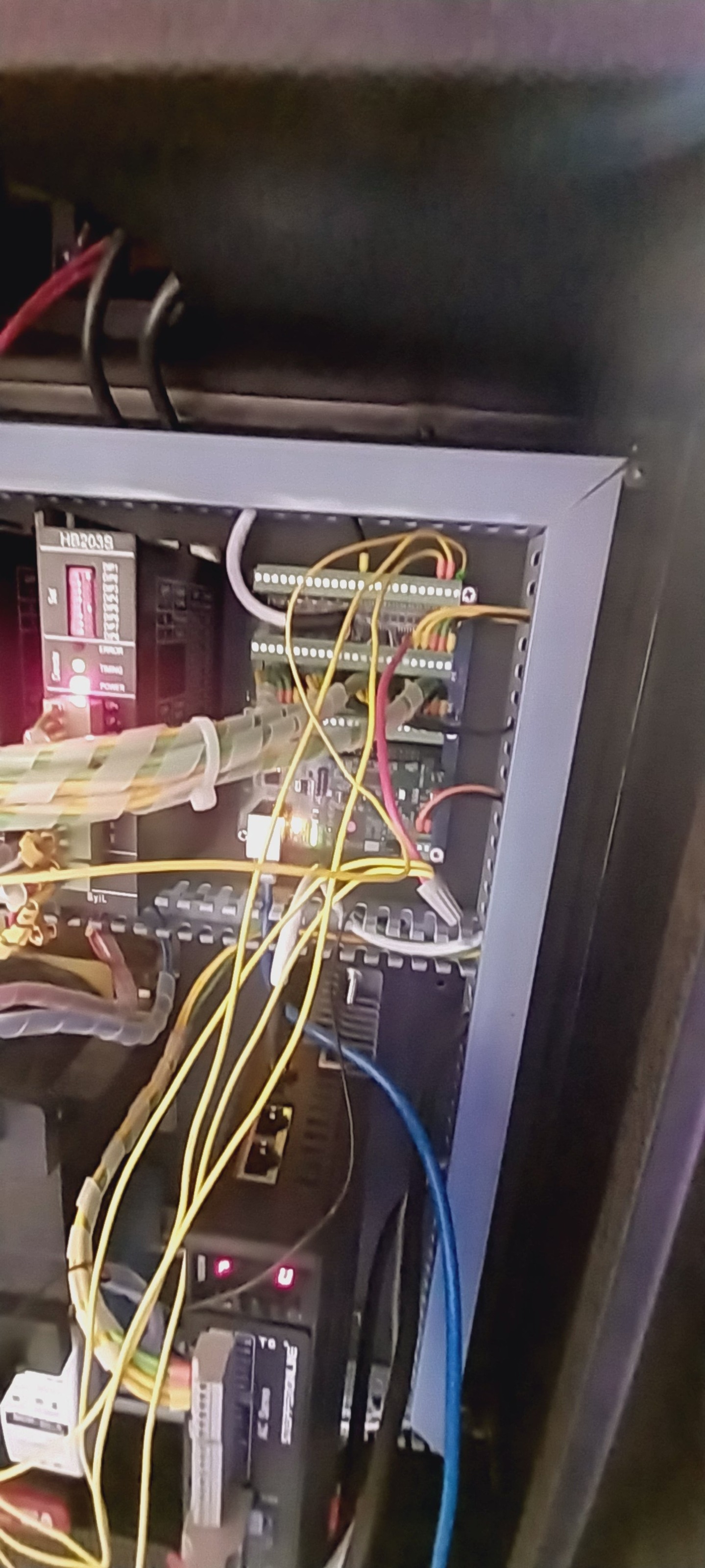

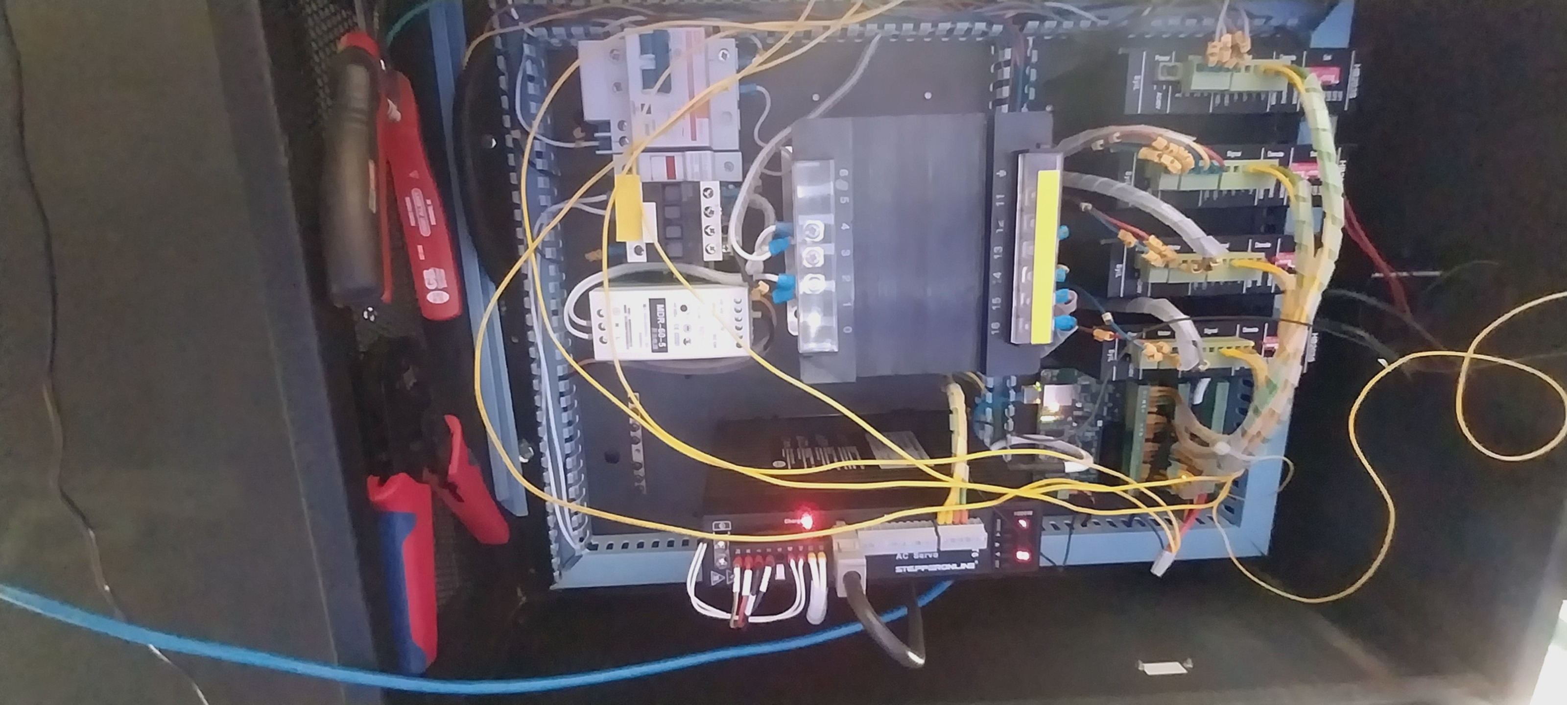

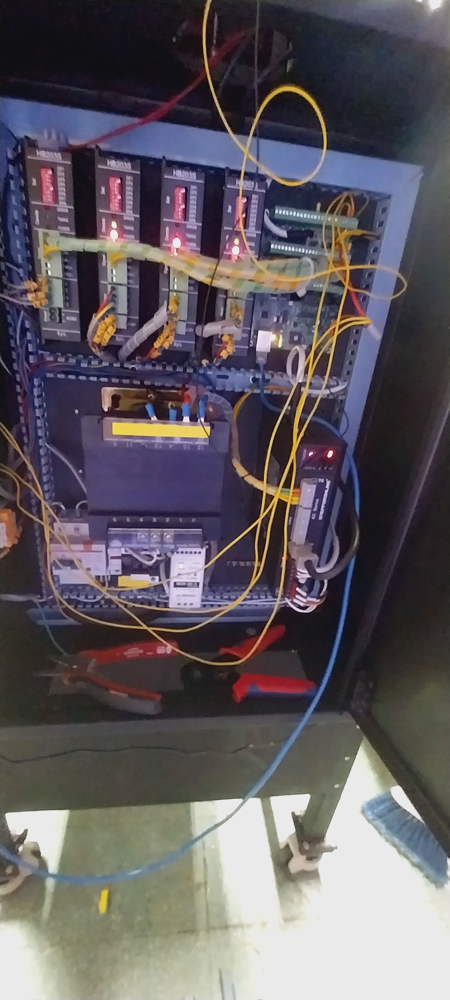

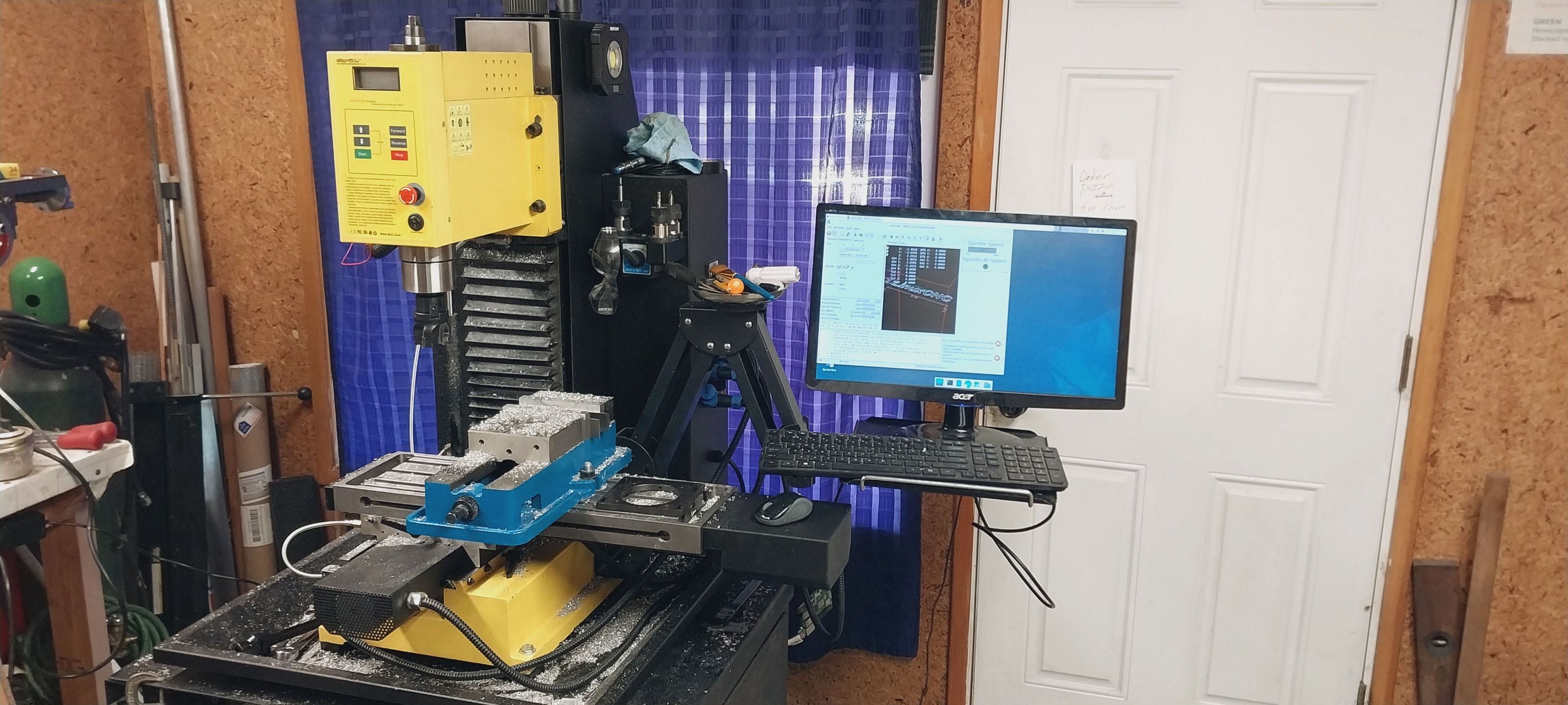

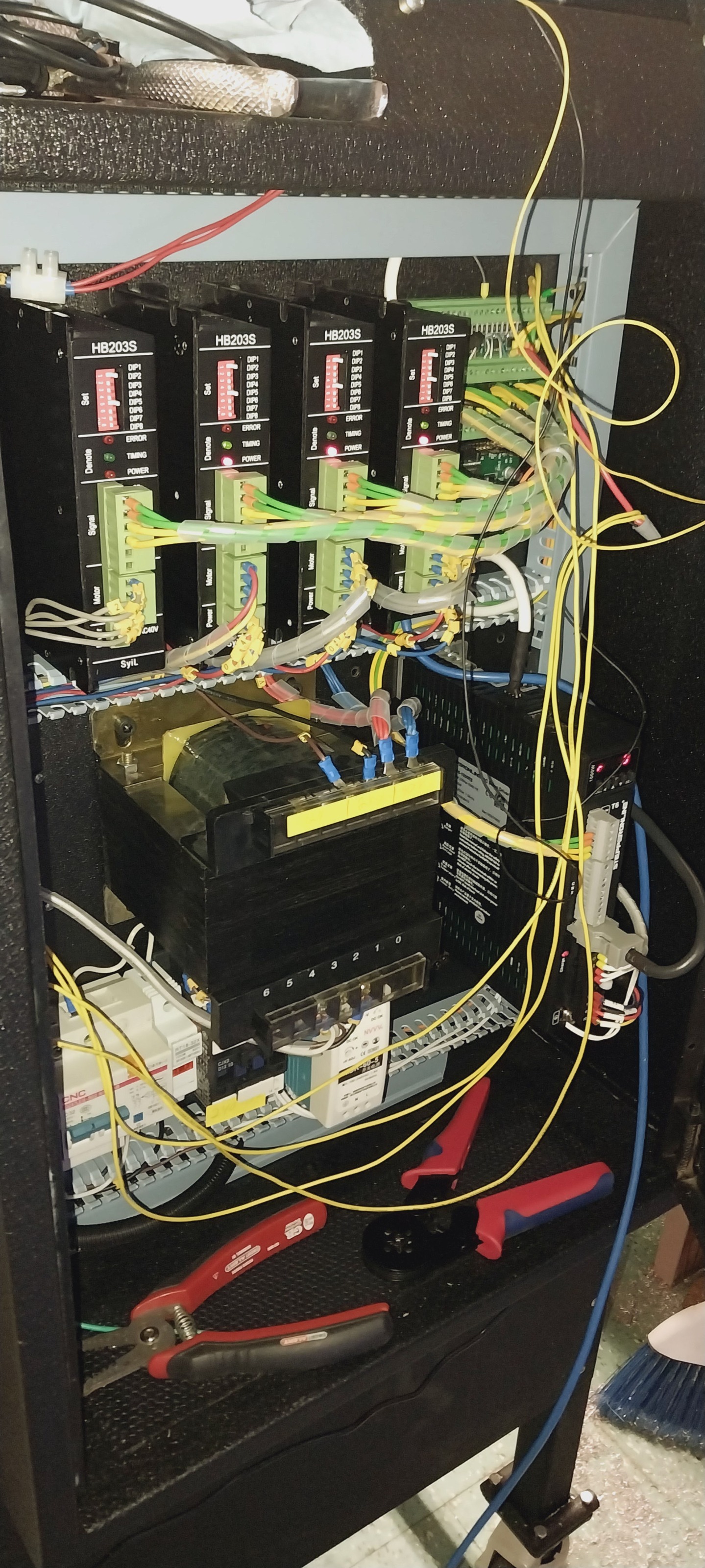

Hey I'm so happy rite now I just have to show my appreciation for what I've got! First off I want to thank PCW for being a genius and creating the Mesa board. I also want to thank TommyLight for the inspiration to make a goal of fixing my machine. It originally had a spindle issue and sucked at properly functioning as a PMW based VFD. So replaced it with a T6 from StepperOnline threw it in the case and slapped a Mesa 7i96 to in and it fired rite up with no issues what so ever! Anyways I'm so proud of this and want to let everyone at LinuxCNC know that I really appreciate all this!
If there's anything I can do to help or contribute to the awesome CNC movement let me know.
Lol, a quick question. How do I speed up the homing function on each axis? Thanks

11 Jul 2024 16:38 #304928
2. increase HOME_LATCH_VEL
3. think about homing two axes (eg X and Y) at the same time (by assigning the samenumber)
Replied by Aciera on topic Appreciation to the Mesa board
1. increase HOME_SEARCH_VELHow do I speed up the homing function on each axis?
HOME_SEQUENCE

11 Jul 2024 17:57 #304935
Replied by tommylight on topic Appreciation to the Mesa board
Also, if you have HOME_FINAL_VELOCITY set at 0, change it to something reasonable, otherwise it does the final move at max velocity.
I am happy that you are very happy with the machine, just watched the video.

13 Jul 2024 03:17 #305047
by Dave2024
Replied by Dave2024 on topic Appreciation to the Mesa board
Ok great thanks. The machine is now homing quick and looks awesome! I also set the X and Y to use the same HOME_SEQUENCE and is great. Thanks
