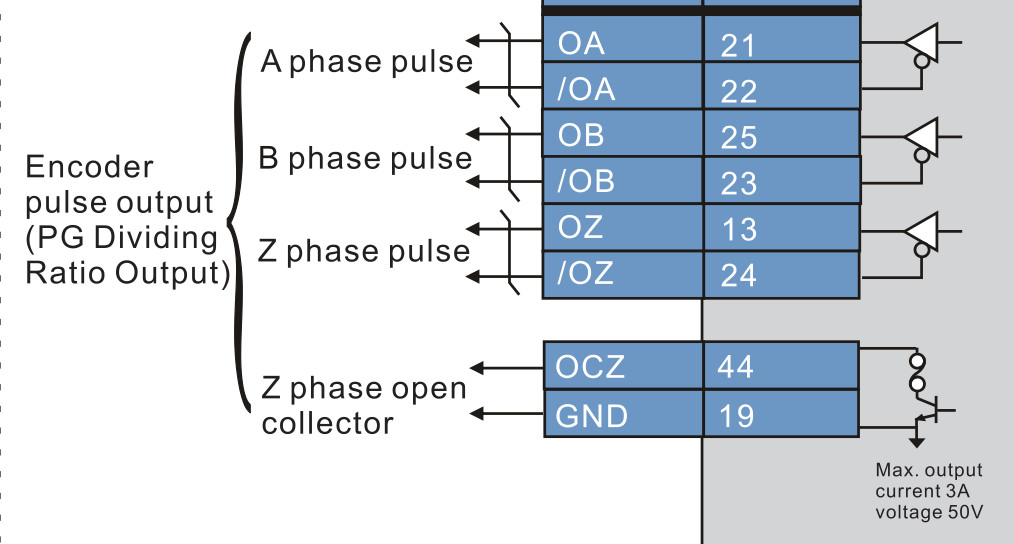

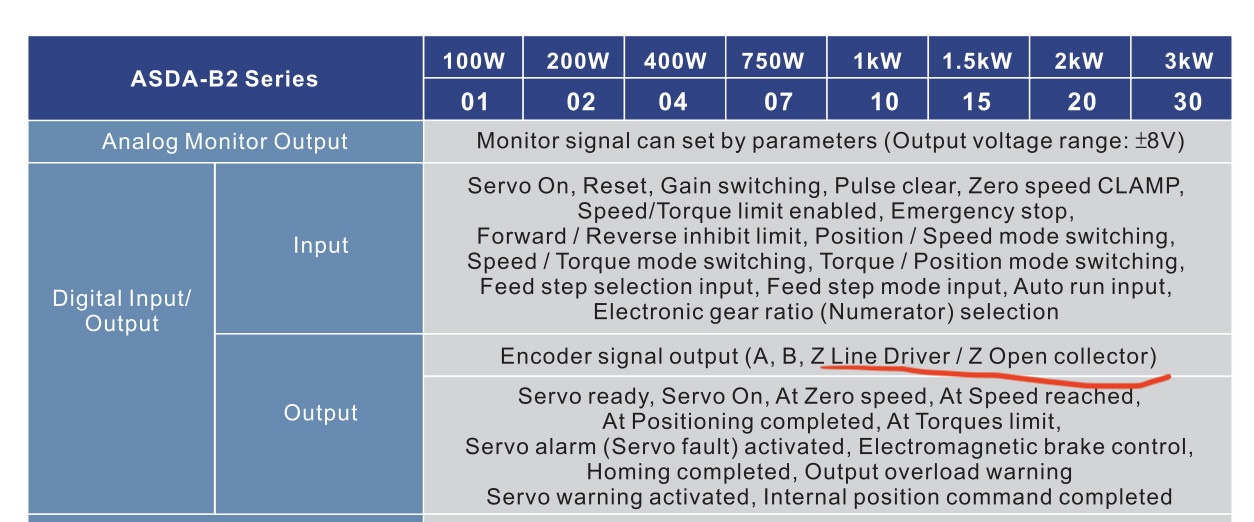

So, as for the question about signal levels for the B2 servos' Z pulse, I am honestly a bit daft when it comes to eletronics and don't even yet have a grasp on when a signal is digital vs. analog...
I can only find a mentioning of: " Z-phase Differential Signal". Not sure if that's what you're after. And then some screenshots from the manual:

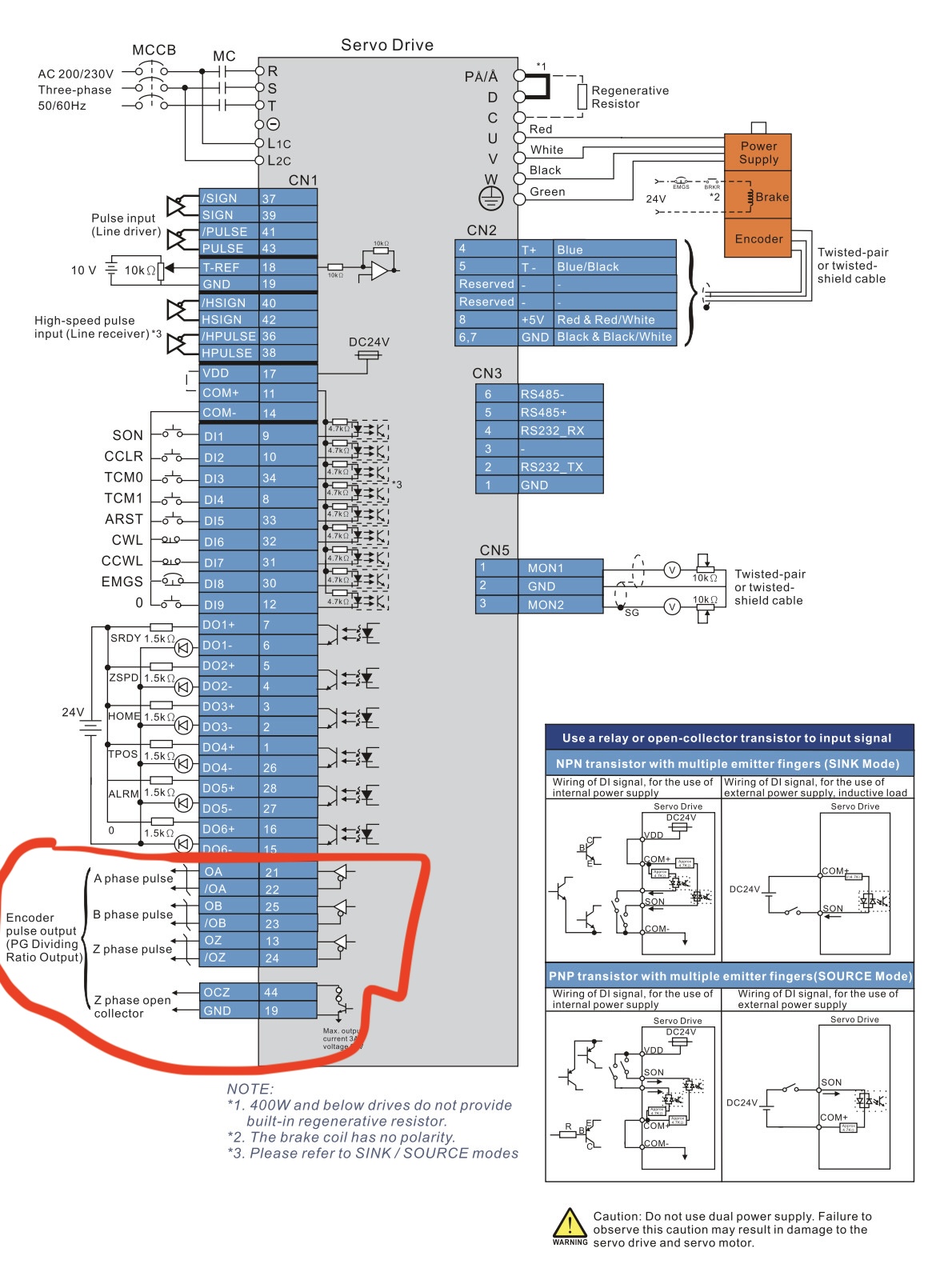

So, I attached some screenshots from the Delta servo manual a few posts above but don't know if they answer your question about the Z pulse signal levels.
Also, I tried to do an updated IO list below. Kinda worst case scenario for now, though. But given the list, which daughter card would you recommend?

Ok I think you've got a differential encoder. Differential encoders will use 6 wires but you can also configure them to only use 3 if you wanted being single ended. The wires will be A+, A-, B+, B-, Z+, and Z-. Sometimes the encoders Z will be called Index or I. So it would instead of Z+ and Z- its I+ and I-. There both the same I and Z. If you get the Mesa 7i96s theres a jumper called W3 that you can change the boards encoder input from single ended(3-wire) to differential(6-wire). They come out of the box already set in differential so you wont have to move it. Differential is what you want anyways its more accurate. Also sometimes this differential and single ended terminology is called biphase encoding. Theres like four different kind of encoding signal/protocols its all really complex and is difficult to understand sorrySo, as for the question about signal levels for the B2 servos' Z pulse, I am honestly a bit daft when it comes to eletronics and don't even yet have a grasp on when a signal is digital vs. analog...

So, perhaps to get homing to the Z-index pulse working, I just need two wires, maybe 1 In pin only, maybe 2. But since I think I will be needing an extra board with more Ins anyways, perhaps this is less important now. And the part about actually making this work can come later - it will take a while to get the boards here anyways.
I've been digging a bit deeper in the manual and if I really needed to save on pins or somehow wanted to move some tasks out of Lcnc then I could actually have the servo drives do the homing themselves. The limit switches would then also go to the drives and I guess just one dig out and one in to basically tell the drive to start the homing routine and then an in to receive a signal that it was completed.
But I think I want to keep as much as I can in Lcnc so just waiting for PWC to confirm which daughterboard he thinks is the right one (or anyone else with the overview). I am just dreading the whole sourcing/sinking question right now as it may impact which daughterboard I'd need...
