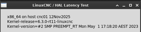

14 Nov 2025 04:43 - 14 Nov 2025 04:59 #338351
by Jensner
Replied by Jensner on topic "error finishing read" with Mesa 7i92T on fresh install
I also did a fresh installation on a DELL Optiplex 3060 Micro PC (RTL8111/8168/8411 PCI Express Gigabit Ethernet Controller)
Everything incl. IRQ-Optimizing (Latency) works fine, but i also run into this error "Error finishing read" with my MESA 7i96s.
In my old installation (at this PC) i run the 3.6.0 rt11 Kernel and did not have this problems, so i think, last time i updated it for the same reason. Sadly i don`t know how to do this update again.
Is there an easy way only updating the kernel?
(Sorry but I`m not in the Linux-Space, so its a little hard for me)
Thanks a lot
Jens
--- 10.10.10.10 ping statistics --- 46085 packets transmitted, 46085 received, 0% packet loss, time 46101ms rtt min/avg/max/mdev = 0.050/0.062/[color=#e74c3c]3.014[/color]/0.039 msIn my old installation (at this PC) i run the 3.6.0 rt11 Kernel and did not have this problems, so i think, last time i updated it for the same reason. Sadly i don`t know how to do this update again.
Thanks a lot
Jens

14 Nov 2025 11:03 #338365
by Jensner
OK, after 2 hours of testing, the error appeares again...
Someone who can help me..
Best regards
Jens
Best regards
Jens

14 Nov 2025 12:07 #338371
by Jensner
I did a nother check in my BIOS and maybe i did annother improvement.
The ping performance looks mutch better then before.
Maybe this could solve the problem.
Fingers crossed...
Jens
120393 packets transmitted, 120393 received, 0% packet loss, time 120405ms
rtt min/avg/max/mdev = 0.049/0.106/0.306/0.031 msMaybe this could solve the problem.
Fingers crossed...
Jens
