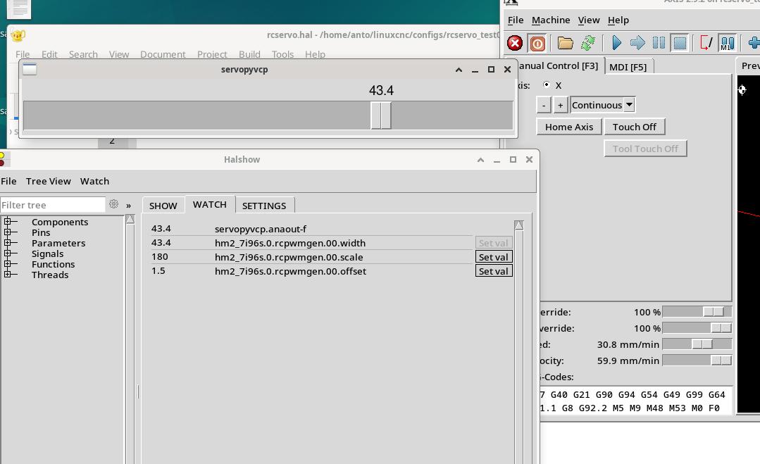

I'm struggling trying to get the HAL setup correctly. 1st the vBox slider value doesn't appear to be scaled.
Are the controls for rcpwmgen only rate, width, offset, and scale?
What am I missing, seems like a simple control

That should be sufficient
(if your RC-servo has a 1.5 ms center value and 1 ms is -90 degrees and 2 ms is +90 degrees)

After some time away I got this working with the 7i96_5abobrcd firmware. The physical pins DB25 vs. HAL pins had me twisted around.
Just a general question, on this function. To get the servo to physically rotate 180 degrees (+-90) I need a scale of 95. 180 gave ~90degrees, and 90 gave ~190-200 degrees. Is this just the variability of the servo potentiometer?
setp hm2_[MESA](BOARD).0.rcpwmgen.rate 50setp hm2_[MESA](BOARD).0.rcpwmgen.00.width 1
setp hm2_[MESA](BOARD).0.rcpwmgen.00.offset 1.5
setp hm2_[MESA](BOARD).0.rcpwmgen.00.scale 180Just a general question, on this function. To get the servo to physically rotate 180 degrees (+-90) I need a scale of 95. 180 gave ~90degrees, and 90 gave ~190-200 degrees. Is this just the variability of the servo potentiometer?

I would expect you use a scale of 180
and get 90 degrees for a value of 90 (2 ms width)
and -90 degrees for a value of -90 (1 ms width)
You could also set the offset to 1 and then use a 0..180 value
to get 1 to 2 ms
to get 1 to 2 ms
