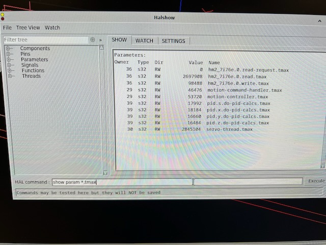

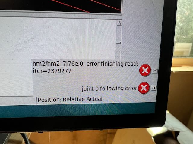

Hi All,
I'm getting an Error Finishing Read after a couple hours of run time on a Dell OptiPlex 9020.
I followed Rod's Google doc (Nice job!). I've also rattled the ethernet cable while running and routed it away from some noise sources.
It is not shielded cable. I believe it's an Intel NIC.
I've included some images which show values from questions in other threads.
Any suggestions?
