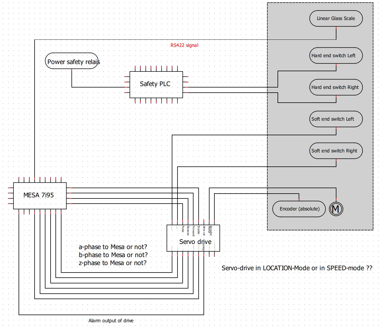

11 Jan 2025 14:54 - 12 Jan 2025 09:00 #318691
by Willemsjos
Replied by Willemsjos on topic Hardware advise mesa boards for control-loop with motor-encoder and linear scale
Hi.
I would like to come back to you about the best way to have a closed loop with a linear scale and a servodrive-motor combination (which has a closed loop already)
Please take a look at attached picture.
The motor has an encoder which is connected to the drive.
The Mesa-board sees the exact position of the table, and should keep giving commands to the drive, untill position is reached. (I expect)
The loop between motor-encoder and drive is the fastest, and not influenced by any speed of the Mesa.
What is your opinion of the considerations I have:
1. Is it smart to use the drive-outputs of the encoder to the Mesa-board? (And for what purpose)
2. Should I controll the drive in POSITION-mode or SPEED-mode?
Thanks, and with kind regards.

11 Jan 2025 16:20 #318694
Replied by PCW on topic Hardware advise mesa boards for control-loop with motor-encoder and linear scale
I don't think there is much advantage to returning the rotary encoder
data to LinuxCNC. I think for the uses of the linear encoder position mode
is OK, basically the linear encoder would be of most use compensating for
ball screw errors and thermal expansion which can be handled by LinuxCNCs
relatively low bandwidth control.
