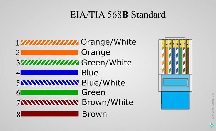

Yes. the sample hal file uses a 192.168.1.121 IP address:
loadrt hm2_eth board_ip="192.168.1.121" config=" num_encoders=6 num_pwmgens=6 num_stepgens=0 sserial_port_0=00xxxxxx"
The 7I84D is not recognized.
This may be because:
1. The Ethernet cable is not EIA 568B, so the color code is
not correct for the chart in the manual
(check the RJ45 end of the cable)
2. You don't have _both_ VFIELDA and VFIELDB connected to +8 to +24V
on the 7I84

my rj 45 plug looks like this

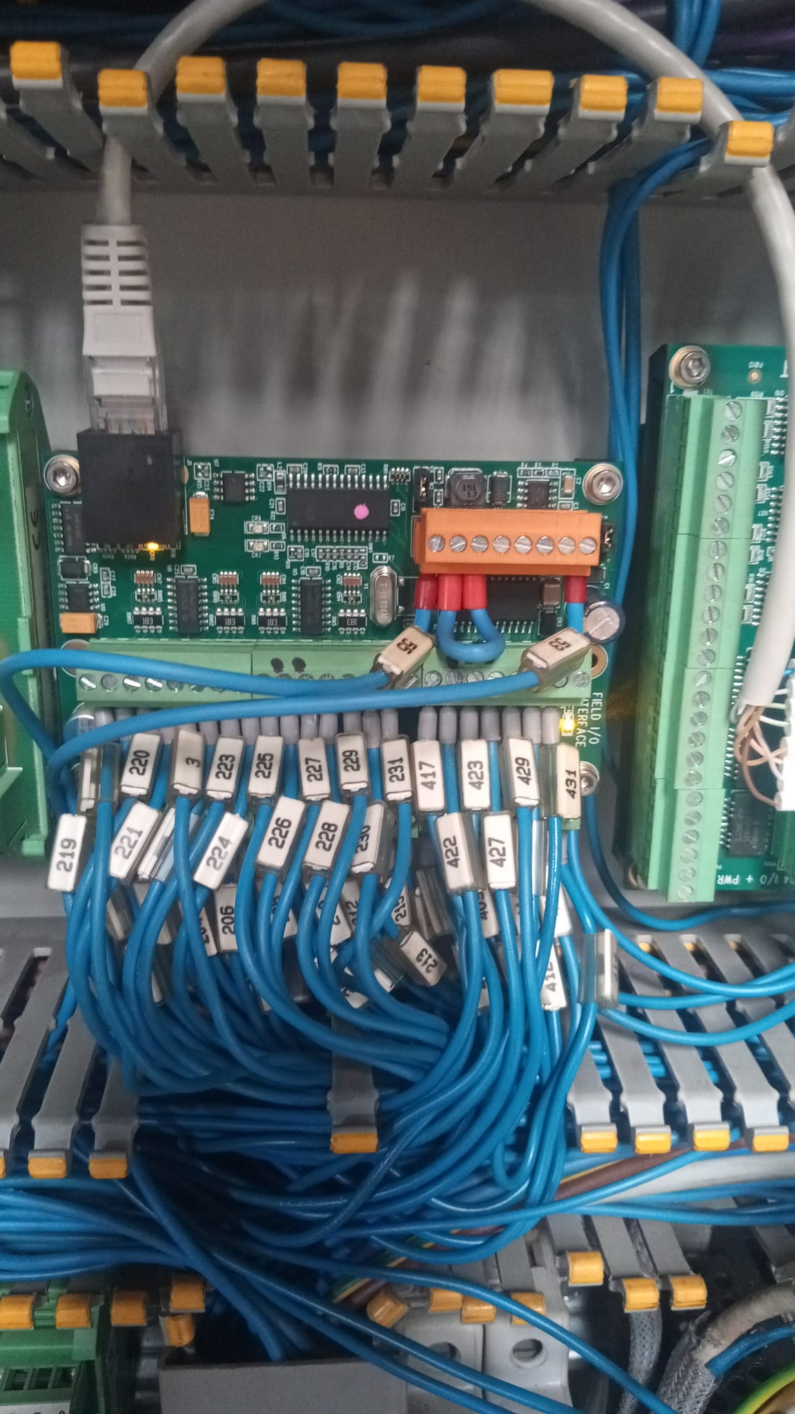

I have the 7i84 connected to 24V
on the left the calbe marked 55 is 24V an i jumpered it over so both field connectors get 24v
the cable marked 53 is ground. There are no relays or switches between the power supply and 7i84 as per the manual.

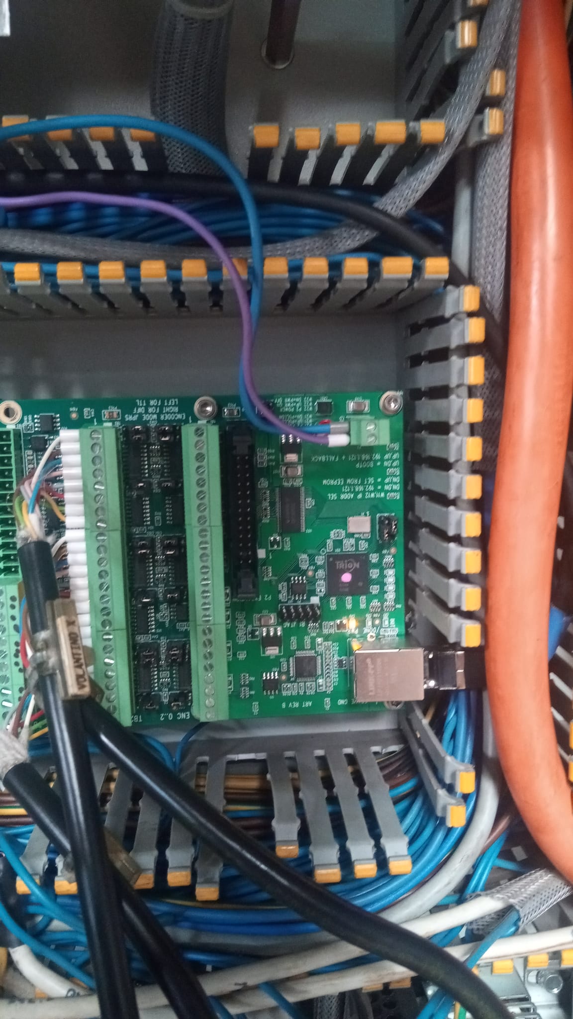

I have the 7i97 connected to 5V
The violet cable supplies 5V, the blue one is ground.
The 7i97 seems to work, as I am able to read the handwheel encoders I have connected.
After changing the ip to 10.10.10.10 LCNC starts with Peter's hal file, but the 7i84 still doesn't show up in halshow

11 Aug 2024 13:18 #307478
Replied by PCW on topic 7i97t with 7i84d connection problem
It looks like the 7I84D has failed somehow.
There is either an issue with the 3.3V supply
or the microcontroller, because neither the
red fault or green activity LED is illuminated.

Is that something I can check/fix myself or should I contact the retailer. The package arrived on friday and I am fairly certain I didn't damage it.

11 Aug 2024 17:02 - 11 Aug 2024 18:44 #307481
You could check if there is 3.3V power, and if not, maybe trace
backwards (3.3V comes from a switching supply that is supplied
by VFIELDB)
(Check across the larger electrolytic capacitor
C30 towards the bottom of the card between TB2 and TB3)
But if its not something obvious, the card should be returned
to the vendor for repair/replacement.
by VFIELDB)

I contacted the vendor and they advised me to order a replacement card and send the defective one back for review. They also informed me that all boards were tested before shipping and most defects are user error. Now, I only connected what is shown in the pictures for a quick test and the card was not working from the start.
Can someone confirm if I made any errors connecting it? (Not to prove anything to the vendor but to save me from scrapping another card)
- Posts: 18025
- Thank you received: 5295
12 Aug 2024 18:03 #307574
Looks OK, can you verify that you have +24V
on both VFIELDB pins?
