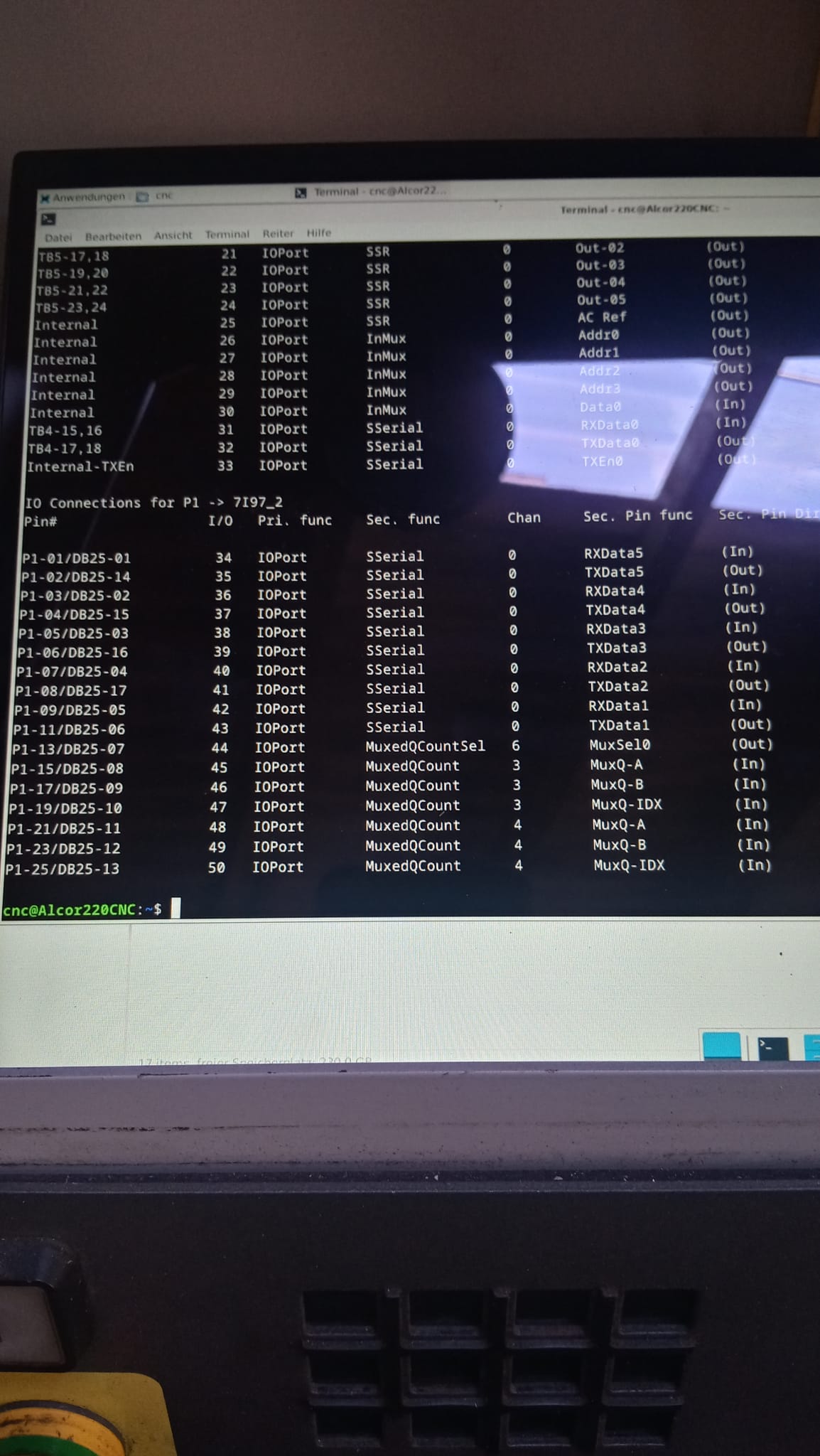

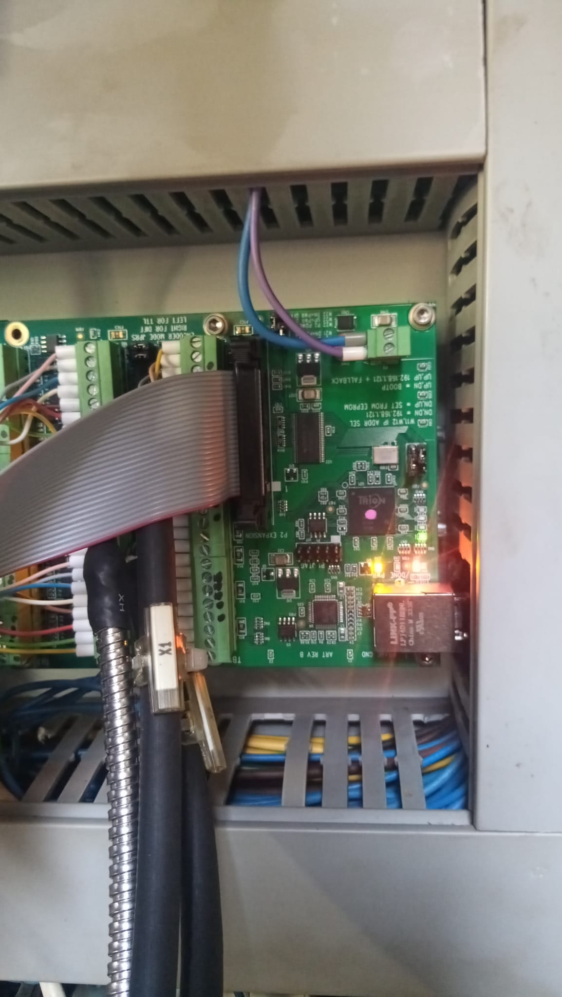

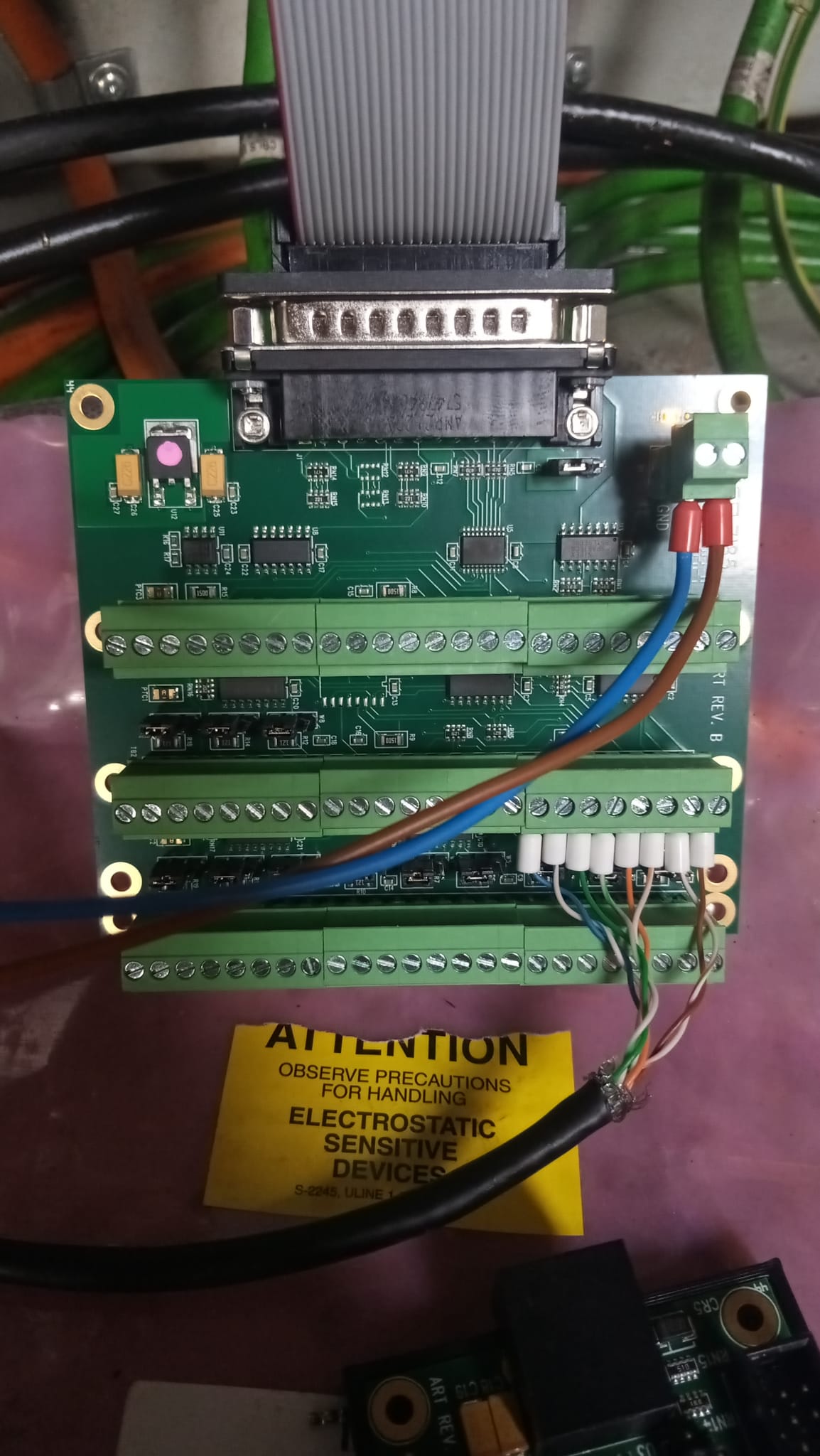

13 Sep 2024 13:55 - 13 Sep 2024 13:56 #310078
by Krulli_Fräser
Replied by Krulli_Fräser on topic 7i97t with 7i85?
Ok so my parts arrived and I connected everything.
p
However, the setup is not working currently. When I have the jumper on the 7i85 set to get 5v from the db25 cable it does not get power. Powering it from my 5v supply with the jumper correctly positioned it turns on and gives power through the cat5 cable to the 7i73 but no communication takes place.
This leads me to believe my bitfile on the 7i97t is wrong or not working properly.
Once again the smart serial port on the 7i97 itself works correctly and plugging the 7i73 into that shows it in the terminal using mesaflash so the problem is likely the pinout on the expansion port on the 7i97t?
Can someone help me out?
p

13 Sep 2024 14:07 #310081
Replied by PCW on topic 7i97t with 7i85?
To power the 7I85 from the 7I97T, you must also change
the 7I97T cable power jumper (W22 must be up)
Did you check if the sserial port is enabled in your hal file?
(you have the cable connected to what is sserial port 2
on the 7I85) so you need at least sserial_port_0=ABCxxxxx
where C is the mode for sserial channel 2

13 Sep 2024 14:57 #310088
by Krulli_Fräser
Thank you so much Peter you've done it again. Changed the line to sserial_port_0=000xxxxx and it works flawlessly. I also changed the number of encoders to 10 so i can use them on the 7i85. Now I just have a bunch of hal and classic ladder configuration ahead of me to wrap this retrofit up.
