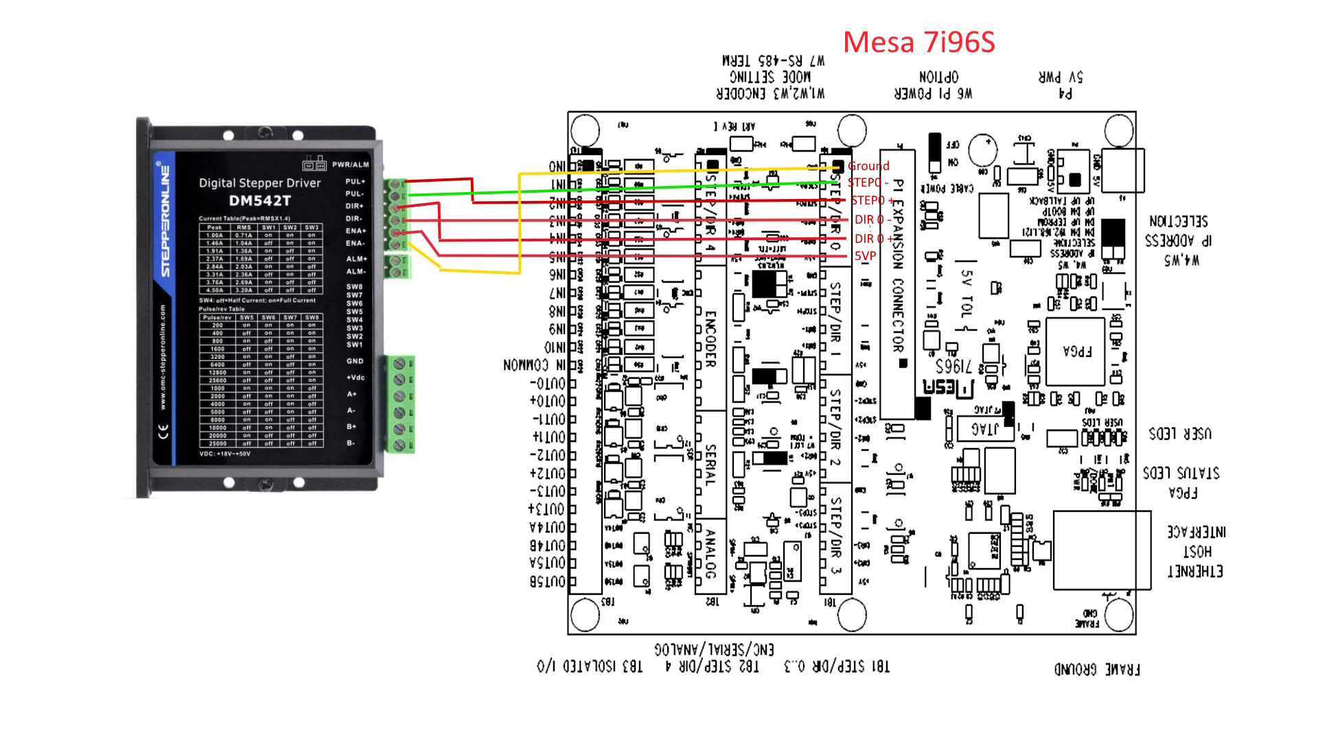

Connecting mesa 7i96s to DM542T

For a DM542, I would wire:
DRIVE 7I96S
STEP+ +5V
DIR+ +5V
STEP- STEP-
DIR- DIR-
ENA+ NC
ENA- NC
DRIVE 7I96S
STEP+ +5V
DIR+ +5V
STEP- STEP-
DIR- DIR-
ENA+ NC
ENA- NC

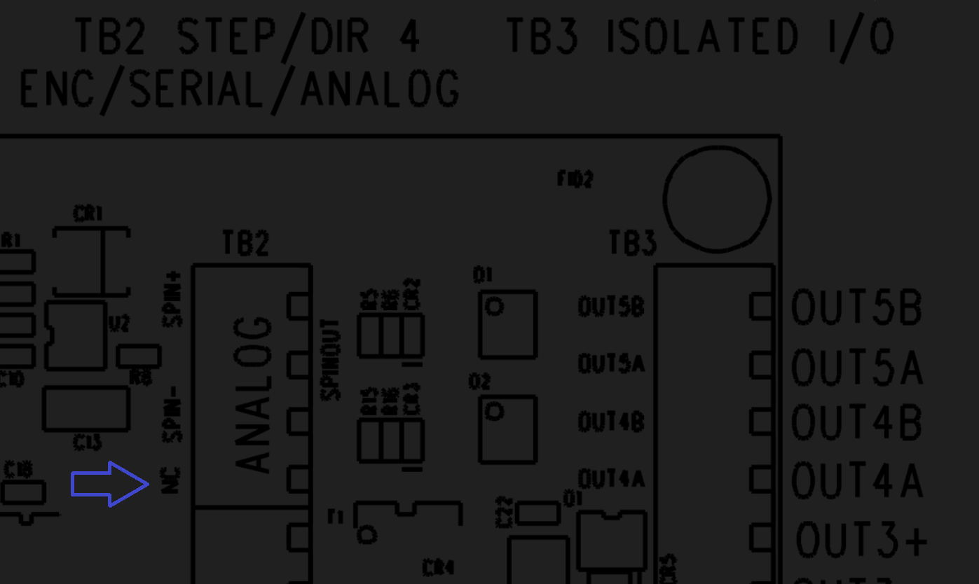

What is NC, please? I have looked through the layout, there is a NC mark in TB2 ANALOG:
This is for my own understanding, I am not using this driver. My driver is CL57T which also has Enable pin.
Thank you.
Thank you.

NC means no connection, so don't connect the ENA pins.
Also make sure that the CL57 is set for 5V inputs
