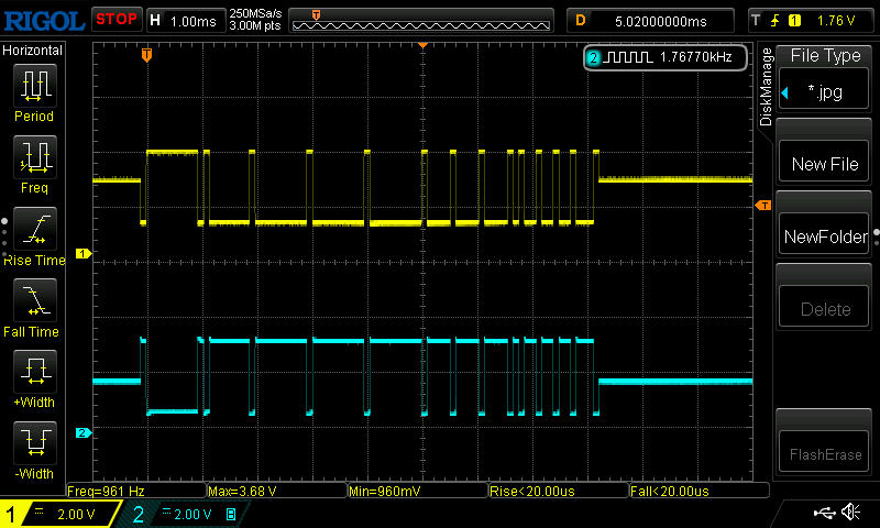

I'm trying to get a modbus connection to my VFD

after starting linuxcnc:
nothing on the bus
WAIT_FOR_DATA_FRAME - rxmode = 16200F8E
1002 TIMEOUT_RESET 3
START txstatus = 00001460 rxstatus = 16200F8E
WAIT_FOR_DATA_FRAME - rxstatus = 16200F8E
pls advice

at 100ms/div and a width of 1.5s even a short Xmit can be cought

That depends entirely on the oversample rate of the scope.
I would set the scope to say 500 usec/div and single sweep.

Ok--- reloaded 7i96sd_pktv2.bin unhooked everything except for power, ethernet, and the oszi.
Got what we expected !! a nice signal equivalent to what you got!!
wrote a .mod for the SKI780 VFD hooked it up and was able to control spindle direction and speed while reading the vfd's potentiometer.
Great Mission accomplished!
Big cheer for PCW!!
Then it stopped -- no contact no signal
back to trouble shooting.

To continue the story I ran as suggested by PCW
Replied by PCW on topic Mesa 7i96s pktUAT on P1 OK if all I/O are high on power up and low after the mesaflash commands,
that means All P1 I/O bits are functional. so it's not likely a hardware issue.
Maybe the next step is to verify that you can do a loopback through the P2
RS-485 port.
File Attachment:File Name: echo_2024-09-27.txt
File Size:1 KB
(you will need to "chmod +x echo.txt" to run it)
Will check if the 7I96S RS-485 hardware is OK
It requires a simple 6 pin loopback plug with TX+ connected to RX+ and TX- connected to RX-
When the plug is not inserted, the expected result is
0000EFFF
00002FFF
00006FFF
When the loopback plug is inserted (TB2 pins pin 15..20), the expected result is
0000EFFF
00000FFF
00006FFF
to retest the RS-485 hardware -- no difference between with loopback or with out it -->> so i presume the port is dead and decided to go for analog speed-control and direction pins and get the not so critical data with an USB to rs-485 adapter using the MB2HAL component.
