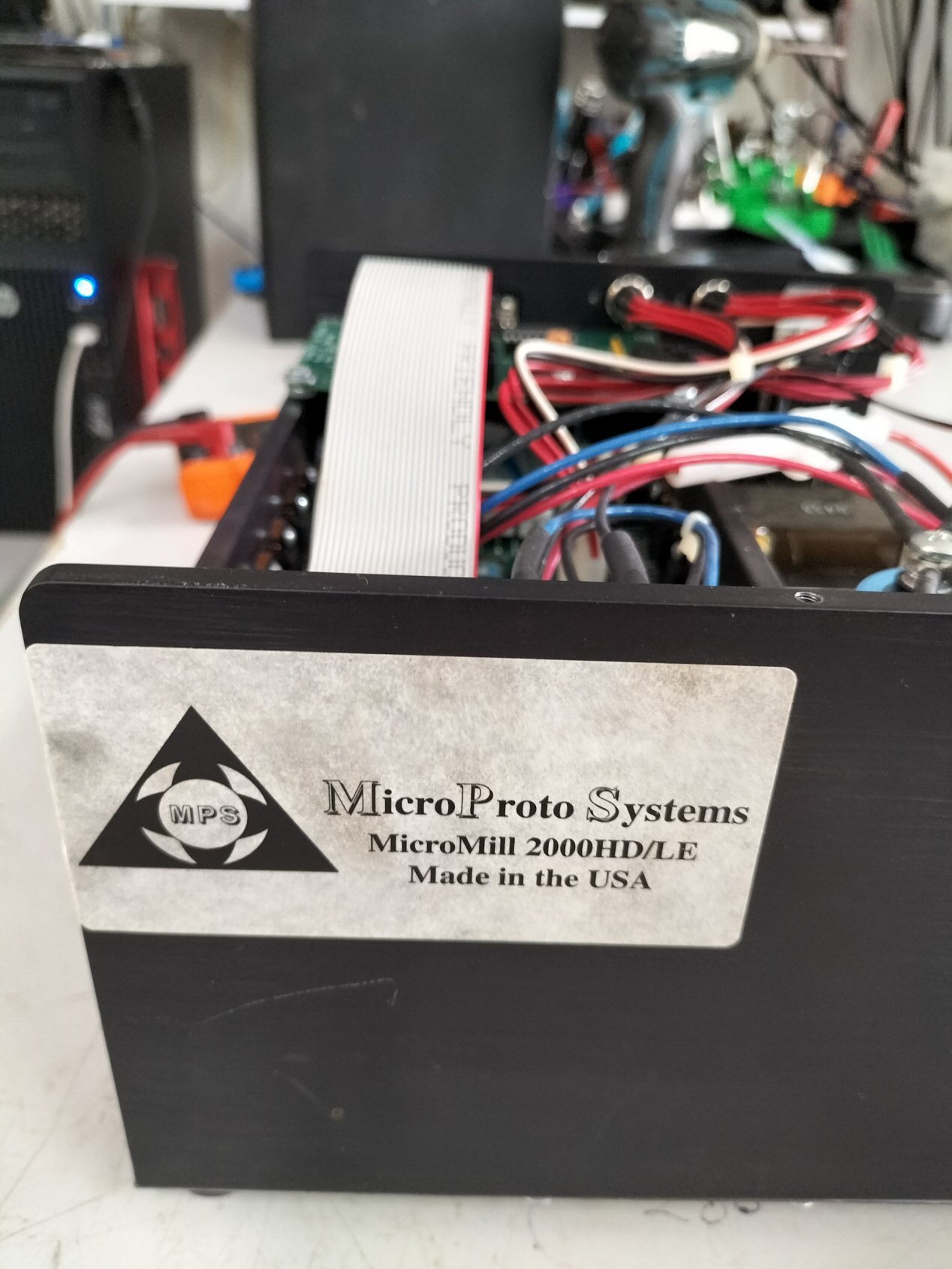

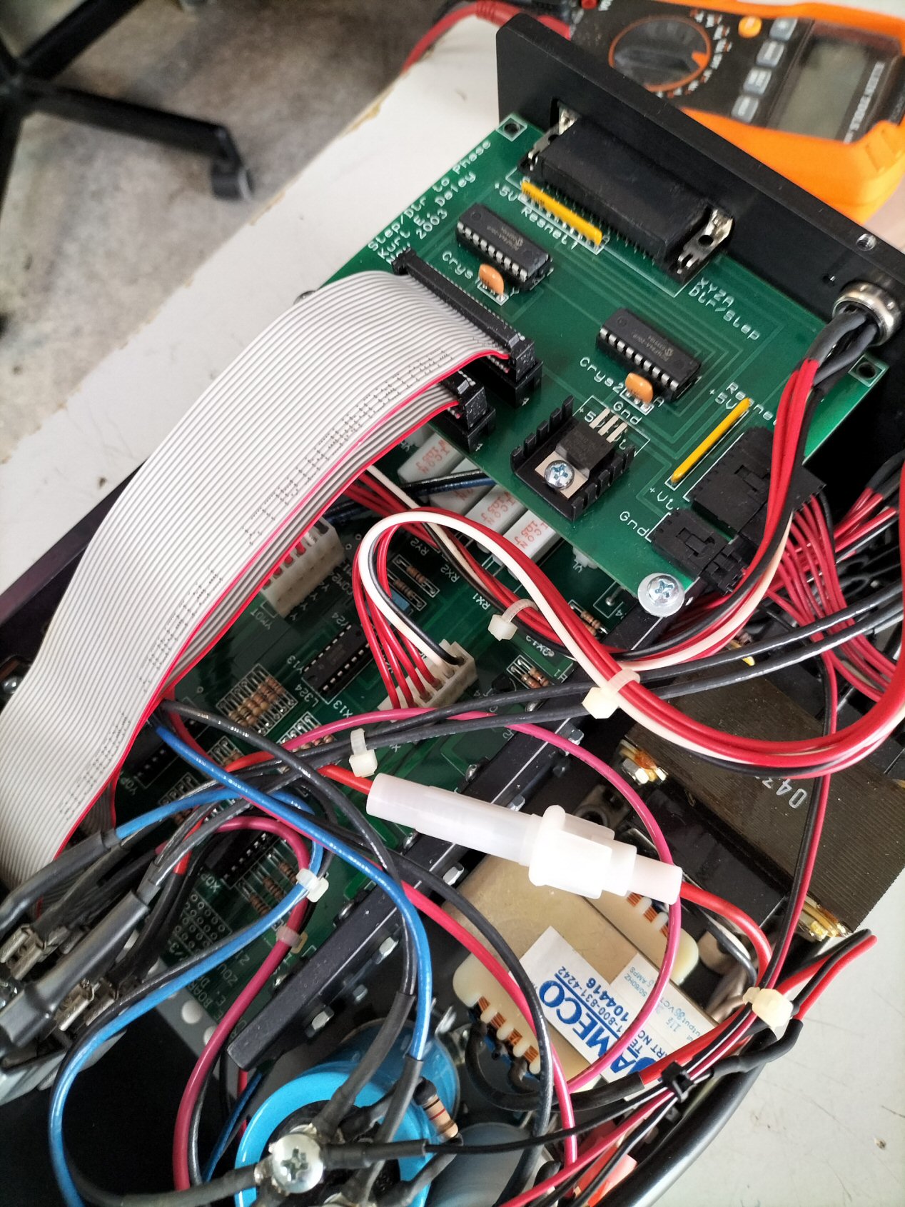

I have the original MPS Micro Mill2000HD/LE and I am still using the original Driver setup. All has been working well till this morning I turn the machine on and not Zaxis.
I swapped the Z motor to the Yaxis driver and it moved fine so I would assume I have a dead driver?
Just to be sure... as I had just finished setting up a Manual Tool Change with Tool Length Touch Off ... so I went back to the HDD with the working install and setup... just in case I did screw up a setting in Linuxcnc. It was the same.
I pulled the box out and removed the cover but there is not obvious burn or smell or issue I can see on the board.
So can I..? and how would I go about using the Aaxis Driver to run the Zaxis..?
That's of course if it will work as it's on the same board but I'd like to try swapping them, while I workout what driver setup I should upgrade to.

Looks like a parallel port setup, so use the StepConf wizard to make a new config and just change Z axis pins to pin 8 and 9, save, run.
Or you can edit the existing hal file and set the Z axis to pins 8 and 9.

Thanks but I fixed it... I noticed the socket pins loose when I plugged the Zplug in with the lid off... so I just swapped the sockets around and using the Aaxis socket plugged into the Z driver and it works again. So I have to assume it was just the connection.
