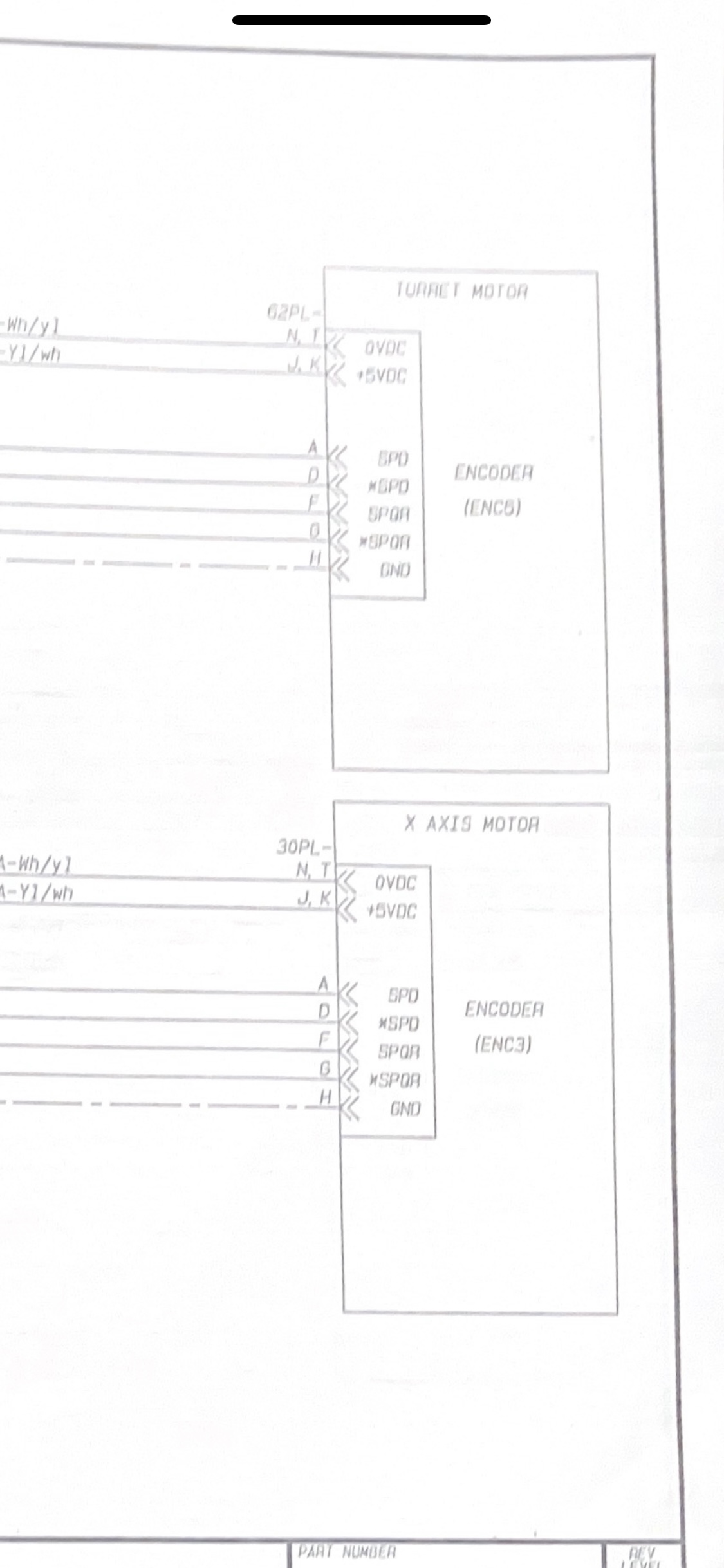

Hello,
I am working with an early 90s (installed 1992) Hardinge Conquest Model CS-51. I have installed Allen-bradley Ultra3000 drives for the Fanuc red-cap servos (10s, 10s, 5s, 20s models). Today in testing I realized that the encoders are "PULSE CODER SERIAL C" type. Specifics: PART NUMBER: A290-0561-V571, (A860-0350-T011) on two of the motors, I haven't popped the cap off on the others.
Currently I have wired in a MESA 7i76e to control this machine, what would be the most cost effective way to read these encoders? I would really like to not have to replace the encoders.
I also have a MESA 7i97 available if that makes it easier, and the Ultra3000s can take analog input or step/dir so either card would work in this setup - it just depends if either can directly interpret the serial encoder information... My research is falling short, maybe someone can point me in the right direction.

Hostmot2 has support for the older RS-422 (4 wire = req/data) Fanuc pulsecoders
Can you find the pinout of your encoders?

Yes, it’s 4 wire - here’s a section of the schematic that labels the wires:
Labels read: SPD, *SPD, SPQR, *SPQR.
Earlier today I plugged those four wires on the live tool motor into the encoder input on the ultra3000 drive with 4.7k pull-ups to 5v thinking it was an incremental pulse coder… I’m hoping that didn’t cause damage

OK that's probably supported.
When I get a chance I can make firmware for a 7I76E with one Fanuc
channel on the serial expansion port for testing. I seems that that's a 1M
CPR encoder.
