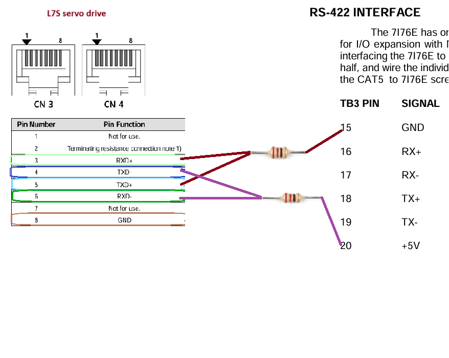

Hello everyone,
I am new to using LinuxCNC and the Mesa 7i76e.After connecting the Mesa 7i76e and the L7S servo drive using Modbus-RTU, I followed the connection setup as mentioned in this link:
forum.linuxcnc.org/27-driver-boards/3328...6e-with-uart?start=0
I also used the following bitfile:
freeby.mesanet.com/7i76e_7i76x1_PktD.bit
and I flashed it using Mesaflash.Next, I attempted to communicate with the L7S servo drive using the Mesa card and LinuxCNC. I connected the servo drive to the Mesa card and then connected it to a computer via Ethernet.I followed the codes provided at the bottom of this link:
linuxcnc.org/docs/stable/html/drivers/me...us.html#_quick_start
However, I modified the configuration from 7i96s to 7i76e. I calculated the CRC from google and tried sending an inertia code from terminal . my code like this :

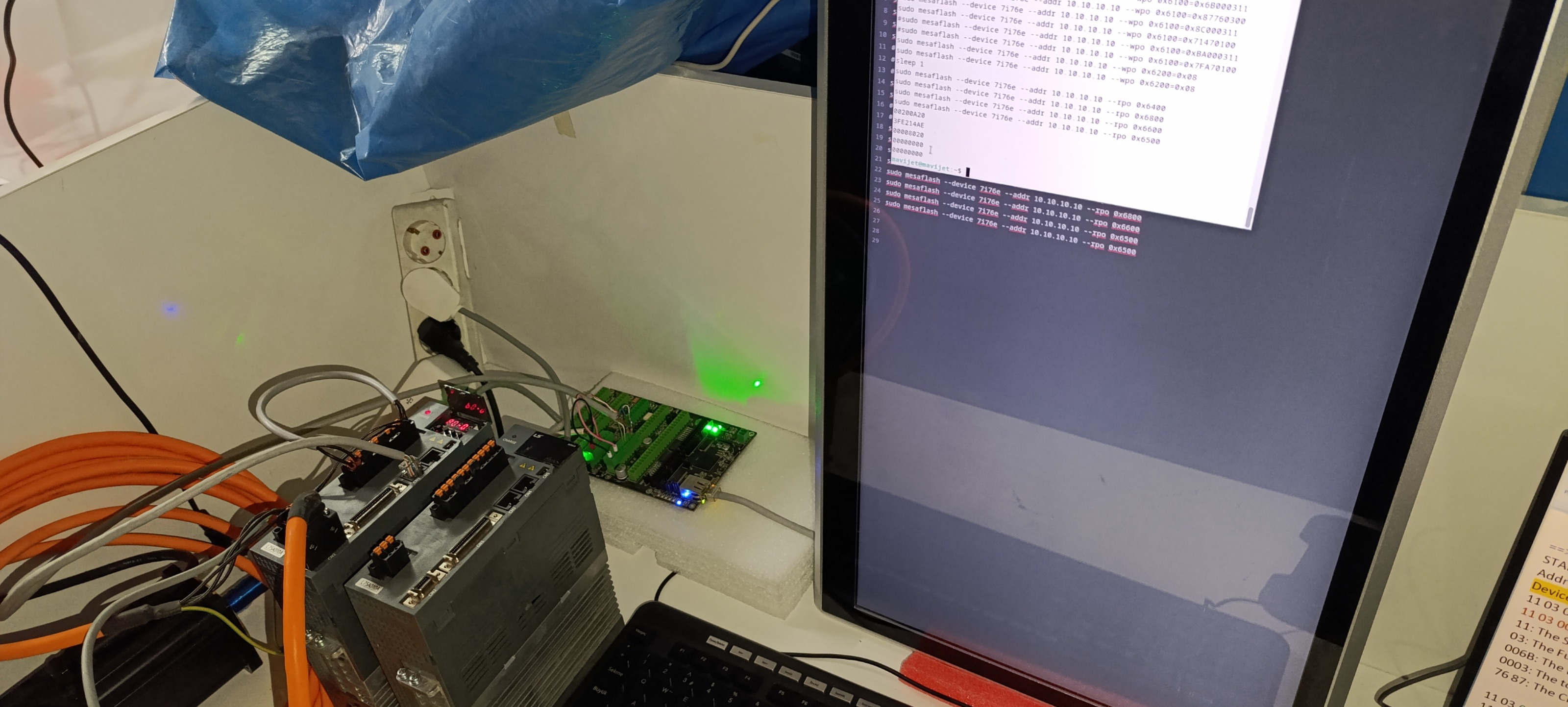

During testing, I noticed that when I send values, the L7S servo drive responds with unintelligible numbers or data that I cannot interpret.
Could the issue be in the transmission process I followed, or is it a hardware connection problem? For example, do I need a converter from RS-422 to RS-485?I would appreciate any help. Thank you!

I would try setting up the mesa-modbus component
The 7I76E has an RS-485 interface but does require bias
resistors and the proper connections to work properly:
7I76E
RX- TX- --> A (220 pullup to +5V)
RX+ TX+ --> B (220 pulldown to GND)
Later cards like the 7I96S Rev E and 7I76EU do no required the pullups/pulldowns
7I76E

Note sure, the drive shows a full duplex connection
Is it full or half duplex?

The drive is using RS-422, and I think it operates in Full Duplex (bidirectional) mode.

OK then its just
RX <-- TX
TX --> RX
Though polarity may be either way
Mesa uses the EIA-RS-422/423 standard
where RX+ and TX+ are the inverted data
(for compatibility with RS-423/RS-232)
RX <-- TX
TX --> RX
