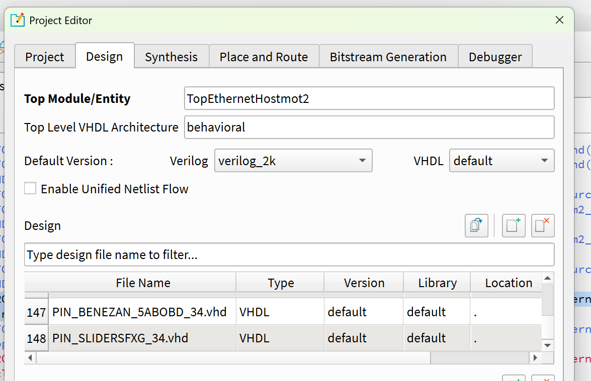

13 Dec 2024 12:23 - 13 Dec 2024 12:24 #316572
by StoneB
Replied by StoneB on topic Xilinx Setup to edit config for 7i92T
I think I made all the modifications needed (and included my PIN_Slidersfx file in the TopEthernet16HostMot2_efx).
When I now try to synthesize, I get the error "pin_slidersfxg_34 not compiled in library 'gui_analyze'. Should I call my file in another file too?
Thanks!
Thanks!

- Posts: 18111
- Thank you received: 5330
13 Dec 2024 15:40 #316582
Replied by PCW on topic Xilinx Setup to edit config for 7i92T
Did you add your new pin file to the project?
- StoneB
- Posts: 17
13 Dec 2024 17:10 #316597
by StoneB
I did - it appears in the design - that's how it should be, right?
The error that stops Synthesis is:ERROR : ***\7i92t\configs\hostmot2\source\7i92t-hm2\TopEthernet16HostMot2_efx.vhd(135): 'pin_slidersfxg_34' is not compiled in library 'efxlib' [VHDL-1240]
Here are my two edited files:
You have the old (G540) package name in your pinout file
