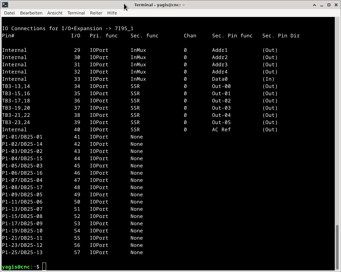

Hello,
for my CNC-Mill i use a Mesa 7i95T card. For extension i bought a 7i74 Interface card and a 7i87 (analog input) + 7i83I (analog servo interface). The Firmware of the 7i95T is 7i95t_d.bin. In this Firmware the P1 Port has only IO Ports (attachment).
On the Mesa Website -> 7I95T -> Software was no Firmware for use with 7i74.
Is there a firmware available for the 7i95T with a 7i74 as a P1 Daughter Card?

Replied by PCW on topic 7i95T with 7i74 Interface and 7i87 + 7i83
7I95T firmware for 7I95T and a 7I74 on P1
(note 7I95T sserial channels are port-0 and 7I74 channels are port-1)

Replied by KMA on topic 7i95T with 7i74 Interface and 7i87 + 7i83
Thank you from the bottom of my heart. You are my hero.
